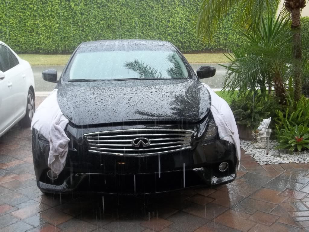

Installation was a success. Rain interrupted us when the intakes were off, hence, we had to take a time out. I must admit the sound is awesome and there is noticeble power gains between reves at 2k and 5k. Check out my garage for pics...Special thanks to my good friend Elias, he is a modding freak and did the installation for me....

It's good to have freaks as friends. LOL! Install looks great. Glad you are enjoying the ride and happy with your G purchase.
The r2c's are a geode fit for your car. Simple, easy and notable gains. I'm just glad this thread didn't turn into another r2c versus gen3 debate.
Nice pics and good post! Congrats!

looks great manyard!... question... does the intake on the driver's side sit a little lower than the one on the passenger side? I installed mine last week and that is how mine are sitting... just want to know whether or not this is normal
It looks in your pictures to be sitting a little lower, just not sure if that is the angle or not

Almost ever SRI has this tendency. You can get the passenger side to sit lower, just keep the bracket loose, hold the heat shield down while you tighten the mounts on the side and then sinch up the ring clamp. Having the L bracket face down will let you adjust it lower then having them face up, if you have them facing up you may want to swtich sides. You want to watch that you don't let either get too high, perferably in line with the hood gasket. If you mount them too high you will end up puncturing the hood head liner.

Good observation, it does sit a bit lower. Radiator hoses on the passenger side are the culprit.
