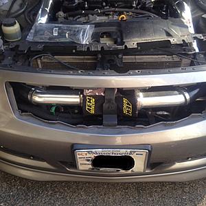

Stock grill will flow more than enough air for the takeda's, just make sure you mod them t the two filter style and lose the one big can filter
Why switch from the one filter too the two filter? Any reason?

There is no beneficial gain from removing the grill, The oem grill is more than capable enough to feed it. The side effect that will come from an open grill and straight filters is damage from incoming debris. You'll also find yourself having to clean your MAFs more often due to microscopic dust and vapor hitting it more than if it had a grill.
Due to the pull from both intakes it can essentially tug from the other as they get dirtier.
