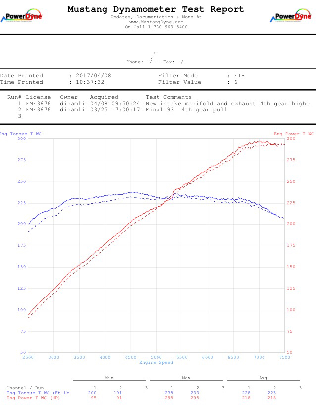

You're right. Just got back from my retune after I installed my Z1 ported stock plenum and Motordyne catback (not that it matters). Only picked up a few ponies. Motordyne M370 bust-photo758.jpg

At least it appears you gain across almost the entire rpm band. Does the motordyne catback have larger piping than the ark you originally dynoed with?

Yea I'm happy i got gains. The Motordyne plenum wasn't doing anything for me. The ark runs 2.5" all the way. The Motordyne catback runs 2.5" to 3" from the cat to the tail.
