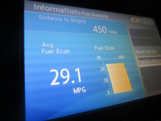

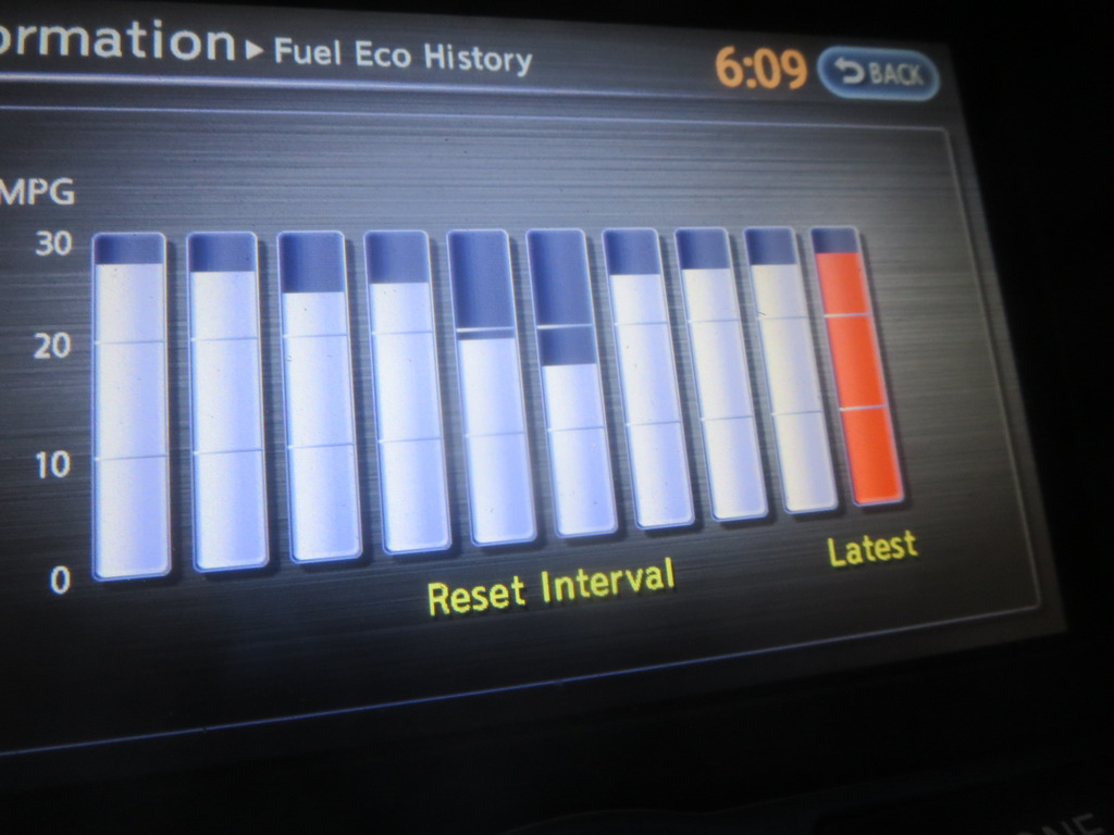

Originally Posted by Marionan
Hey guys,
Ive been having this problem on and off for a year now, with certain fixes working temporarily. When i step on the accelerator pedal (from 2k-3k rpm) theres always a slight hesitation, like the car is struggling to get moving. Then once it hits around 3k it accelerates like normal. Ive cleaned the throttle bodies, so i know its not that. Is it possible that the spark plugs need to be replaced/cleaned? The car is at 80k miles and has been running rich since about 50k miles when i got the intake (theres always soot on the rear bumper). Or is it just the summer heat/humidity here in South Florida that limits the amount of air? Thanks!
My G37S runs the best at 70* with low humidity
Recent round trip from NJ to Florida a few weeks ago
The poor MPG while in Florida is clearly shown.
Four fill-ups on the trip down, poor MPG while in Florida, and four fill-ups on the return trip
Telcoman
