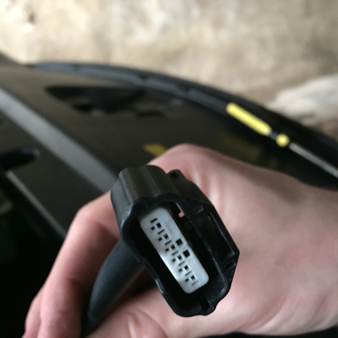

Hey guys so I'm trying to clean my mass airflow sensors and can't seem to locate them. Any suggestions? I've looked it up and can't seem to find pics. I have stillen gen 3 intake btw. This is all I could find and I'm pretty sure they aren't them. Thanks

Yup, those are the mass air flow sensors.
Really? So should I just give them a soak with the MAF cleaner?

DO NOT touch the filament. Spray it from both sides with CRC MAF cleaner. Let them air dry completely. Put them back in. Done.
Already done. Thanks guys
