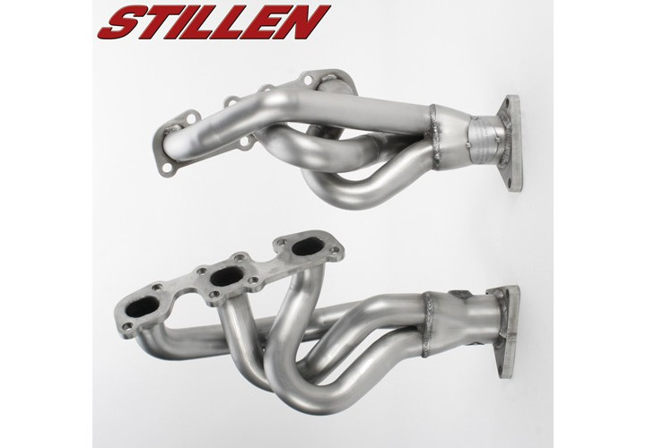

Who has installed Headers on an AWD sedan? Which headers did you use and did you have to cut part of the motor mount bracket in order to get them to fit. AMNVQ recently had a bad install experience (Momentum headers) and I'm scheduled to have my Stillen headers installed next wednesday. I wanted to get as many peoples experiences as possible before I proceed. Only AWD G's please as apparently the motor mount on the driver side on the AWD models is the issue.

The issue with mine was the the front tube went down first then sideways, if it went sideways first then down I would have fit( Just what I was told by the tech).

Maybe the Stillen headers tubing is directed differently? Hopefully we get some responses.

The top one in each picture should be the driver side. See how the fron tube on the Stillen headers doesn't dip first. It looks like it goes straight across. Maybe that will allow it to miss the mount. Is that where the Z1's were hitting and why Mike?

Yea the Stillen will definitely miss the mount!
mine The first pic are the ones I bought from MY350Z

Sweet, well I'm moving forward with it. I will report back results in detail. fingers crossed.

Who knew. Completely different routing of the front most primary.

Stillen headers installed today, they fit with no modification. Install was a bitch. check out my build thread for more details.

Shop. it's a major PITA. Really need a lift cause you have to remove the steering rack.
