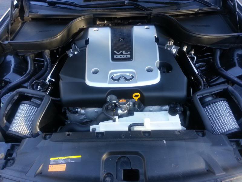

I can't speak for the Gen 3, but the R2C is a good intake. No matter what you read R2C is not a true cold air intake. R2C is more of a short ram intake, whereas the Gen 3 is a true cold air intake. You should get more gains from the Gen 3 over the R2C, but you have to shell out more money for the Gen 3 than the R2C, and it may only be a couple of hp difference, if any until you get a tune. With my R2C I noticed a loss at higher RPM, but noticed a little more from the lower and mid range torque.
I'll be selling my R2C in the next few weeks for a Takeda CAI if you are interested. I just have to get the Takeda powder coated before I install it then my R2C will be fore sale.
