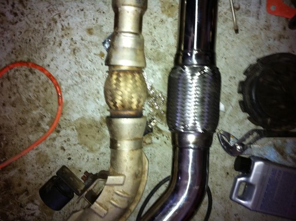

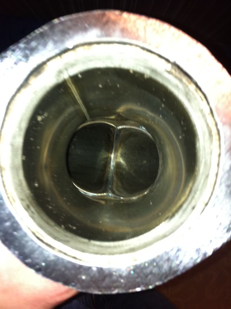

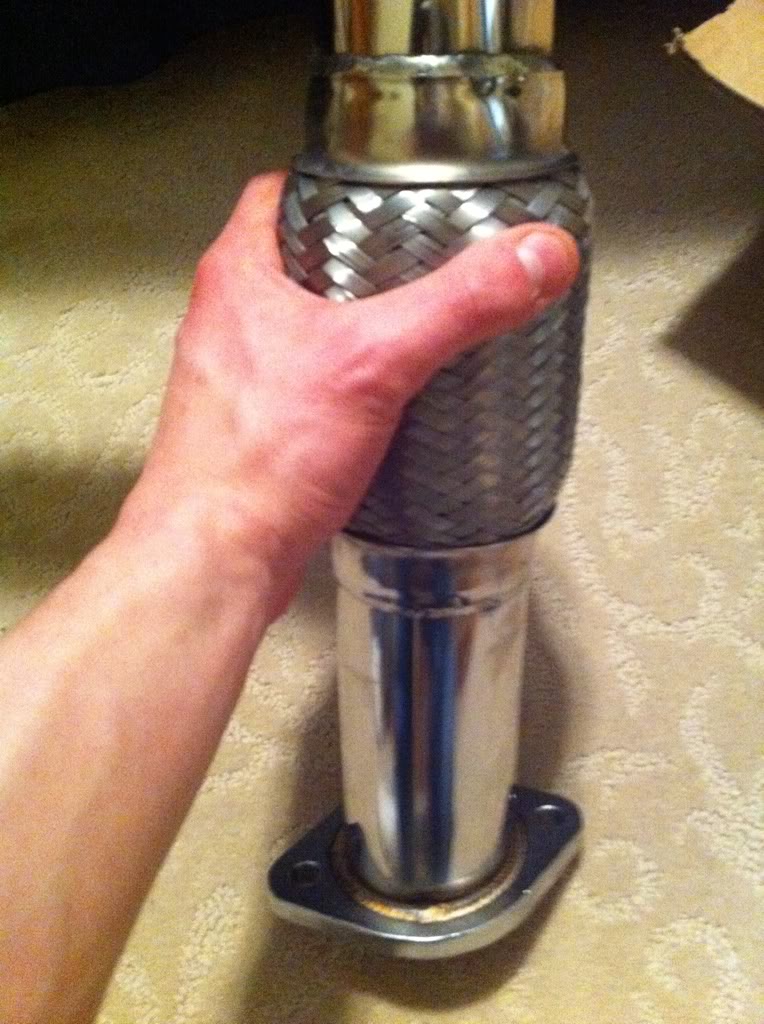

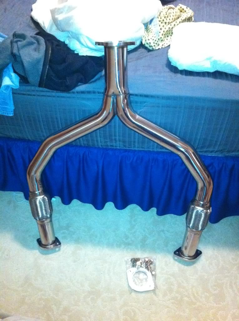

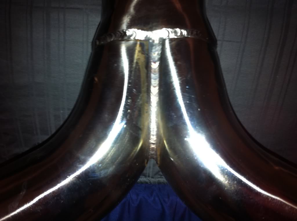

Got this for 60 bucks off ebay. (+55 dollars cuz of UPS to canada >.<, but still cheaper than any alternative). I have a g37x so im gonna see if it fits tonight, if not ill get it altered. Everything seems quality, flex joints seem totally solid and welds are too bad. For 60 bucks i dont see how you could go wrong, all we have to do is see how it weathers the elements. I will attempt to instal it tonight
OKAY! for all you guys with an x coupe, im happy to say it fits!!!!!! no problem, no hassle, fits great! but do you wanna know why this gem costs only 60$? not because its cheaply made, not because it doesnt fit, not because its made of paper... the bolts they give you are the worst bolts i have touched in my entire life.
Ill post a pic a bit later, but when i was tightening them, the bolts would "pop" when they got to tight, so i looked and the thread became crushed and the bolt became useless...
Luckily i have my berk test pipes which came will hardware to use, i used jack stands and ramps and was unable to tighten the bolts as tight as they should be, so its rattling a bit on cold start, going to my cousins on the weekend to fix it since he has like 1 foot jack stands.

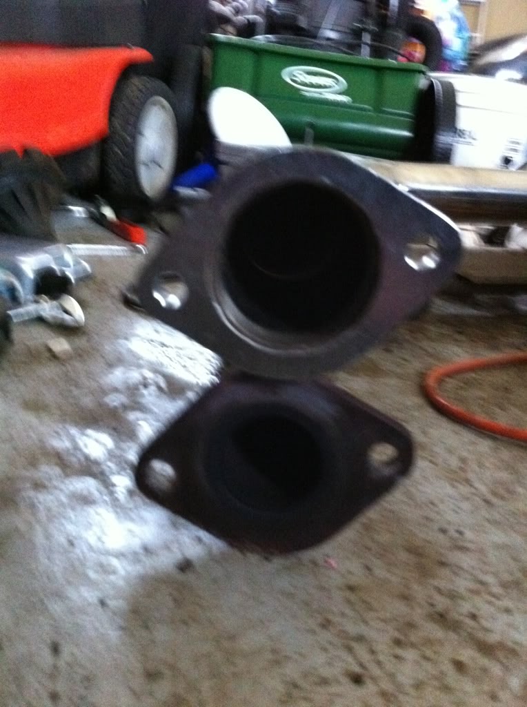

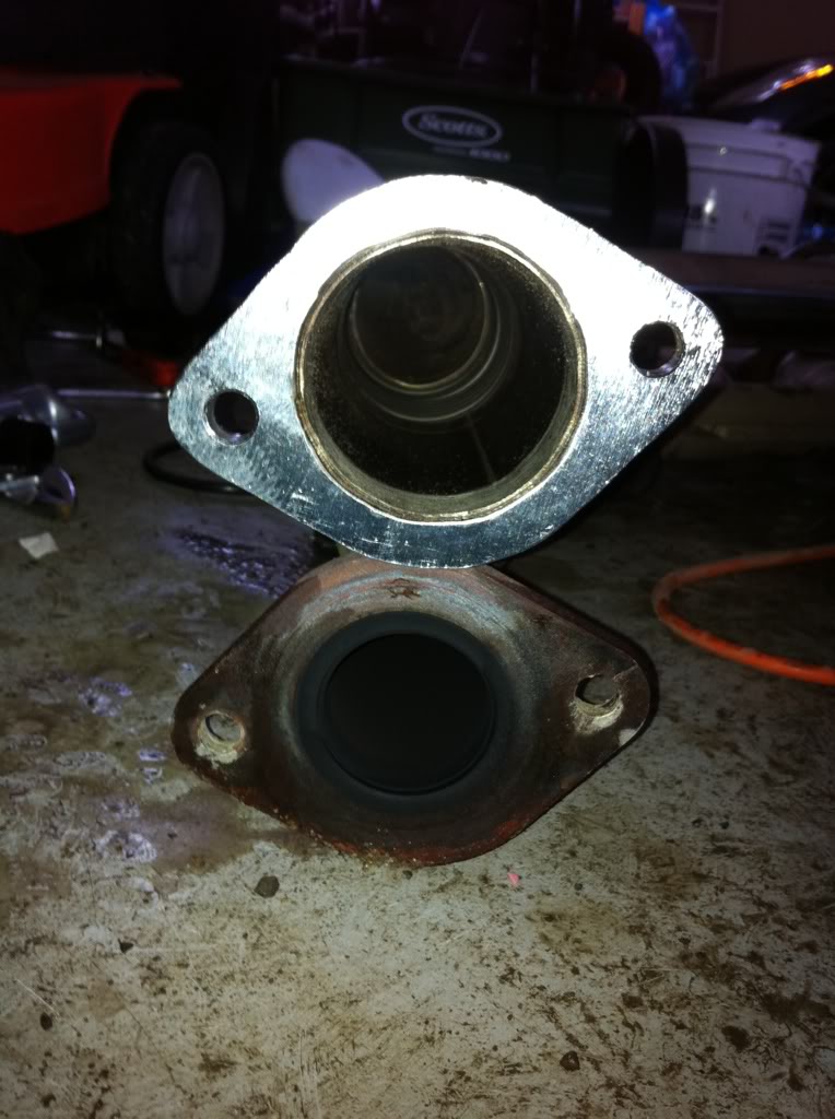

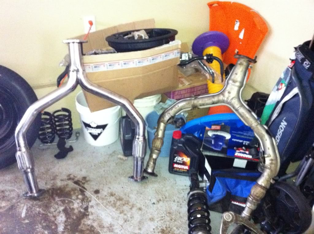

here are some comparison pics:

How much bigger is the diameter of the M2 vs stock?
Old Mar 23, 2011 | 06:07 PM
Steveo47's Avatar
Steveo47
Joined: Jan 2010
Posts: 1,804
From: Edmonton, Alberta
haha yeah those are mine, they have elephants on them. they stock is 1.75 inch, this is 2.5 - > 3 inch.

Do you think you can measure out the y-pipe. i wanna know if this would this be able to fit the coupe without modification.
Old Mar 23, 2011 | 09:38 PM
ANMVQ's Avatar
ANMVQ
Joined: Dec 2009
Posts: 6,098
Likes: 396
From: Framingham Ma,
I believe its for the coupe, Coupe and sedan are the same, I think,only diff is the X model. In yet??? Come on Steve

Steve nice work man gives me hope that my H pipe will fit with no issues nad NO modding, Nice work and write up!!! Now we need a vid clip of the tone change if any..
Old Mar 24, 2011 | 10:04 AM
fairladyz34's Avatar
fairladyz34
Joined: Oct 2010
Posts: 1,360
From: Central NJ
I bought the M2 350z ypipe and it fit my coupe perfectly. It was 60bucks to my door. Win.
Old Mar 24, 2011 | 02:01 PM
ANMVQ's Avatar
ANMVQ
Joined: Dec 2009
Posts: 6,098
Likes: 396
you have a X coupe also? we all know the Y pipes on the X's and RWD are different.. But Steve has a X coupe like me and the Y pipe he bought fit fine. Now if my Exotic Exhaust H pipe follows suit I'll be pumped. DOMO
Old Mar 24, 2011 | 04:31 PM
Steveo47's Avatar
Steveo47
Joined: Jan 2010
Posts: 1,804
The transfer case isnt a's big a's we all think
