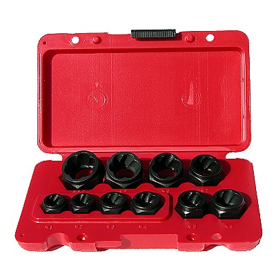

If the heads are rounded off, you'll need something like this to grip them:
Craftsman | America's Most Trusted Tool Brand | Top-Selling Lawn & Garden Brand | Garage & Storage
PB Blaster works better than WD40 in my experience. Let it soak for hours, preferably overnight. Grip it with a breaker bar and go to town. If that won't get it, you may need an impact fun. Take it to a muffler ship and pay them just to break the bolts free and and the rest yourself.
