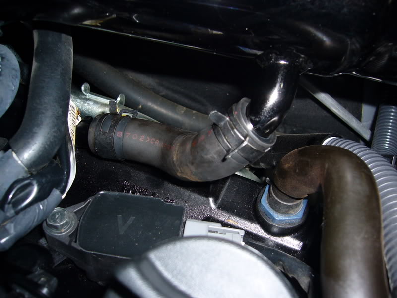

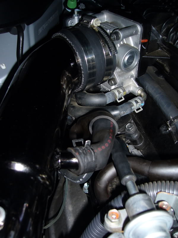

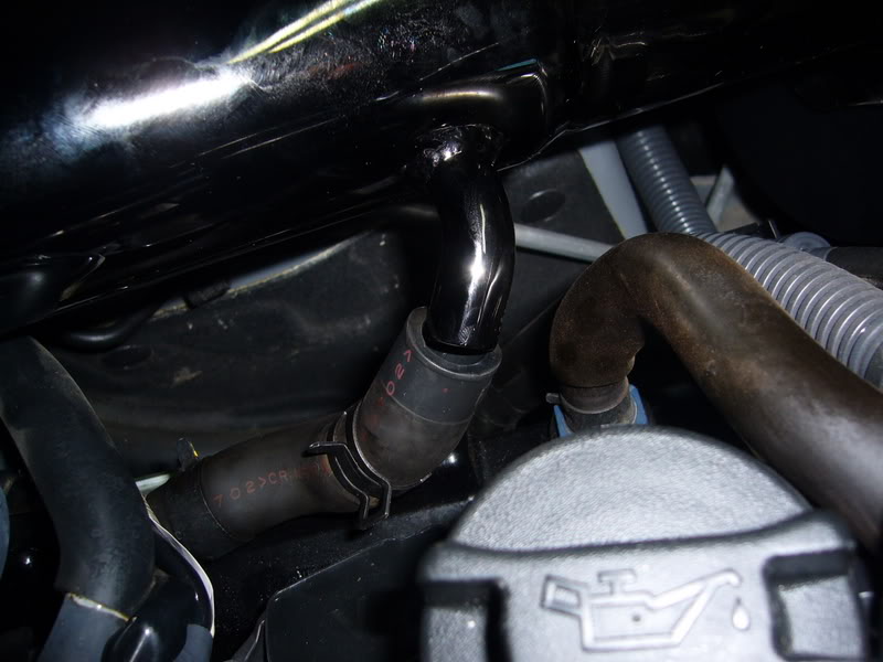

OK, the next problem I had was the crank case hose on the passenger side intake (the small hose that fits on to the main intake tube halfway down) as you can see in the pics the only way to get these on was to bend the hell out of the hose and it just didn't fit well. Another forum member mentioned he re routed the crankcase hose and I did the same. It fit much better once the hose is re routed. Ed from R2C is going to include this step in the instructions from now on.
Pics of crankcase hose before re routing

Pics of crankcase hose after re routing
After the hose was re routed the rest of the passenger side install was easy with no problems.

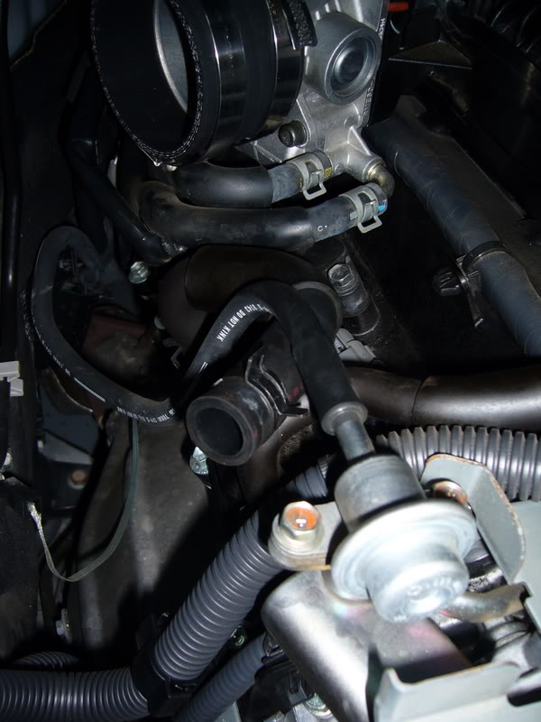

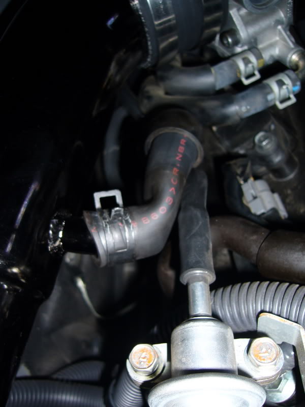

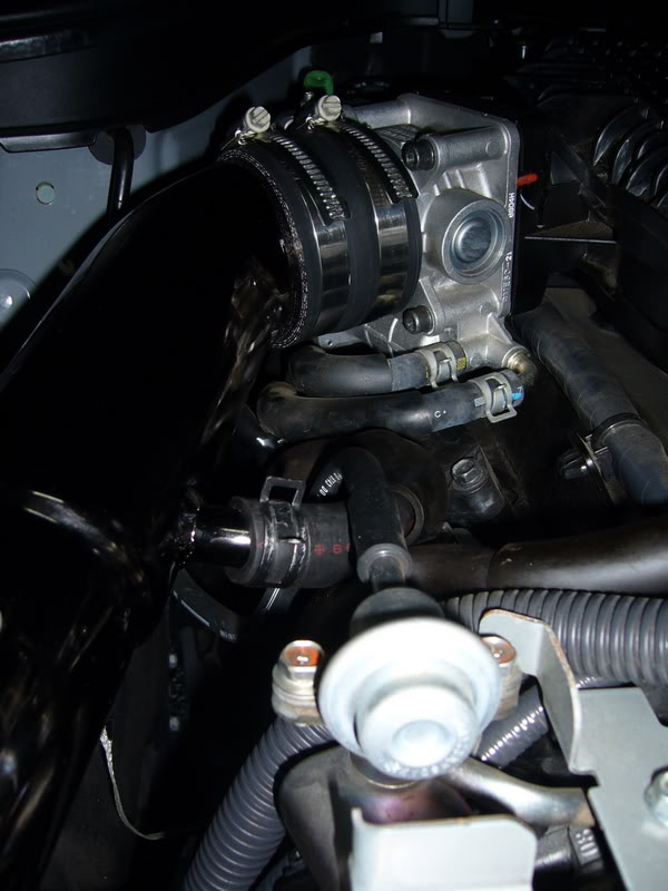

Next Problem I had on the drivers side is that the crankcase hose was just an inch or two too short to fit on the intake tube. I loosened the hose up from the engine and pulled it off/back and inch or two and this fixed the problem. See pics below
Pic before adjustment
Pic after adjustment

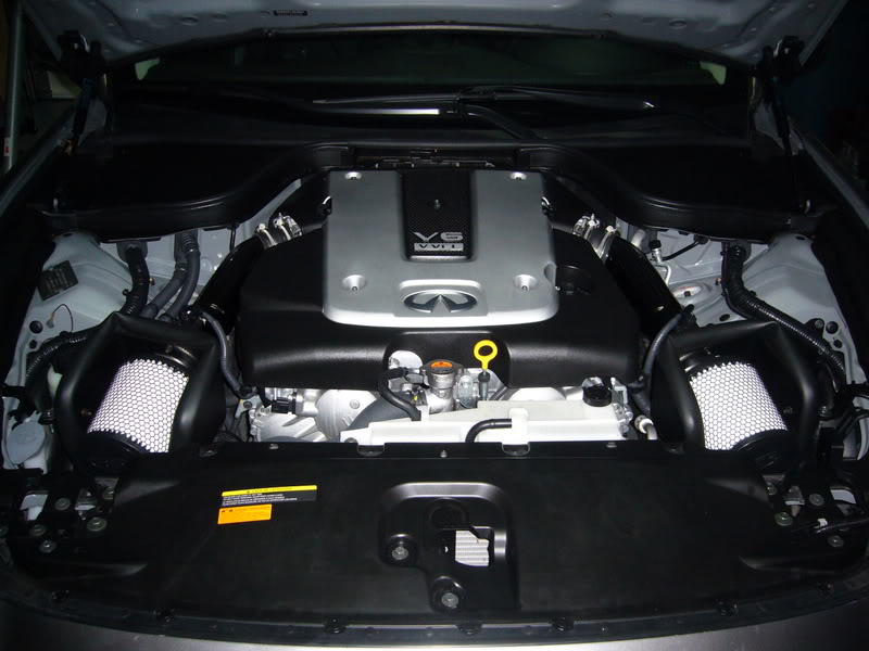

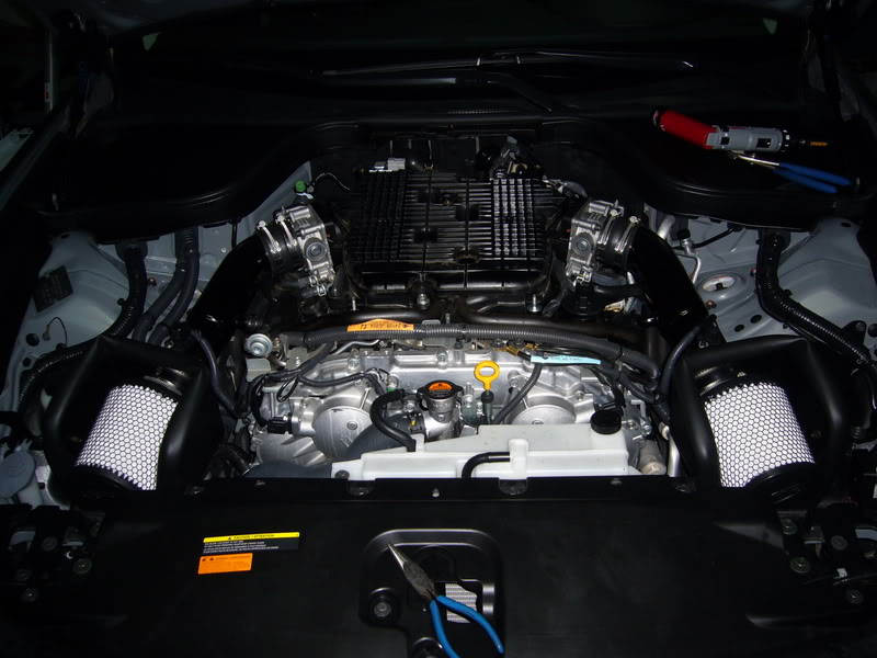

Finally the finished install

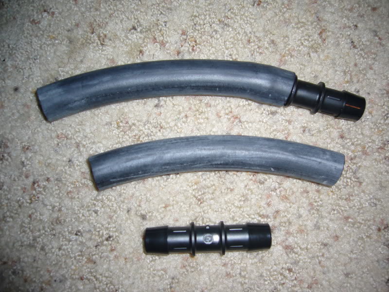

One thing I wold like to mention is that Ed from R2C was extrememly helpful through out the process. He even sent me extension hoses and maf screws. I ended up not needing them, but his customer service is top notch. He is also very interested in improving the intakes in anyway he can. He is going to make the inlet tubes on the main intake tubes a bit longer to make installation easier and nogood said he is talking to the paint people about fixing the MAF thread issue. Bottom line if you have any problems with the intake contact R2C and they will make it right.
Pic of ext hoses Ed sent me

I had the same exact problem with the hoses. I PM'd the vender (Kyle, I believe), he gave me R2C's number. I called and spoke to someone there, very nice. He told me he was going to send me a length of the correct diameter hose to replace the OEM hoses. I was happy. The package arrived quickly. But, when I opened it there was not a long length of hose for me to replace the existing hoses with, instead there were 2 pieces similar to what you have at the top of the you have in your last picture except the attached hoses are WAY shorter. I didn't even bother using them. I'm probably gonna call them back and see what's up or just go to an autoparts store myself and buy a length of the right type of hose. I also with the nipple positions were a bit better for clearance but I do like the intakes. Black Chrome you have looks very nice. I went with the Black Powder Coated. I noticed that the intakes are not loud though. Unless, the sound is hidden by the roar of the Berk Test Pipes and MXP exhaust.

The passenger side is easily fixed re routing the hose. On the drivers side I think there is something inside of the hose,not sure what it is but I would make sure you find out before replacing the hose completely.
