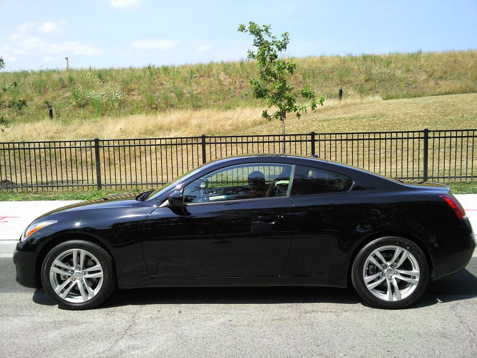

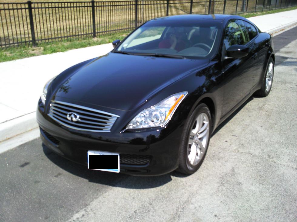

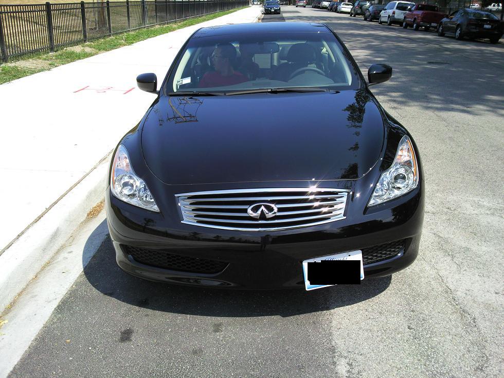

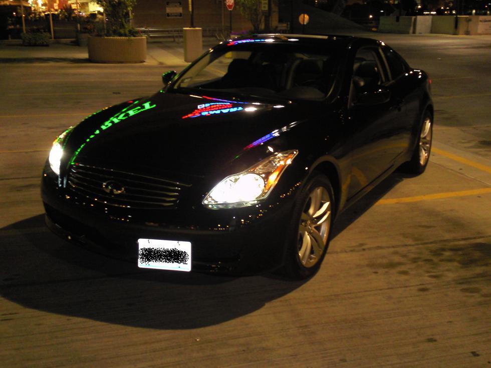

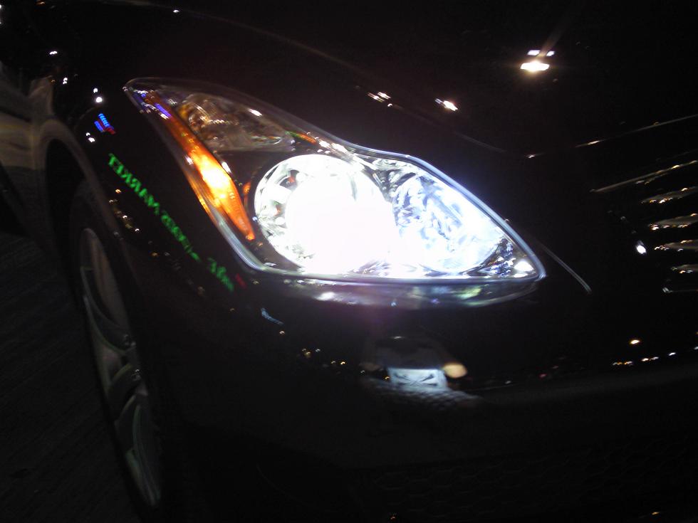

oh and I also have some more pictures that I took by the park. Enjoy!
