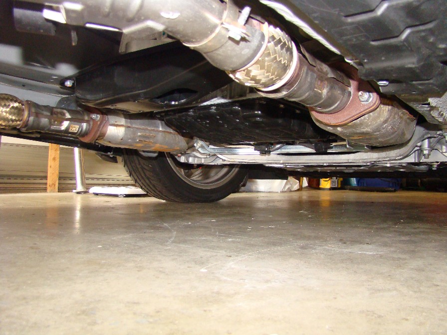

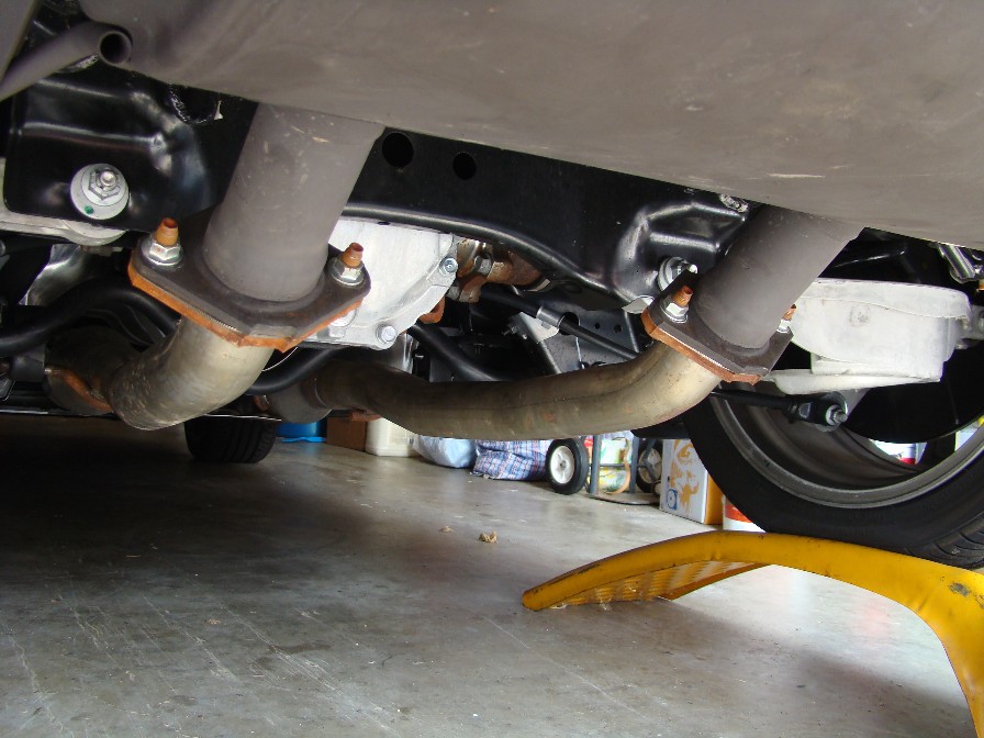

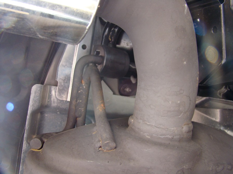

First the removal of the stock exhaust:
  • Remove four 14mm nuts from y-pipe to catalytic converter.
  • Push aside rubber hangers from resonator mounts.
  • Remove four 14mm nuts from muffler to resonator.
  • Remove four 12mm bolts from cross brace under car. Remove brace.
  • Lower and remove resonator assembly.
  • Remove rubber hanger from lower side of muffler, driver's side, with 12mm wrench.
  • Push aside two top rubber hangers while supporting muffler. Lower muffler.
Attached Thumbnails Stillen Exhaust Install and Review-stock1.jpg   Stillen Exhaust Install and Review-stock2.jpg   Stillen Exhaust Install and Review-stock3.jpg

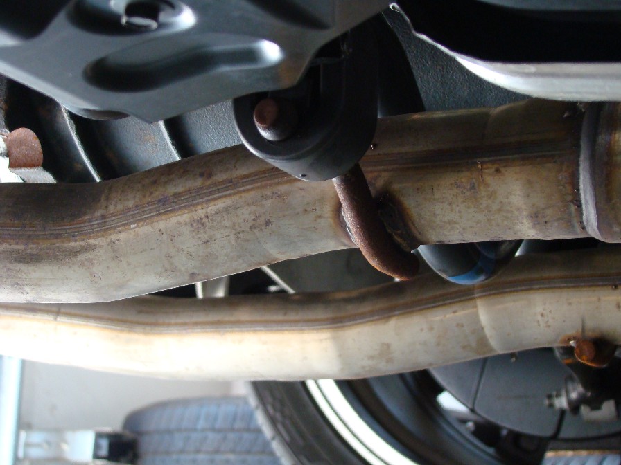

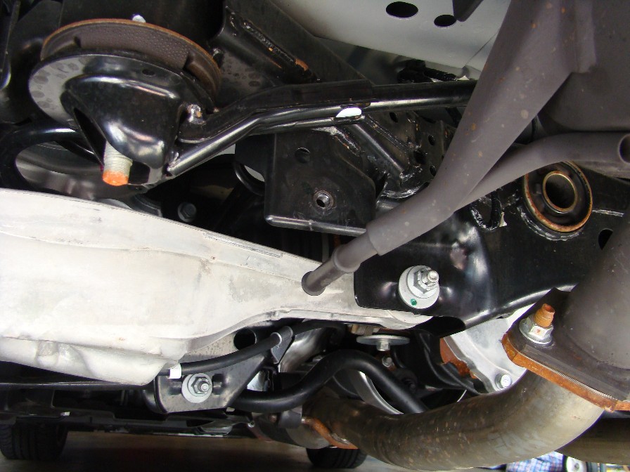

More pics of the stock system:
Attached Thumbnails Stillen Exhaust Install and Review-stock4.jpg   Stillen Exhaust Install and Review-stock5.jpg   Stillen Exhaust Install and Review-stock6.jpg

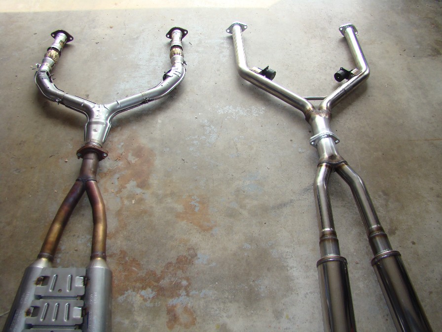

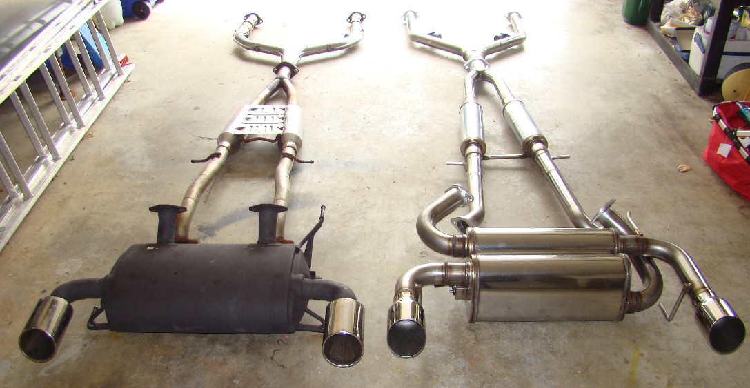

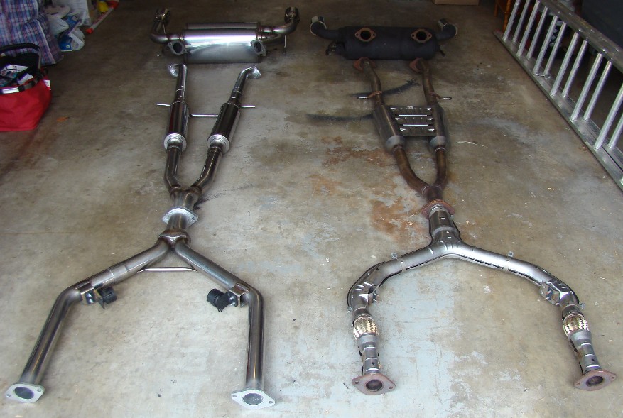

Stock versus Stillen exhaust:
Attached Thumbnails Stillen Exhaust Install and Review-stockvsstillen1.jpg   Stillen Exhaust Install and Review-stockvsstillen2.jpg   Stillen Exhaust Install and Review-stockvsstillen3.jpg

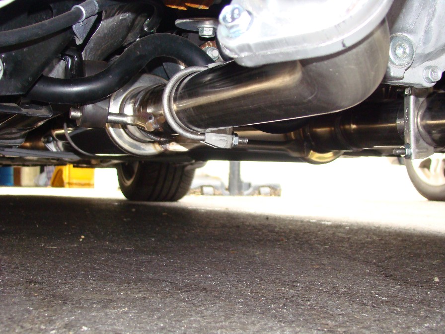

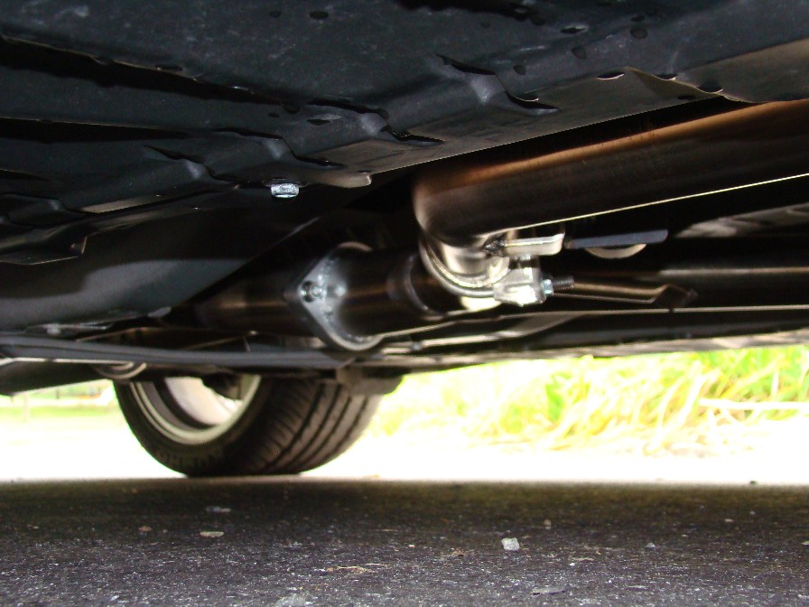

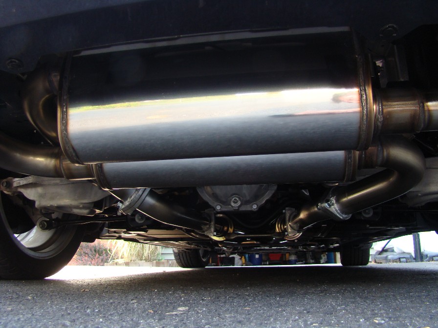

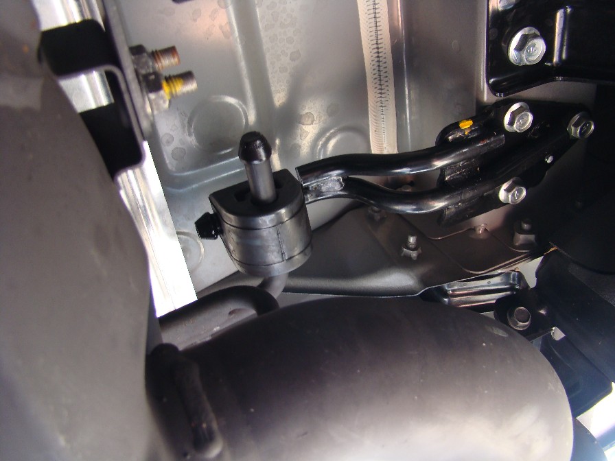

Installation procedure:
  • Remove the vibration mounts from stock system. Six 12mm nuts.
  • Transfer the three vibration mounts to the Stillen with stock hardware.
  • Slide U-bolt clamp onto y-pipe passenger side arm. Slide arm onto y-pipe but don't tighten.
  • Mount Stillen y-pipe to catalytic converters with stock gasket and the four 14mm nuts. Don't tighten.
  • Place rubber hangers onto resonator assembly mounts. Mounting arms will be towards the ground, not the chassis to get proper clearance.
  • Use Stillen supplied gasket and two 9/16" bolts and two 9/16" nuts to secure resonator to y-pipe. Don't tighten.
  • Hang Stillen muffler with all three stock rubber hangers.
  • Slide U-bolt clamps onto extension arms. Slide arms onto resonator assembly. Note: One is longer than the other.
  • Use Stillen supplied gaskets and four 9/16" bolts and four 9/16" nuts to secure muffler to resonator. Don't tighten.
  • Tighten all nuts and bolts starting at the catalytic converter and working back. Note: U-bolt clamps are 1/2" nuts.
You're done!
Attached Thumbnails Stillen Exhaust Install and Review-stillen7.jpg   Stillen Exhaust Install and Review-stillen9.jpg   Stillen Exhaust Install and Review-stillen8.jpg

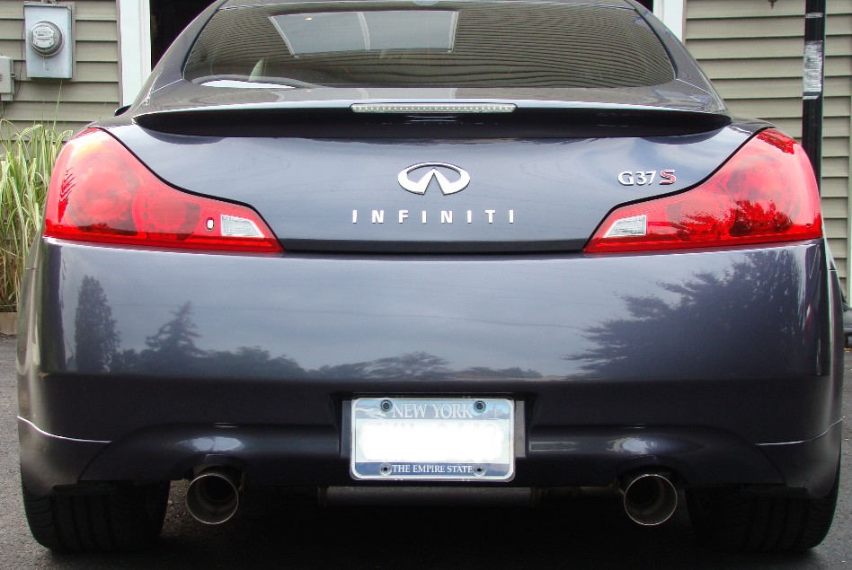

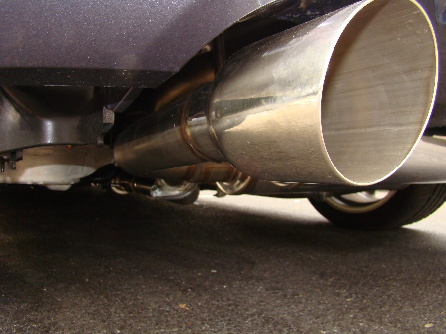

A few more pics and I'll try to get a dyno done in the next week or two. Initial impressions are that the system is very well put together and is quiet. It's just a hair throatier than stock throughout the rpm range until you get towards the top. Then it has a really nice tone, but agian just a throatier version of stock. It's probably three times quieter than the Magnaflow in my opinion. Oh, and here are the stock exhaust weights:
Stock Muffler: 27.20#
Stock Other: 49.50#
Stock Total: 76.70#
Stillen Muffler: 29.70#
Stillen Other: 32.70#
Stillen Total: 62.40#
Total weight savings of 14.3#
Attached Thumbnails Stillen Exhaust Install and Review-stillen11.jpg   Stillen Exhaust Install and Review-stillen12.jpg
