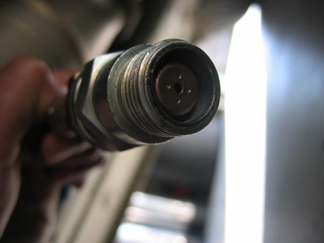

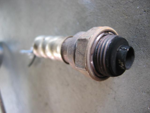

here are pics of what the fix looks like. the first two pics show my o2 sensor destroyed from the tp, second shows the new sensor.

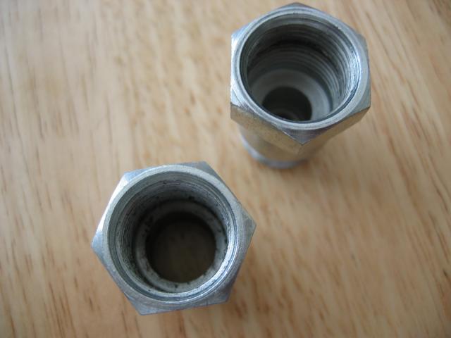

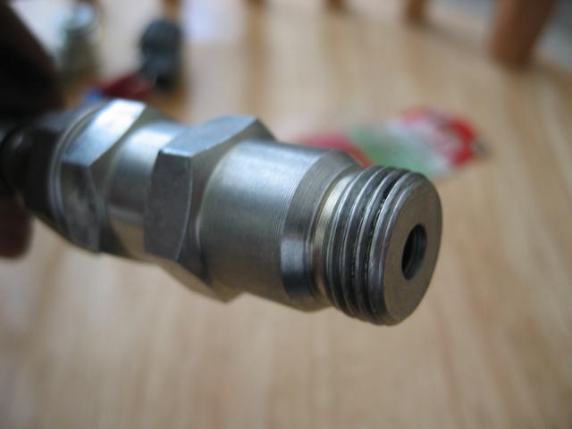

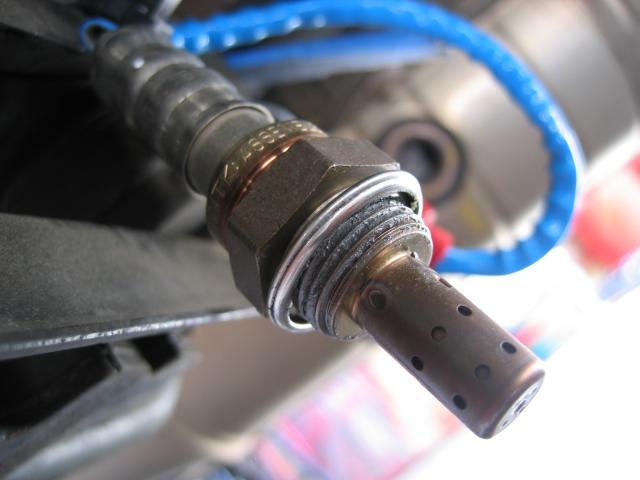

here is the fix for the cel.... first pic is the two plug adapters. the one on the left bottom is the one that is drilled out. the other is normal
Second pic shows the drilled adapter screwed on and how it hides the 02 sensor from the excess gases because of no cat.
Third pic shows both adapters installed both the drilled first and the non drilled second.
Fourth pic is the o2 screwed back into the TP.

Its a very simple fix. the idea is the secondary o2 sensor reads the gases coming from the cats. when it senses that it is reading too much of some gas i.e. because there is no more cats with tp it throws the cel. The bug places the o2 sensor not only farther away from the gases flowing through but also reduces the amount of gases it can sense which in turn makes the ecu think everything is running normal and fine. so no cel. works everytime...
