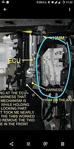

Yeah a real big mess I have and I'm about to start working on it next weekend. Pretty much going to do the engine room and main harness, in the pics I attached, the circled socket, housing the connections from the ECU has been cut off and joined together by electrical tape to other wires so I just technically need this part back on the existing harness to be able to re-socket the connections from the engine room

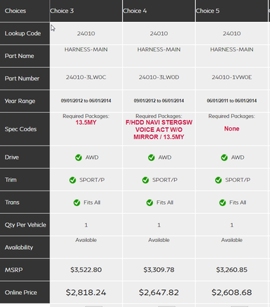

Yeah I rather do it the right way but spending about 2k on a harness is going to suck since I have yet to find the exact part number noted for my car. Idk what's up with the Infiniti website but I can't search for parts on there anymore for the g37 sedan.
From this pic I had a while back, It shows Choice 3 being able to fit so I'm just gonna pray that it does since that's what I found on eBay for 89 bucks

I didn't buy .the exact harness that came out from mine, I actually was never able to find the label on it. But I bought one of the harnesses that were supported based on the picture I uploaded in the previous post.

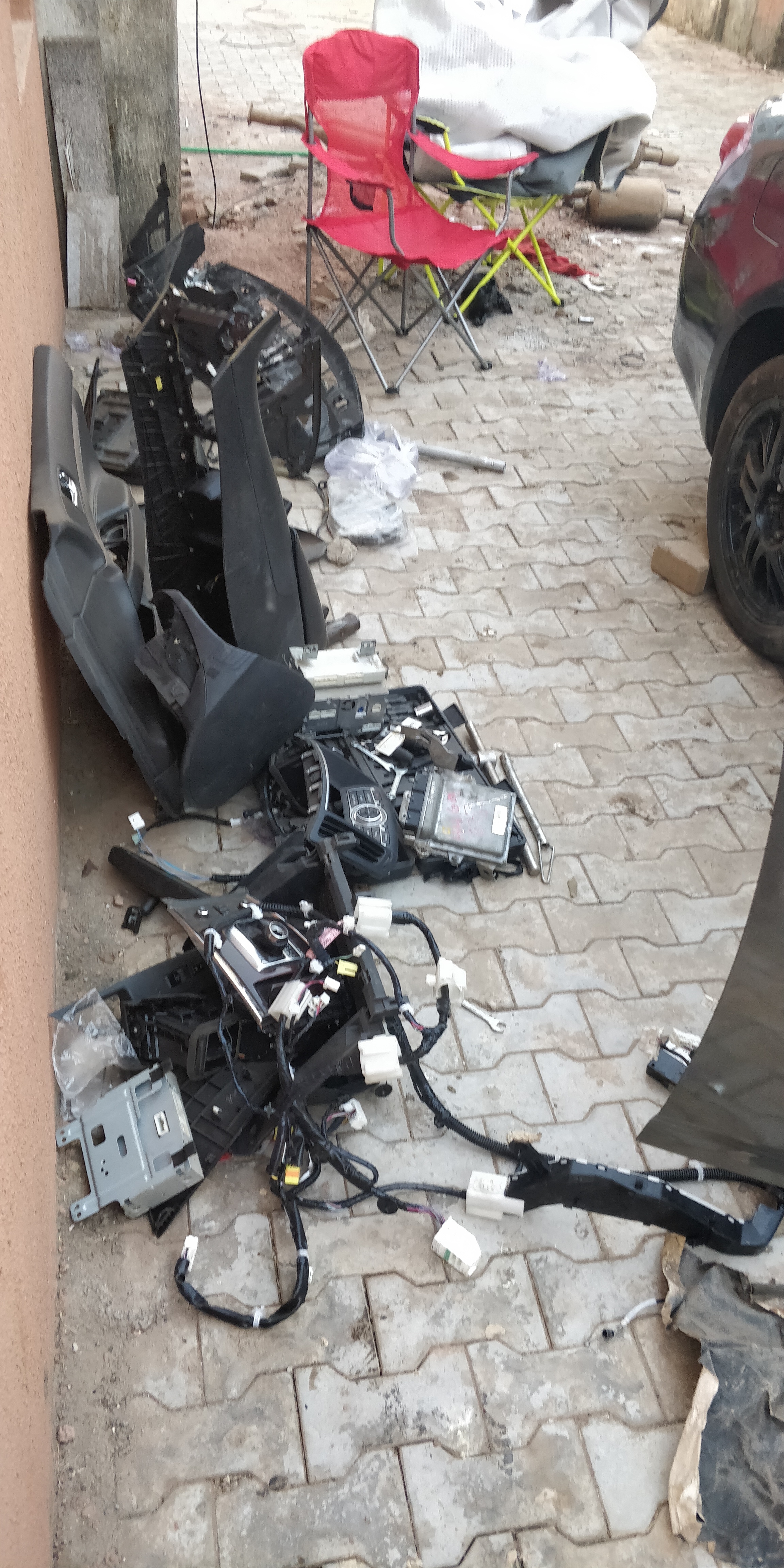

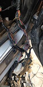

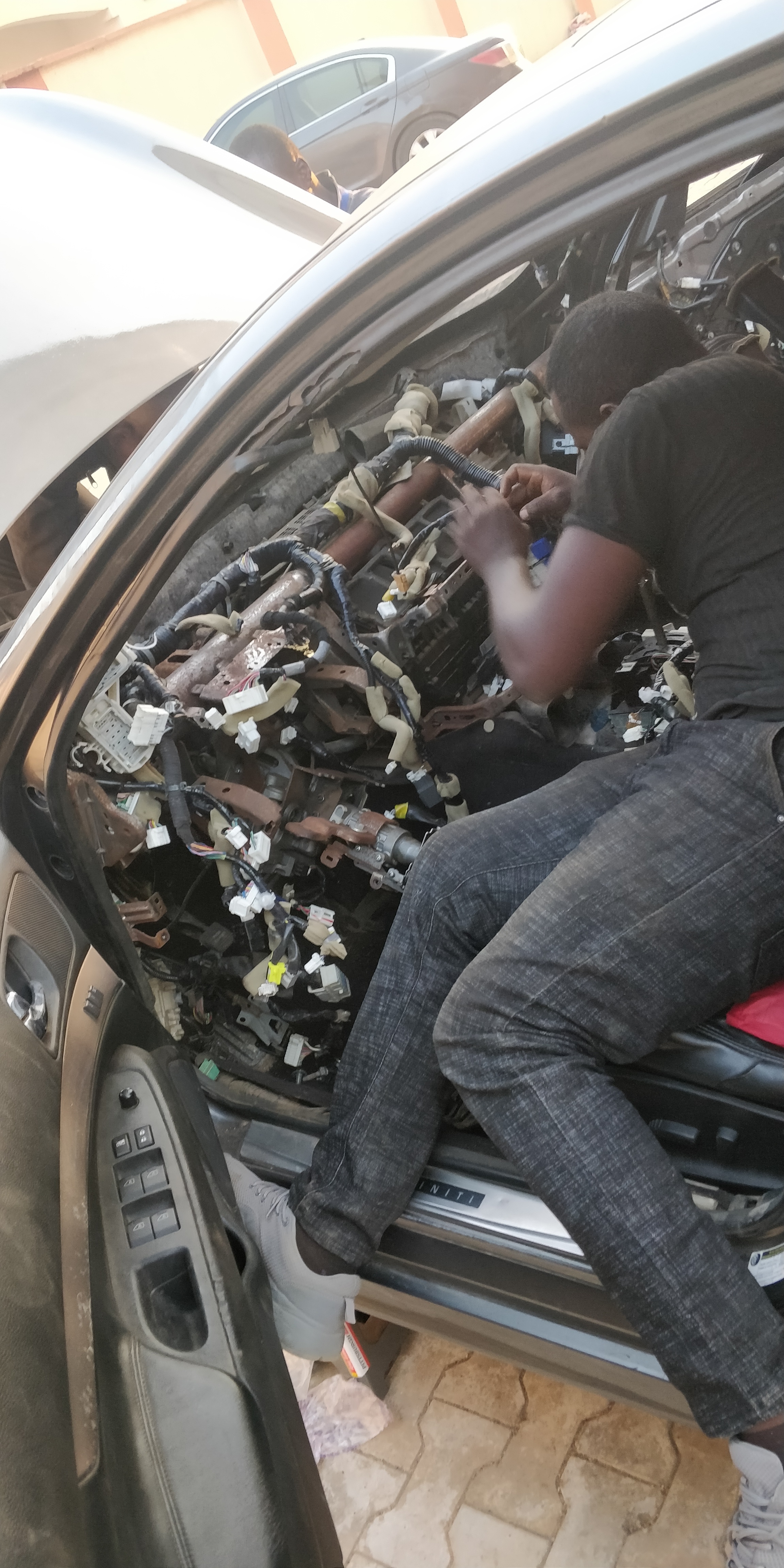

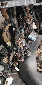

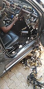

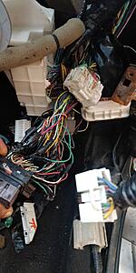

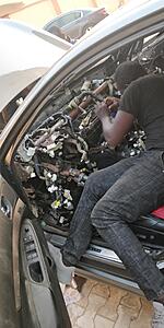

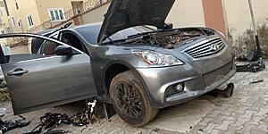

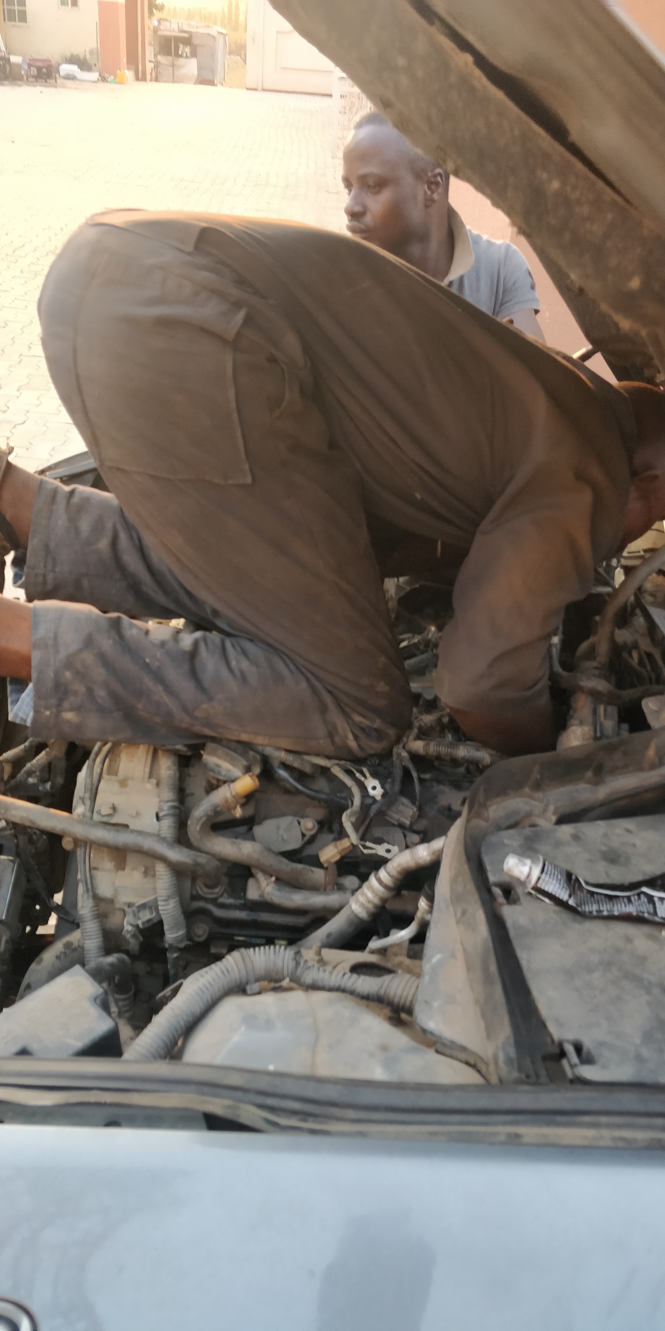

So I started working on the dashboard/engine room wire harness replacement, here are pics from the adventure. Might take a day and a half.
Included pics of the dashboard/engine room harness that was severed and partially reconnected back with electrical tape.
I believe when I shipped my car out of the country the ECU was stolen or rather carved out of my car and replaced with a ECU that linked back to a 09 g37 w/o cruise.. no wonder that didn't work
2013 g37xs 33k miles
