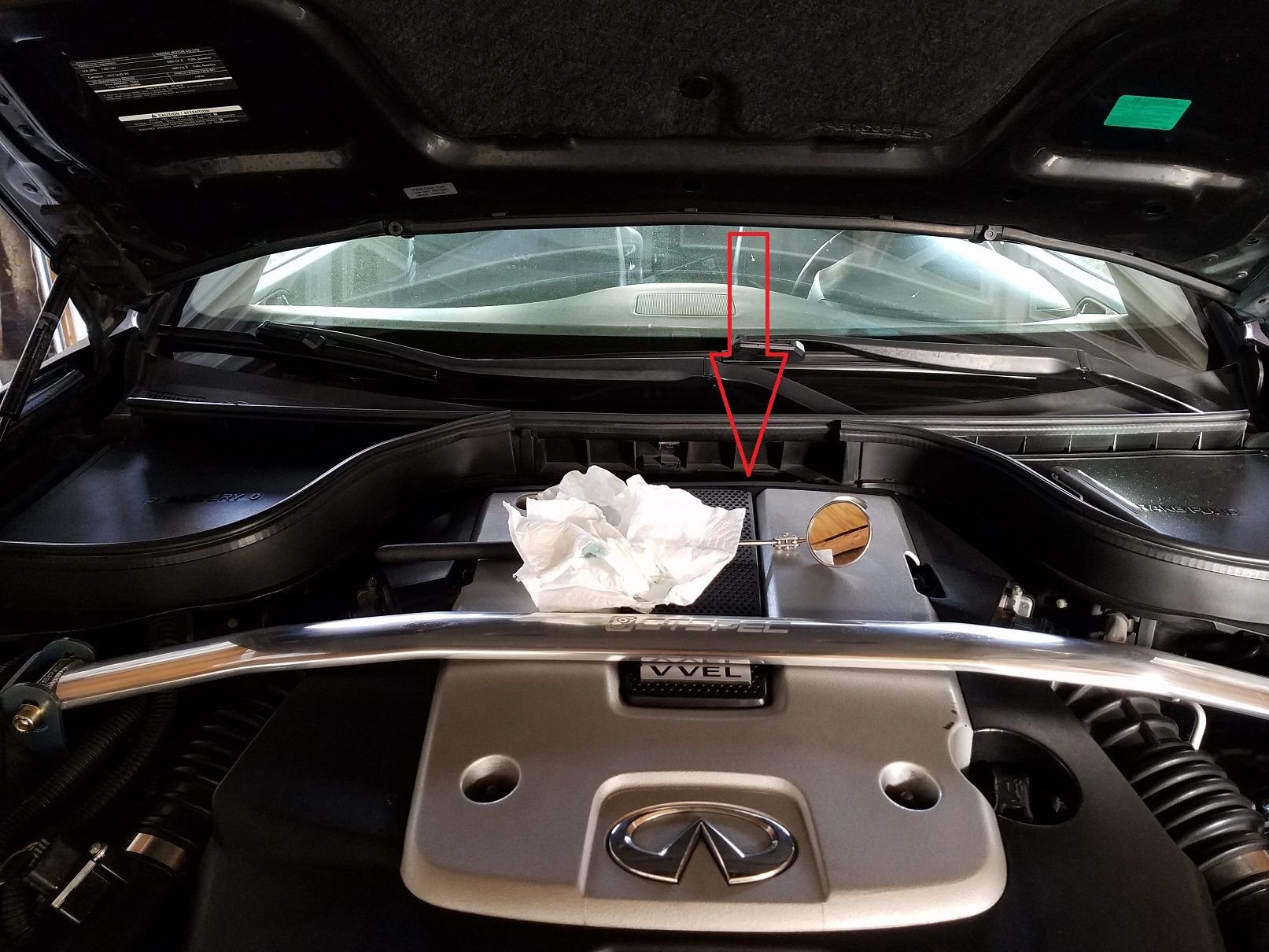

So I have been driving my G37 Sedan for about 5 years now and today noticed slight coolant seepage from the top of the Radiator Hose where it clamps near the oil dipstick. I cleaned off the coolant and connector that had been dripped on and re-clamped the hose back. I later noticed more coolant seepage. Any thoughts? Will new hose and clamp fix this or is there possibly a bigger issue going on? At 82k Miles Thanks guys.

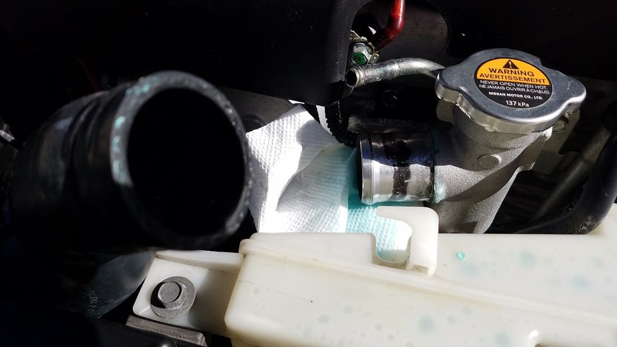

Well here she is fellas and Rochester.... thanks that clamp is great!
Used a hand pump, great suggestions guys.
Yuk
Dremel and a steel brush adapter.
New hose and New clamp! That clamp is not going to get loose.
I ended up also cleaning the throttle body on the left since took out the Air Assembly which was covering the Radiator inlet from the hose. It was bad! Will do the right one next weekend.
Thanks again for the tips and parts! Yes, that clamp is a must for all Rochester! Great tip Brother!
Old Oct 28, 2017 | 08:13 PM
Nice job getting that all cleaned up w/ that nice new clamp. Nice to see you only had some minor pitting under the hose.

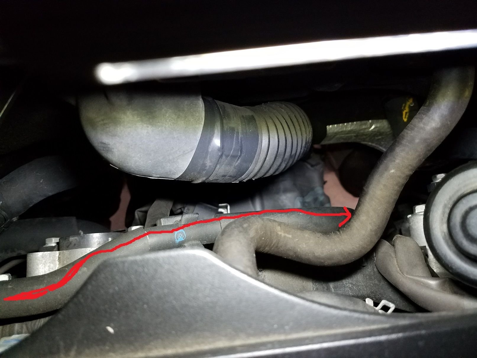

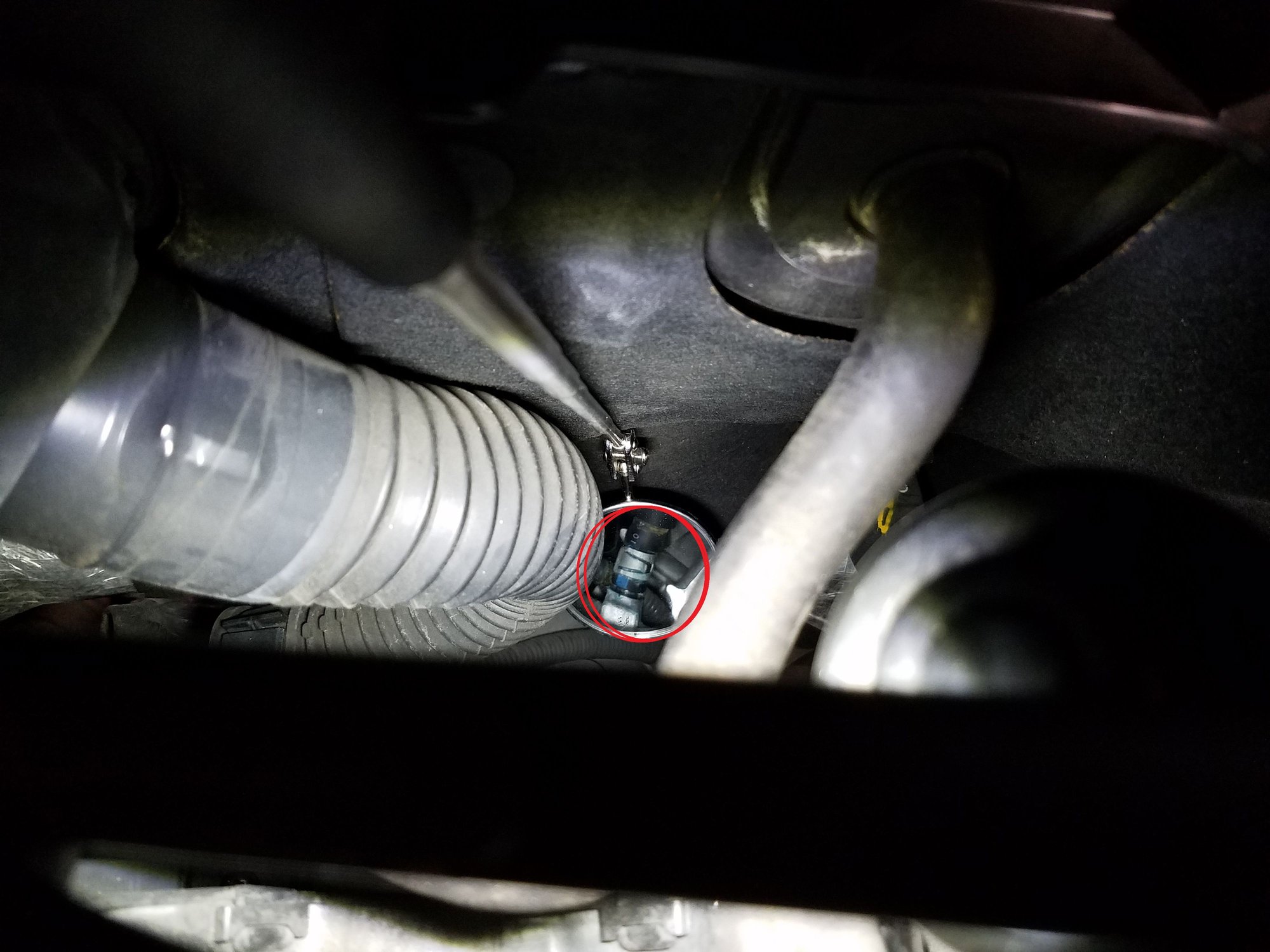

So after I had fixed that leak.... another appeared. After fixing the previously leak, I later had noticed my coolant reservoir still draining. After a few weeks I did my oil change and immediately notices I had a problem when I saw the left side of the transmission case covered in lines of coolant. Here's what I had found.
Where the hose is between the two arrows was where are the coolant was leaking from. I pushed the hose on to be more snug and now will wait and see if further action will be required.
Any thoughts or inputs fellas? BTW that's not a nut on the bottom its just a blue line on a hose in a hose. weird... is that stock or same on your rides?
***UPDATE*** I purchased the hose and clamp for around $10 another $12 shipping $22 Total. Gonna fix this myself. I bet they would charge like $150 easy lol.
