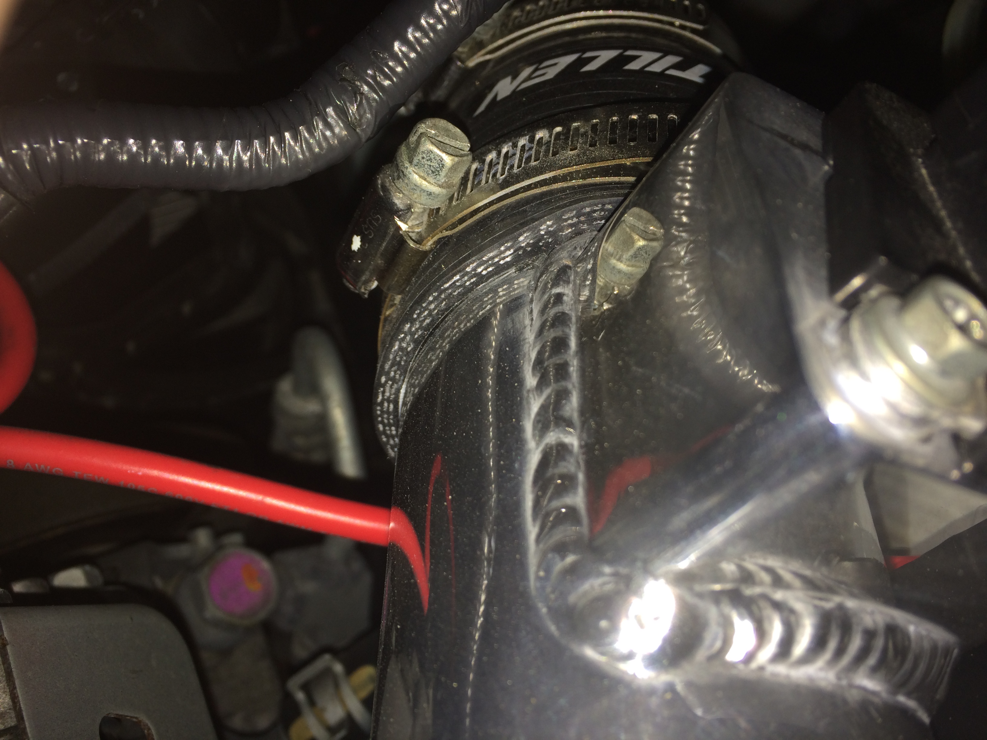

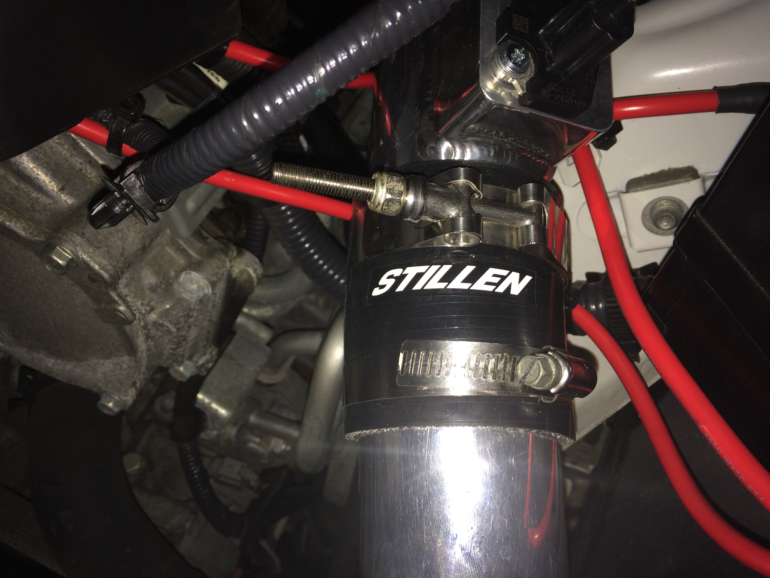

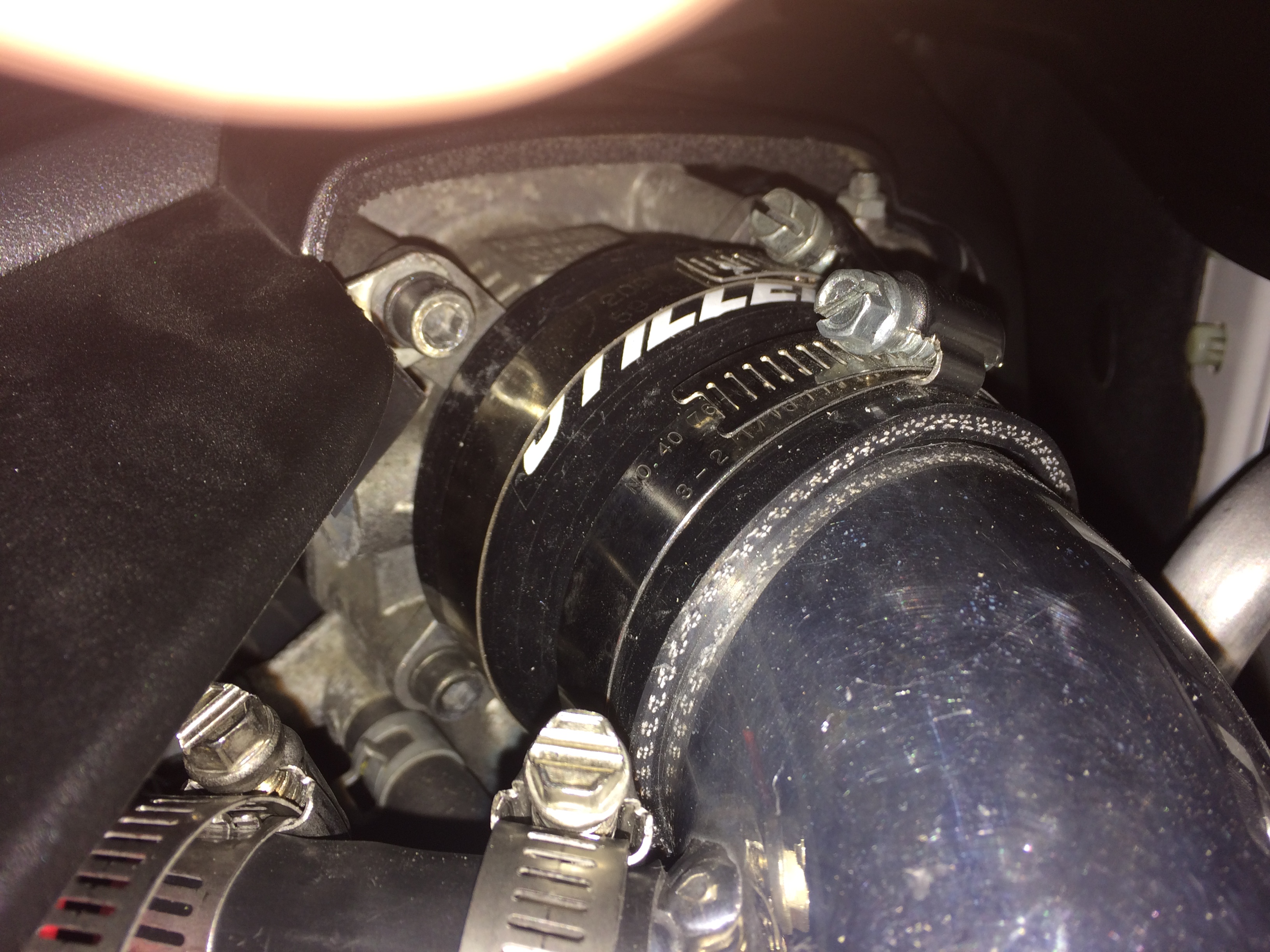

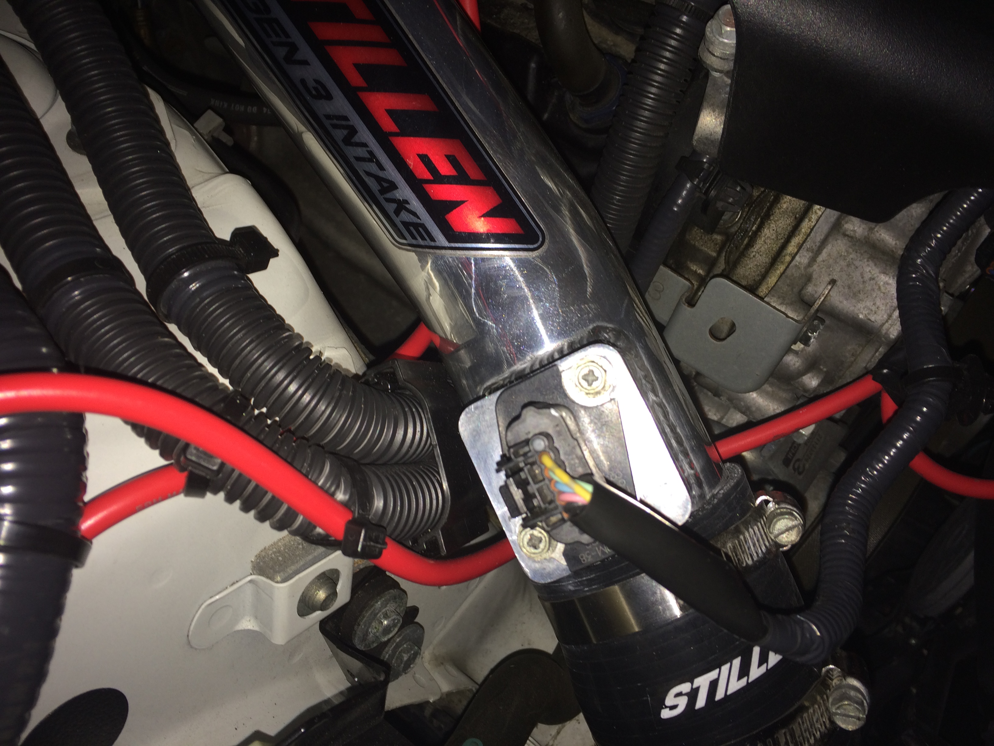

Is the silicone hose that attaches to the throttle body all the way on and not maybe slipped off on the bottom. Take pictures as well

I just re-secured everything. I'll take some pictures tomorrow morning and post them up. Hopefully someone can see something I'm missing

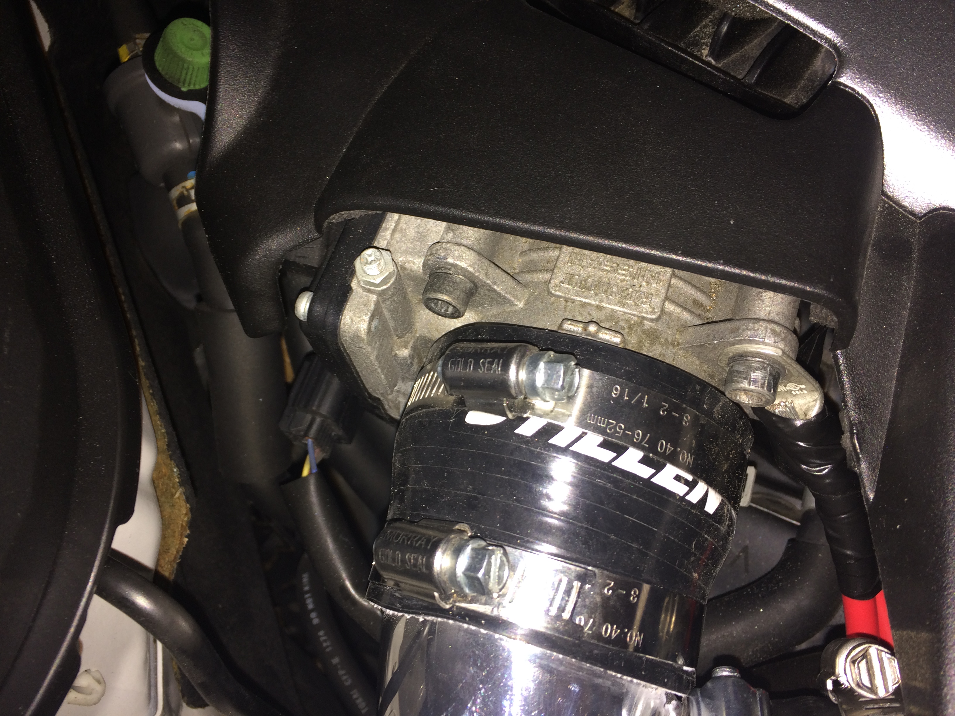

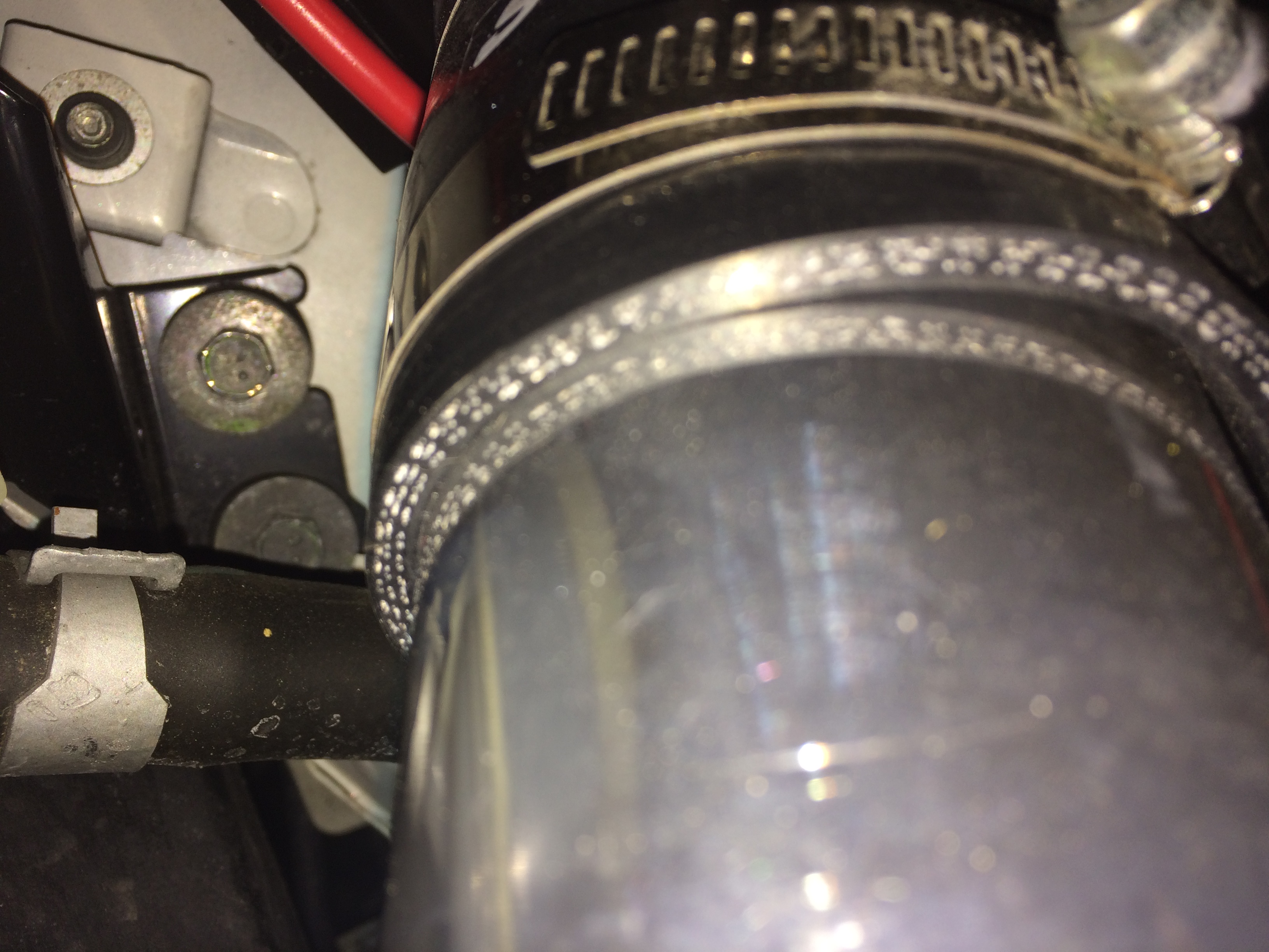

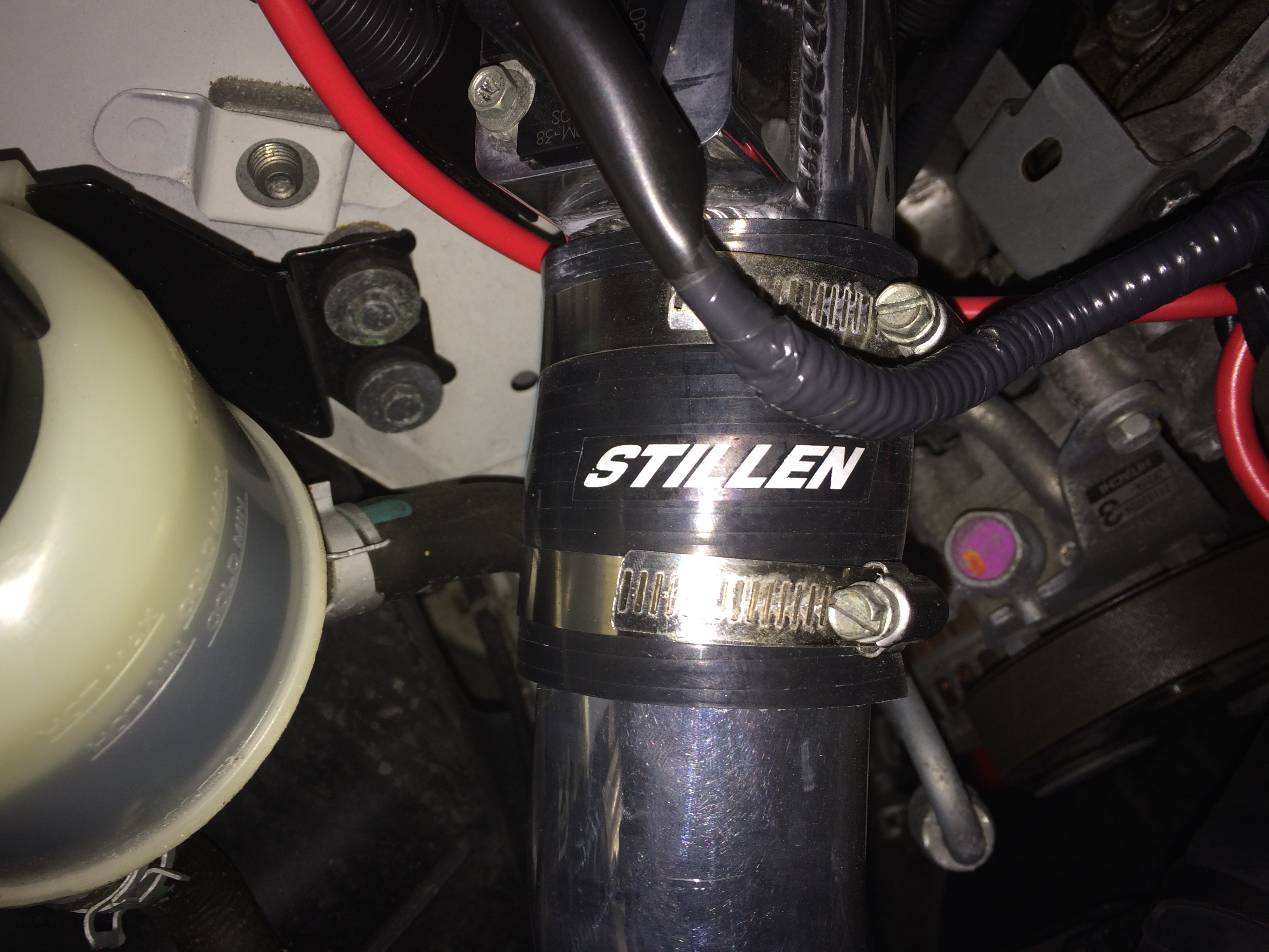

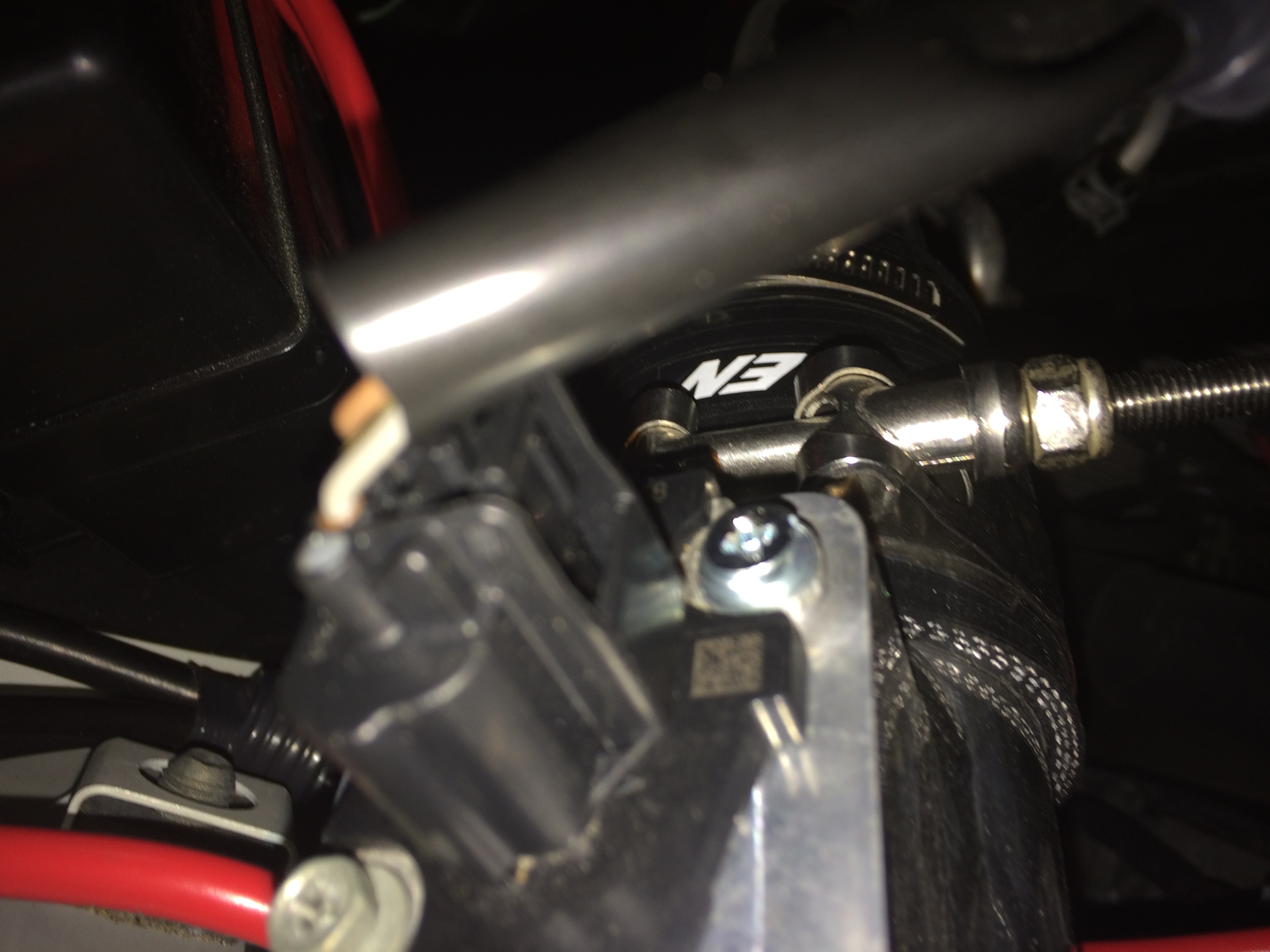

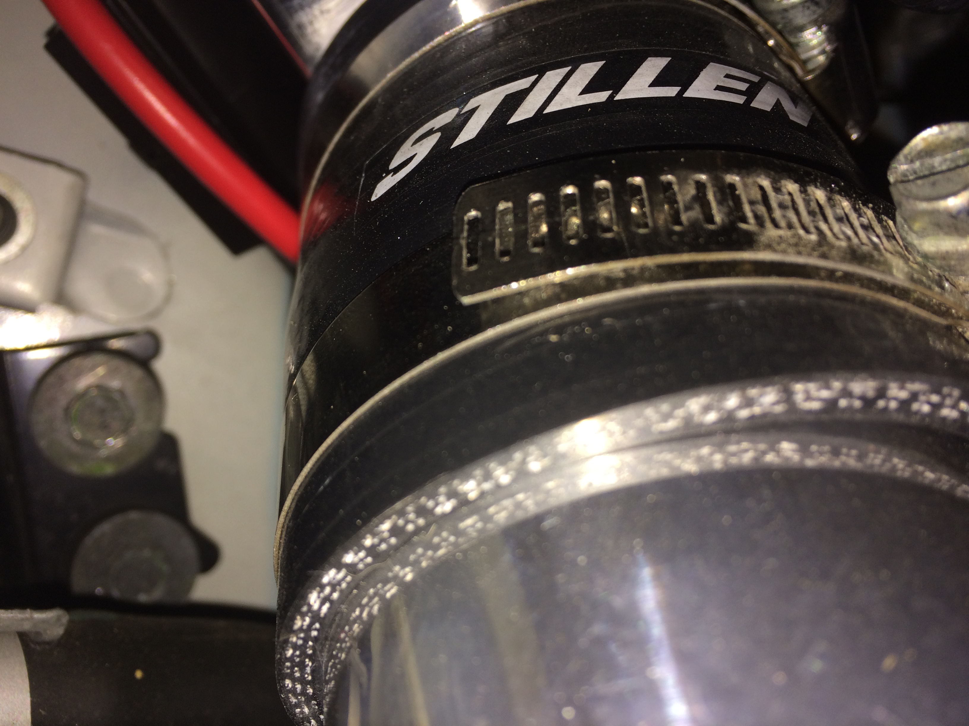

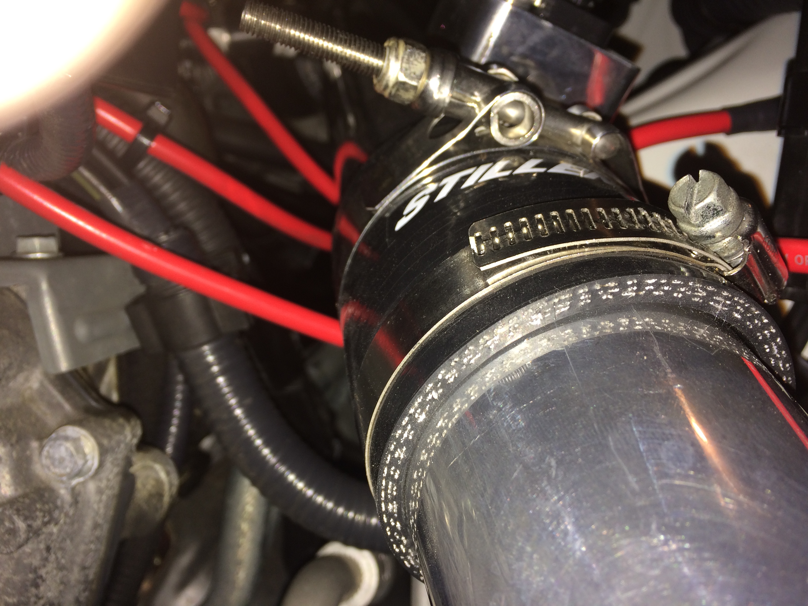

0861-0868 are all pictures of the driver's side intake. After that it goes to the passenger side. Any questions in regards to the origins of the photos feel free to ask but I tried to do a picture from above but below the MAF at the first coupling, a shot looking up the tubing, then a shot showing the sleeve after the MAF looking up the piping to the TB, next shot is DOWN the piping from the upper sleeve towards the MAF, and last two shots are of the TB.
Attached Thumbnails Multiple codes being thrown - Any body experience these?-img_0861-1-.jpg   Multiple codes being thrown - Any body experience these?-img_0862-1-.jpg   Multiple codes being thrown - Any body experience these?-img_0864-1-.jpg   Multiple codes being thrown - Any body experience these?-img_0865-1-.jpg   Multiple codes being thrown - Any body experience these?-img_0866-1-.jpg

Try moving the hose clamps lower to the edge of the silicone connectors

Loosened, tugged/adjusted the fittings in between the filters and MAF housing and re tightened everything and so far so good at 50 miles. Maybe there was a leak. Last time, everything looked good and I did a hard acceleration and the CEL popped and I haven't gotten into it in the 50 miles I've gone codeless. That being said, I believe something would've popped by now if there was an issue
