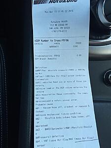

P0106 Service Engine Soon Code
Got the SES light...Here is the diagnostic:
They told it could be a dirty MAF, since the car still works perfectly. My car is tuned, so I'm thinking that it's possible it might be tuned related.
Any help on what it might be?

I had read about that code showing up on FI applications. Not sure about why it appears for me. I'm hoping it's a dirty sensor.

how is the engine running? you may have a small vacuum leak causing the map sensor throw that code. i would check vacuum hoses and pcv hoses to make sure they are all sealing well on its fittings and not cracked or broken causing unmetered air from entering the manifold.

you have the M370, Check the vacuum hose that the stock MAP sensor is attached to, There could be a leak there.

MAP sensor, not MAF.
MAP sensors do not get dirty,
Most likely a vacuum leak.
