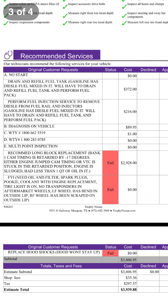

Sludge?
I guess so. But since the car you bought has run diesel fuel through it and only had 1 qt of oil in the crank case, I'm going to chalk that up to operator error and not a flaw in the equipment.
Mine is a 13', so I'm still running on the break-in oil and sludge isn't an issue at this point. I put 100K on my 04 and didn't have a sludge problem, so I'm pretty confident that this isn't a problem with the VQ.
I know that Audi/VW have had problems with sludge on their 1.8L turbo charged models. The only problem I'm aware of with the VQ37VHR is the fact it is not that competitive when it comes to gas mileage. Long stroke, large bore, high compression NA engines typically suffer this fate.
Hopefully the patented diamond-like carbon (DLC) coating will help internal heat/friction and contribute to less sludge over time: Ultra-low Friction Diamond-like Carbon | NISSAN | TECHNOLOGICAL DEVELOPMENT ACTIVITIES
My wife's 99 a4 just missed getting a new motor.
It was a n/a 2.8 but, all the motors including the turbos were having sludge.
It had just past the 10 year mark of the in service date.
She had 110k on the odo, dealer almost went for it but corporate said no.
The diesel in the tank was local gas station problem. They have paid us back for those repairs.
I thought the 1 qt oil was due to oil consumption. We had just had the oil changed within the previous 2 weeks.
Could running car low on oil cause sludging?
Yeah, that'll do it.
