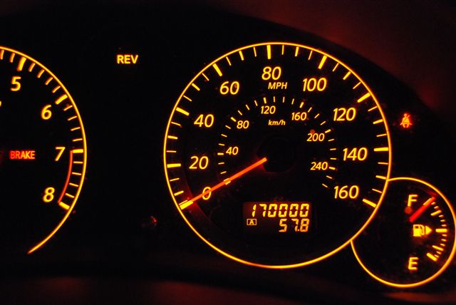

Here is a photo of my 06 G35 shortly before I traded it in at 171796 miles
Engine still ran like new, however it had 53 oil changes never going over 4k miles between changes.
Where did you ever get the idea that you could go 10k miles without changing oil?
Change oil at 3.5k miles yourself to see what comes out of the crankcase & you'll understand why.
I've seen the damaged engines at the dealer as you are not the only one that thinks you can save money by infrequent oil changes.
