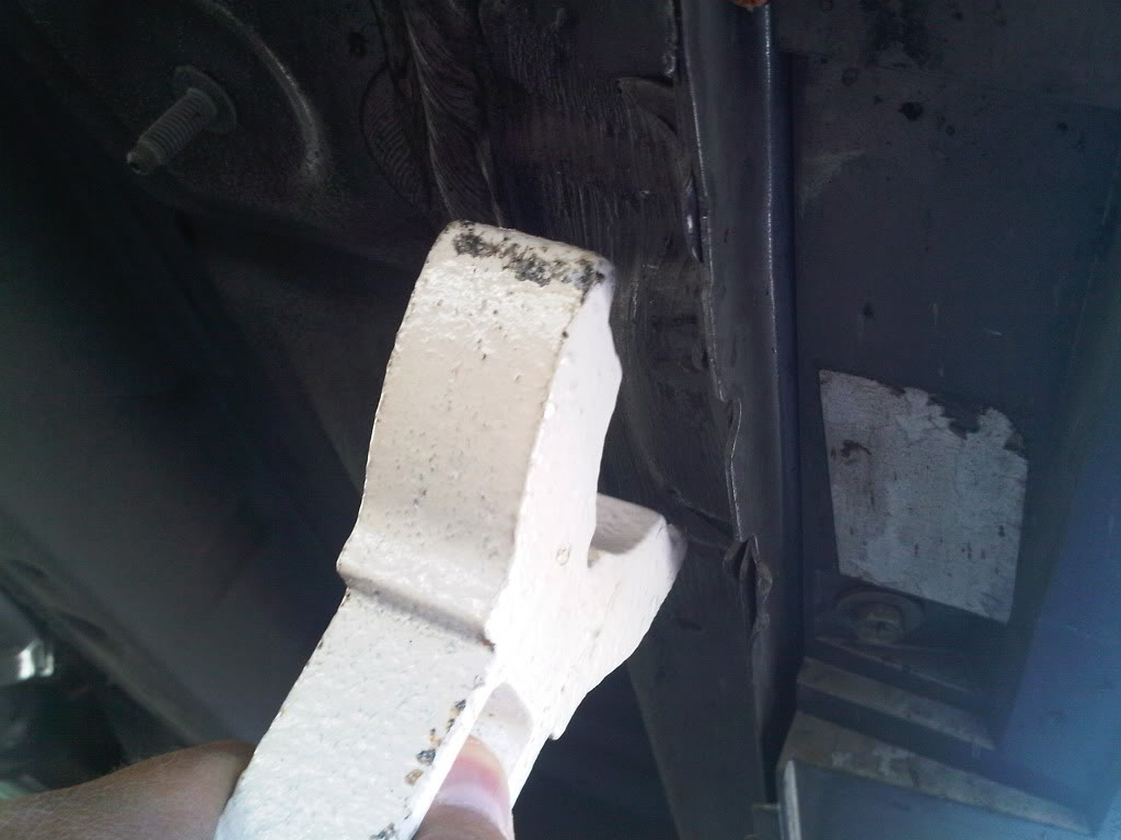

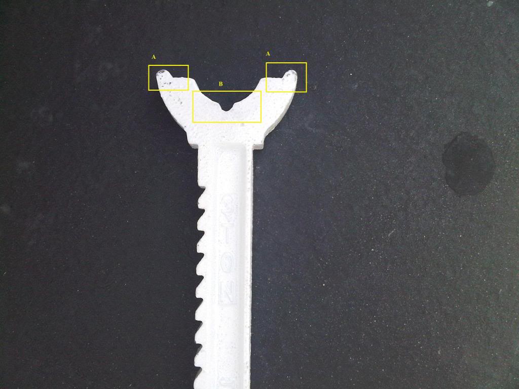

here is the standard jackstand piece that comes into contact with the car.
i labeled certain parts for the ease of explanation
standard jackstand procedures (from what i know - possibly incorrect) tells me to have it connect this way.

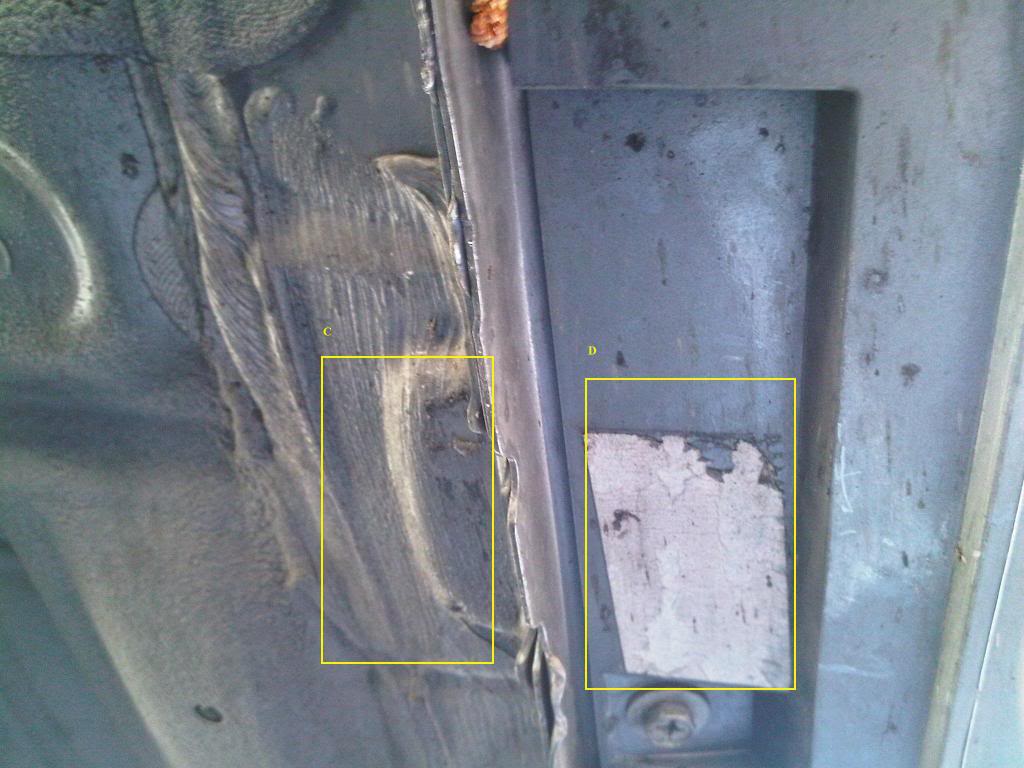

here is what the pinchweld/frame/underbody looks like. once again, labeled for explanatory purposes
NOW... i CANNOT attempt picture#2 because sectionB is too DEEP and the sectionD doesnt seem to be able to withstand sectionA. (try it and poke at it... doesnt really seem stable). SectionC on the other hand is quite tough (will explain later).

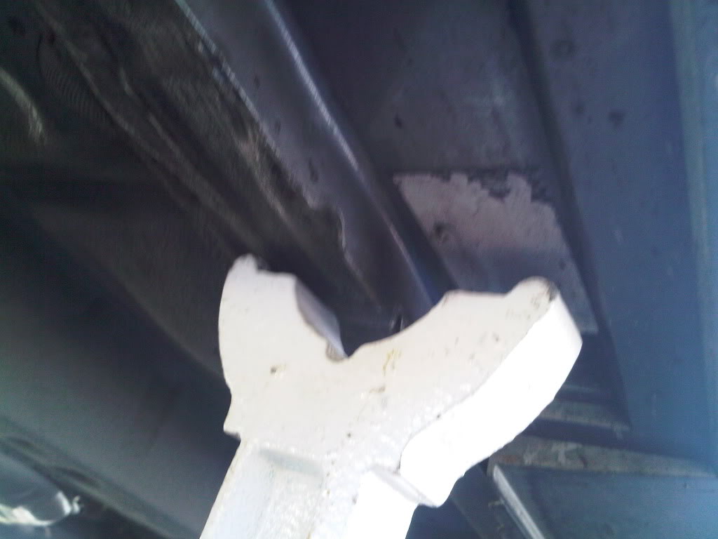

As a result, this is how i currently place my stands. (its PARALLEL to the pinchweld) its actually bending the pinchweld as you can see and i need to find an alternative method.
I noticed taht when using the scissor jack... the pinchweld slides into the the proper slot and the part of the jack that pushes up the car only really comes into contact with that "slot" and sectionC. it doesnt even touch sectionD.

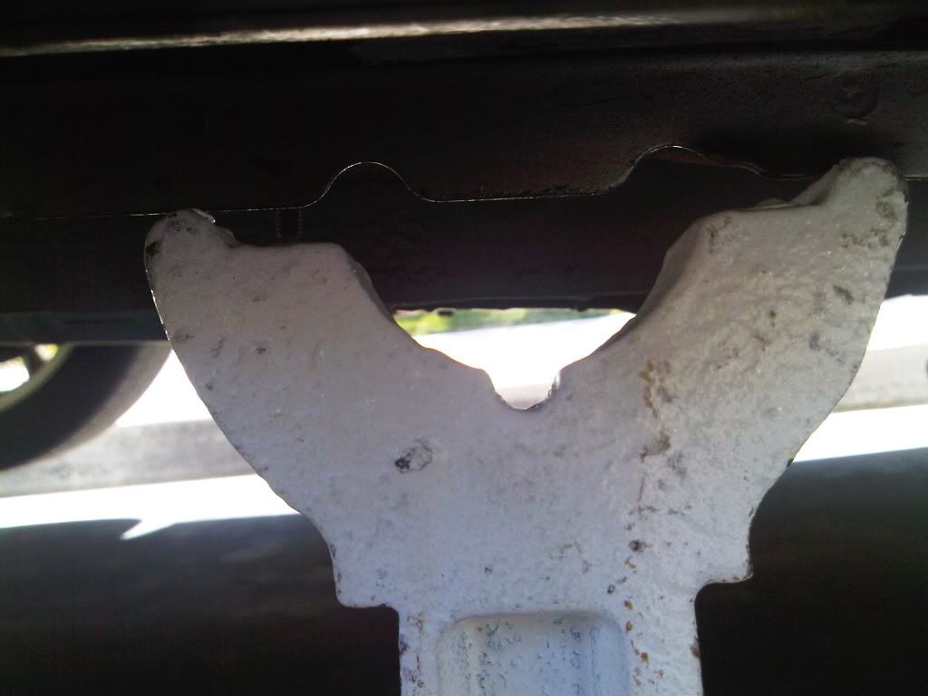

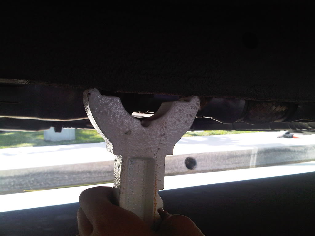

now, here goes a possible solution (educated guess).
im contemplating on setting i up this way... and was wondering if itll be dangerous
one of my friends called me stupid and told me to jackstand it from the frame... which i have NO idea where it is. this is my guess. would it work?

I agree, last pic is probably the best, if you rotate it 90 deg. The way you have balancing it on the pinch weld seems very dangerous. Imagine if the pinch weld folded, stand slipped, and caused the stand to fall. Man, I sure as **** would not get under with it jack up on the weld like that.
Your second method seems ok too, but the frame is the best best by far. Again, just rotate it so it has as much surface are contact, straddles, and you will be good.

COOL... so thats the frame rail that everyones talking about lol.
same applies if i wanted to hold the car up form the back right? but i just follow the rail towards the back

Go further in to straddle the frame rail.
Your pictures show youre on the body's pinch weld.
