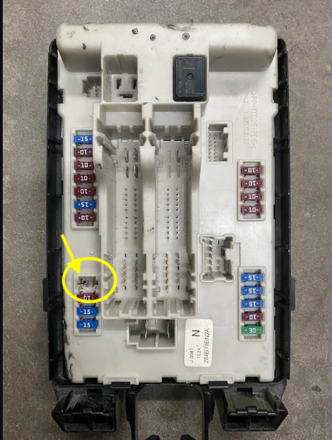

There are very few cases where 2013's suffered from this issue as Nissan made the "quiet" change sometime in 2012 but it is not out of the realm of possibility. It all depends on where you car was on the assembly line when the change took place.
That said, being your steering wheel never locked likely indicates your car does NOT have the ESCL module installed. However, if you want peace of mind, check the IPDM/er under the hood. Look for a 10amp fuse in the slot indicated:
IF there is NO FUSE in that slot you are golden. IF there ISa fuse in that slot then I would recommend that, with the engine RUNNING, pull the fuse.

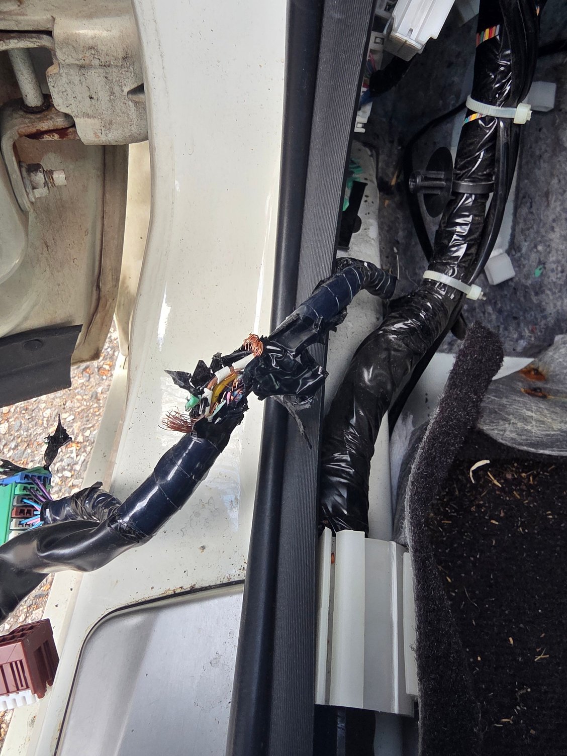

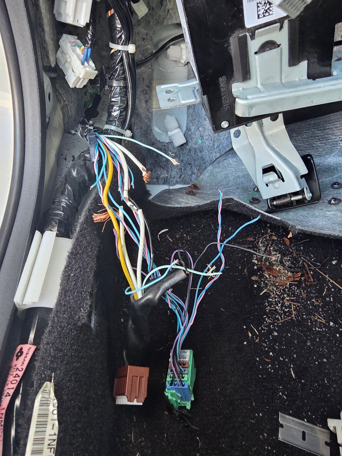

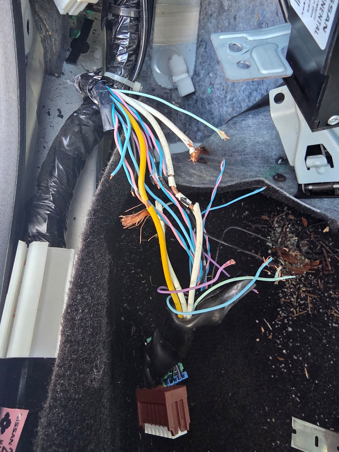

So when i pulled the fuse box from the driverside kick panel to check relays and this is what i found. I fixed all the broken wires (soldered and used shrink tubing) plugged everything back in, now the ignition will turn on and off it still jumps straight to on but at least it can turn off now and no colling fans running. The daylight ran out on me tho. Ill try and program the key fob and see if im good.

Crikey... Who threw a spanner in those works? Safe to say water ingress, while important to address, couldn't have done that to the wiring.
What in hell precipitated that harness getting trashed?
I am happy for you in that you're taking the time to repair it properly and are making some level of progress. So far so good... I guess?

Yeah they def had a plan to come back and steal the car. That was nasty when i saw it. looks like they were just pulled real hard. Maybe to stop the factory alarm? Im making great progress. most of the major issues are taken care of. Will put scanner on tomorrow and cross my fingers.
