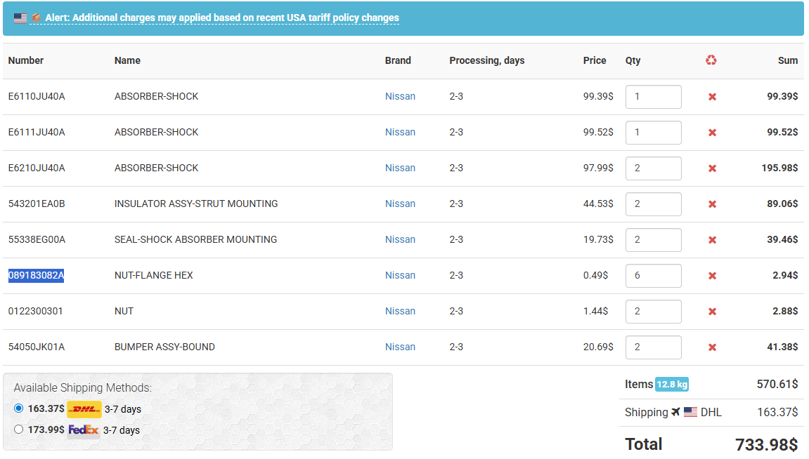

I plan on buying another set of Tokicos next year from Amayama. Cart has been staged per below (Dipstick parts are also shown).
You may want to make sure Amayama can ship the shocks. Because those items are gas pressurised many vendors and carriers won't ship them- at least not via air.
Even domestically there are shipping restrictions akin to lithium batteries. When I bought my Koni's they had to go (slow) ground even though I wanted/ was willing to pay "priority." So, just a heads up

My cart is similar, but I didn't include the nuts. This diagram seems to indicate that they are included with the strut.
I wouldn't bet on the nuts being included. They weren't included when I bought the mounts. I'd err on the side of caution and get them.

Here's the the struts/shock setup through Partsouq. Everything is coming from Japan, so they may be using the same source for parts. I'm familiar with the shipping restrictions around batteries, but wasn't familiar with ones related to pressurized dampers.
I'm guessing that duties have not been added below, so the two sources cost roughly the same.
It may/ not be a issue or perhaps it depends on the seller/ carrier. I just know that when I bought my Koni's it took forever and day for them to ship from California because neither FedEx or UPS would accept the shipment using "Air" service- they had to go ground.
¯\_(ツ)_/¯
And, personally, I would not trust DHL to ship a box of saltine crackers across the street. Too many issues with them in my region but YMMV.
¯\_(ツ)_/¯
And, personally, I would not trust DHL to ship a box of saltine crackers across the street. Too many issues with them in my region buy YMMV.
My work only uses DHL for shipping evaluation boards and samples, so I am well aware of their nuance. You were not happy with the Koni's right? There are very few reviews on both the Tein's and Koni's.
My car rides nice and handles well, so I'm worried I will screw something up with aftermarket dampers as the OEM ones are matched perfectly to the Swift springs.
