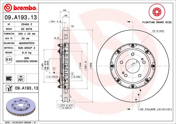

Was washing my car, didn't think my brake rotors looked too great. I have the akebono calipers. I would love to get the two piece rotors. Not in love with the thought of the big expense. It seems you can get two piece Mitsubishi Evo rotors, for about 300. Problem being, they're 350 vs 355mm there also 67mm bore vs 66.1
It doesn't sound like it would be that much of a problem.
Has anyone tried it

Is the 355mm from the EvoX?
Only other concern to consider would the the hub offset of the rotor to center it to the caliper.
From this information by Brembo, the EvoX has a width measurement from the front face of the hub to the back of the rotor is 44mm
https://alvadi.ee/en/kataloog/varuosa/17310236/25876
I did a rough measurement on my spare sport rotor and its roughly 49mm or 50mm.
