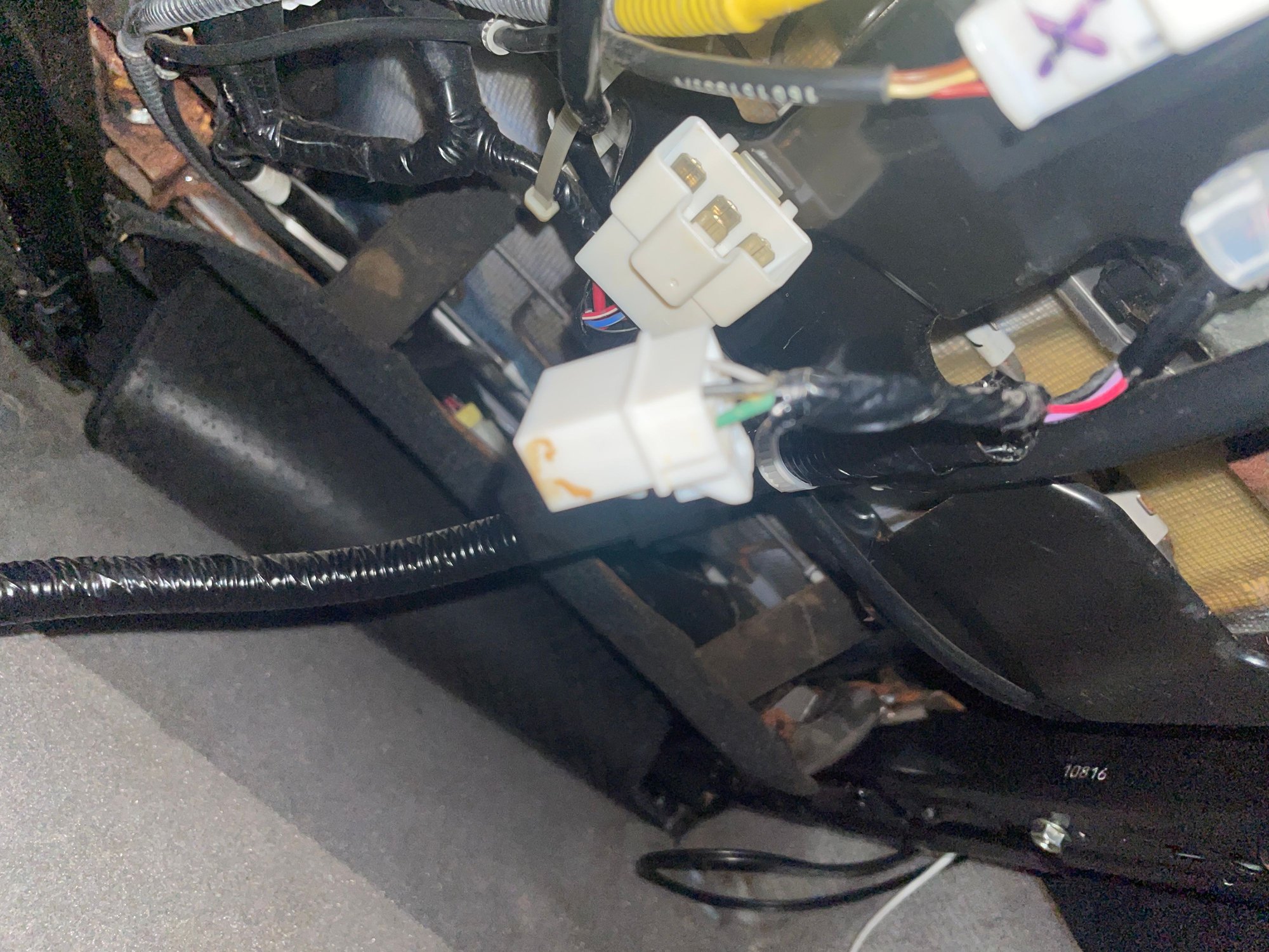

Hi guys I was just wondering if anyone knew what the wire colors were on the main
wiring harness on the seats to connect the seats to the harness connected to the floor. Right now I tried looking at diagrams and am confused so any help would work. Thank you

I'm not sure what you're trying to do or what "Anniversary seats" are.
If you don't already have it, the manual for your '08 sedan seats is here:
https://www.nicoclub.com/service-man...F2008%2FSE.pdf
Scroll down below the viewing window and you can "click here to download a copy".
But yeah, these books can be confusing. Does your car have "automatic driver position" memory? And are you working on the driver's seat?

its the red seats from 2010-2011. And yes it came with the automatic driver position

Here's a link to the 2011 Seat FSM:
https://www.nicoclub.com/service-man...F2011%2FSE.pdf
At a quick glance comparing these two books it looks like quite a few things have changed between '08 and '11. Seat heater switches and controller are different. It also looks like the "automatic position" controller uses the same shaped plug but many of the wires show different colors and values so that's a big change. I think the motors are probably still in the same positions and operate in the same way but it will take some hacking to get those newer seats to be fully functional in your '08. If all you need is manual controls then you can probably pull that off without too much difficulty. Just my 2-cents.
To get you going here's is the color code key.

Thank you so much I’ll look into the 08 Manual and see what I can do. This color code should be similar to the 08 correct? This should help a lot
