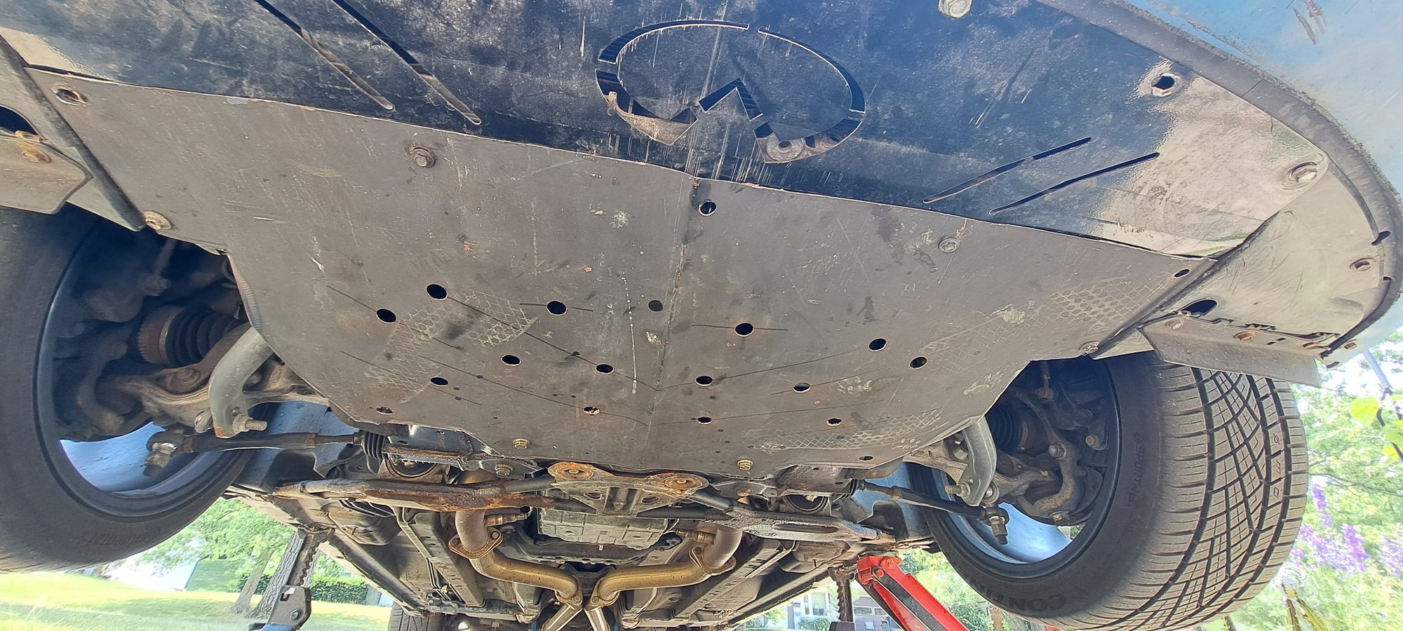

I had bought a tbw aluminum undershroud last year and ot held up pretty well, definitely scraped pretty hard in spots. 2 weeks ago it met a raised sewer plate going about 20 mph and a big piece of it broke off. Nothing wrong with the quality of it or anything like that just was too much for it. Well i was going to try the z1 undershroud to see if the fitment was any better but i lacked the $240 for it and i didn't like the idea of leaving it open underneath especially with it lowered. So i made own out of a hood of a 91 s10 blazer. I did save the front piece of the tbw that connects to the bumper because it wasn't damaged at all. Traced the front shape of the rear piece and cut to a square size, marked and drilled holes using the tbw like a template. I flipped it over to Trace the holes from the part that was broken off. Waiting to get a 3/8 16 tap tomorrow to finish installing it, one of the 10 mm bolts got torn off destroyed the threads on the subframe so i figured to retap with something a little stronger. Had some grade 8 self tapping bolts from work but i think i lost them somewhere. Anyway this is what i came up with. Drilled extra holes for drainage and heat dispersion. Steel is a little heavier than aluminum but the strength is something I'm willing to trade off. That and it was pretty much free.

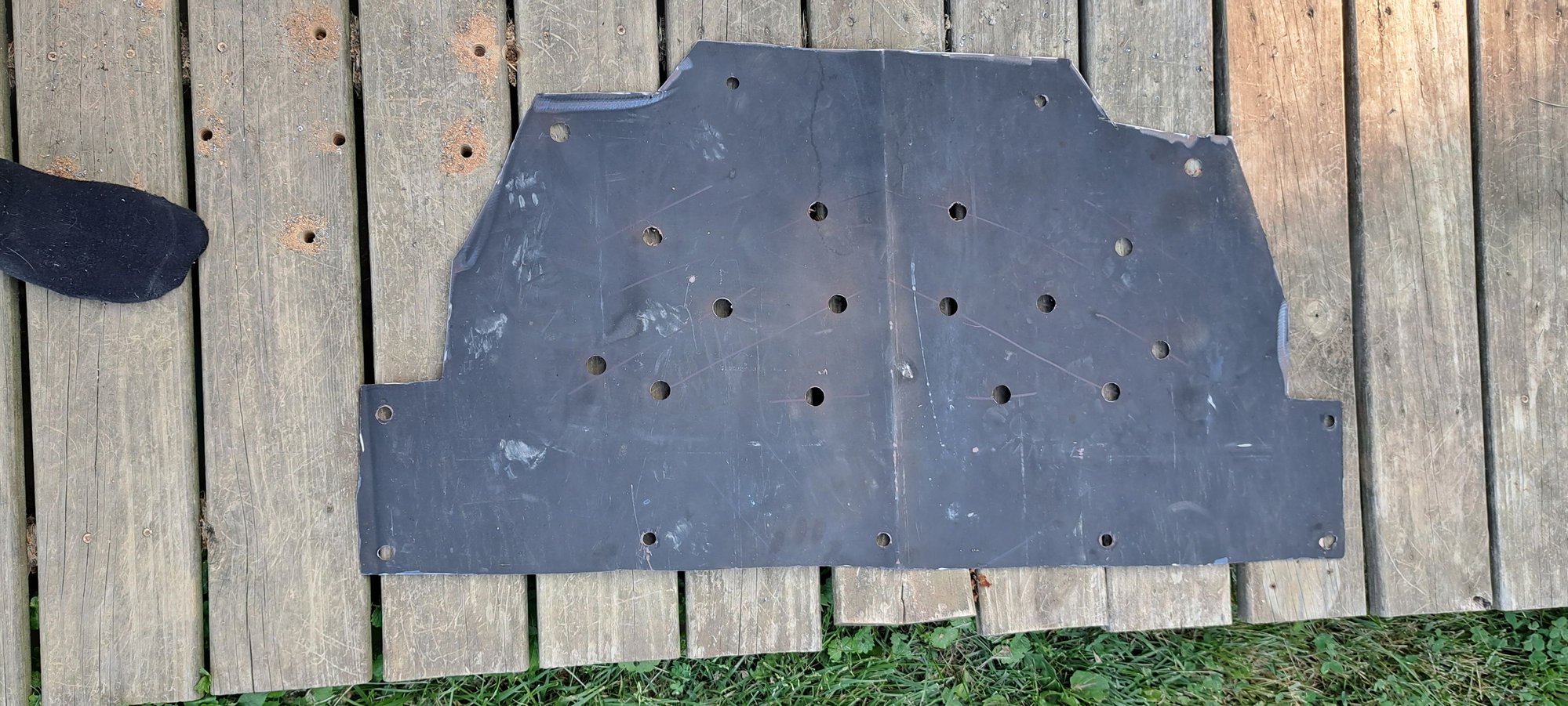

The piece that broke off my tbw.

Well i got everything bolted up today, looks good to me.
