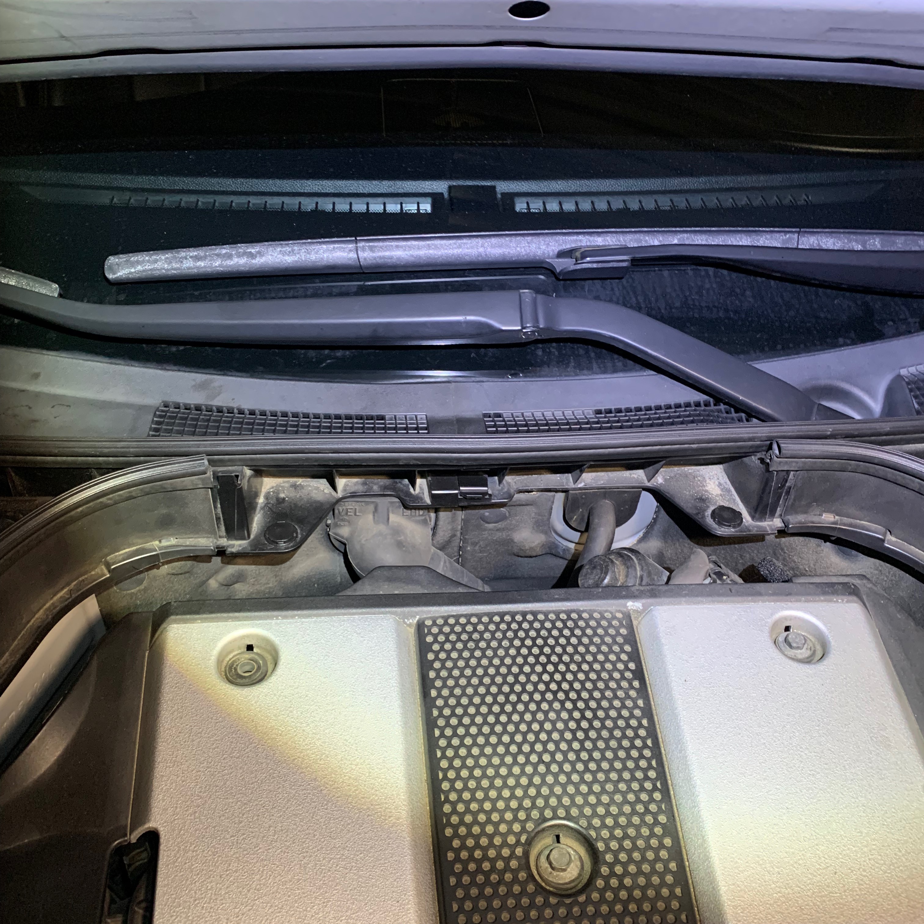

OK, I got a better look at it, and the foam rope seal in in place. The problem is, I'm working in the bowels of a parking garage with dim lighting.
Anyway, here's what I'm up against:

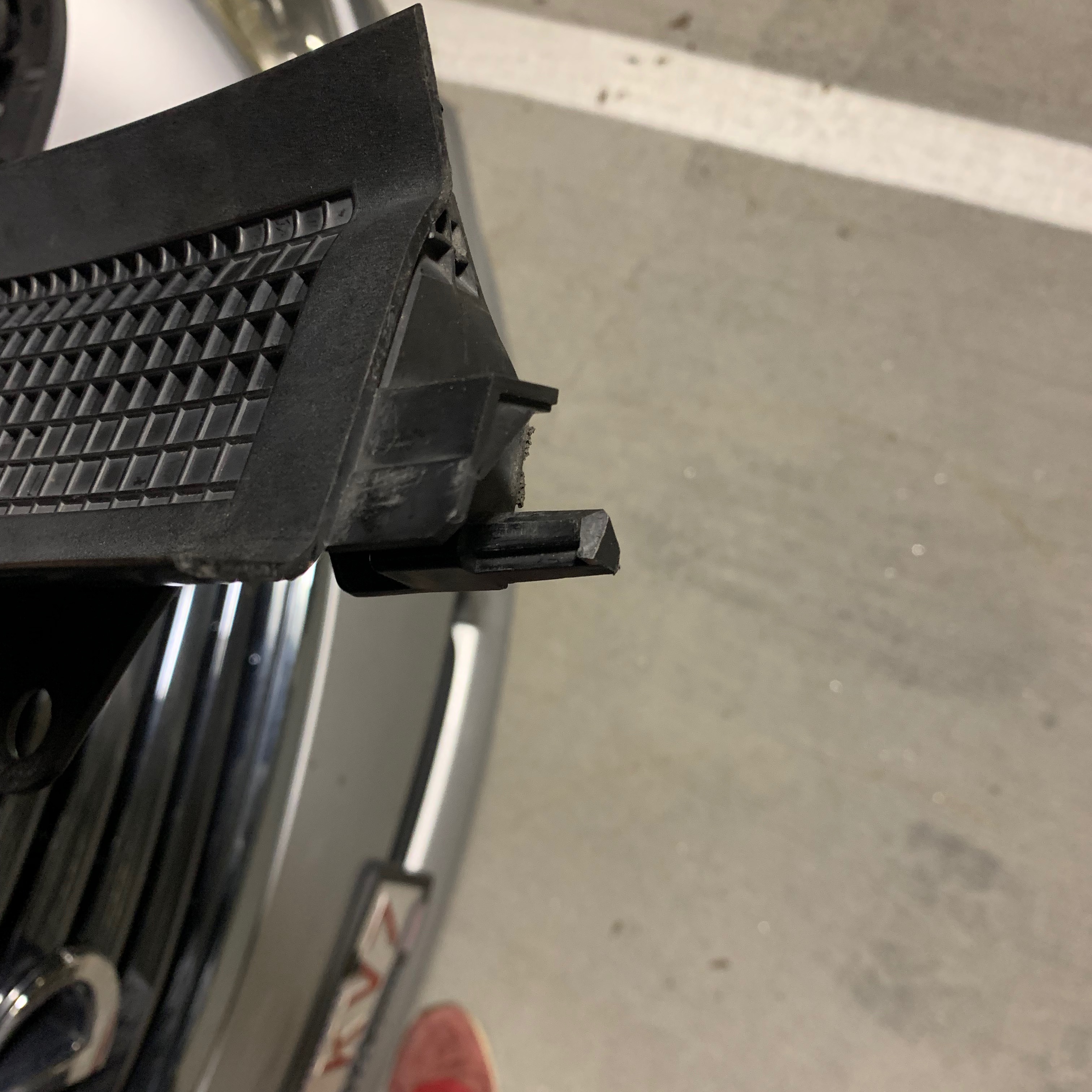

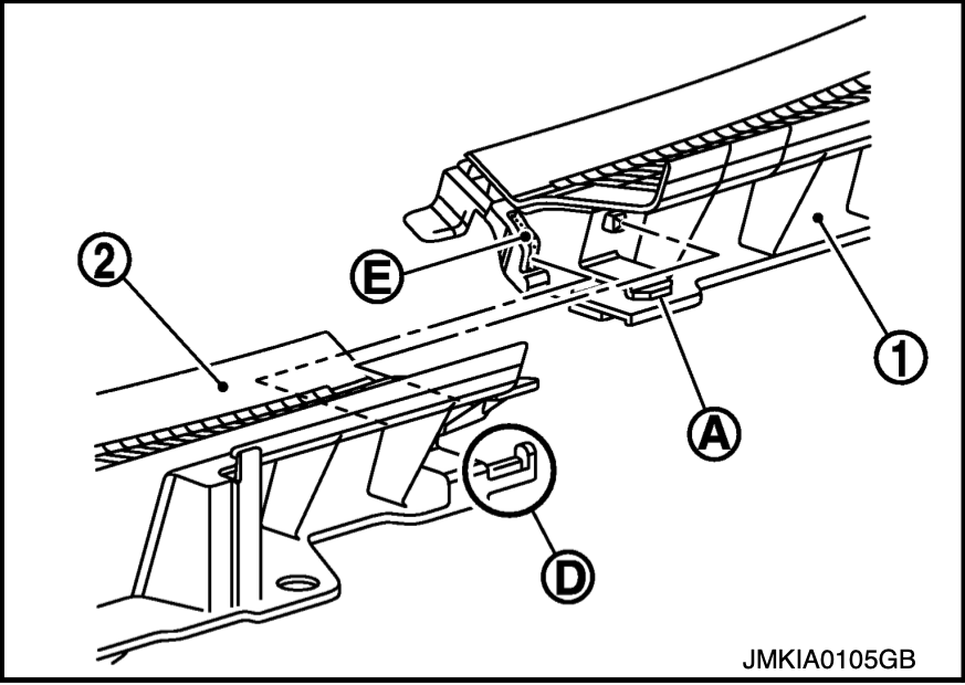

I think the reason why the passenger side cowl cover won't engage properly with the driver side cowl cover is because they broke the vertical piece off the tab that engages the pawl on the driver side. Compare my photo below to part "D" in the diagram from the FSM and you'll see what I mean.

The stand-in service advisor (the service advisor I started with left on paternity leave shortly after I left the car with him) claims they're ordering me a replacement passenger side cowl cover, but I have my doubts. After all, they broke mine, and apparently hoped I wouldn't notice.
In the mean time, what do you think I should do? I can silicone the joint between the cowl covers and windshield glass, but what about the gaping space between the passenger side and driver side cowl covers? I'm leaving town on a 160-mile trip on Friday, and they're predicting thunderstorms.

First, I would verify that the dealer is going to replace the RH cowl. If you add silicone or anything to the cowl itself they can then turn around and say they didn't do anything wrong.
That said, I would not stress over the LH side as it is the RH side that causes issues. Depending on the result from above, I would remove the RH cowl, and add some silicone sealant to the areas marked in red arrows:
Also, I would remove the two plastic nuts to the fresh air intake duct and apply silicone to the bottom of that plastic piece and reinstall- make sure the plastic nuts are snug but do not go ape on them. This could be considered "preventive maintenance" and is a simple insurance policy regardless of whether the dealer does right or not.
Now, if the dealer is not going to replace the cowl, then you could add the silicone to the cowl channel and reinstall that way. Even with that broken tab the two halves should come together seamlessly- mine did.

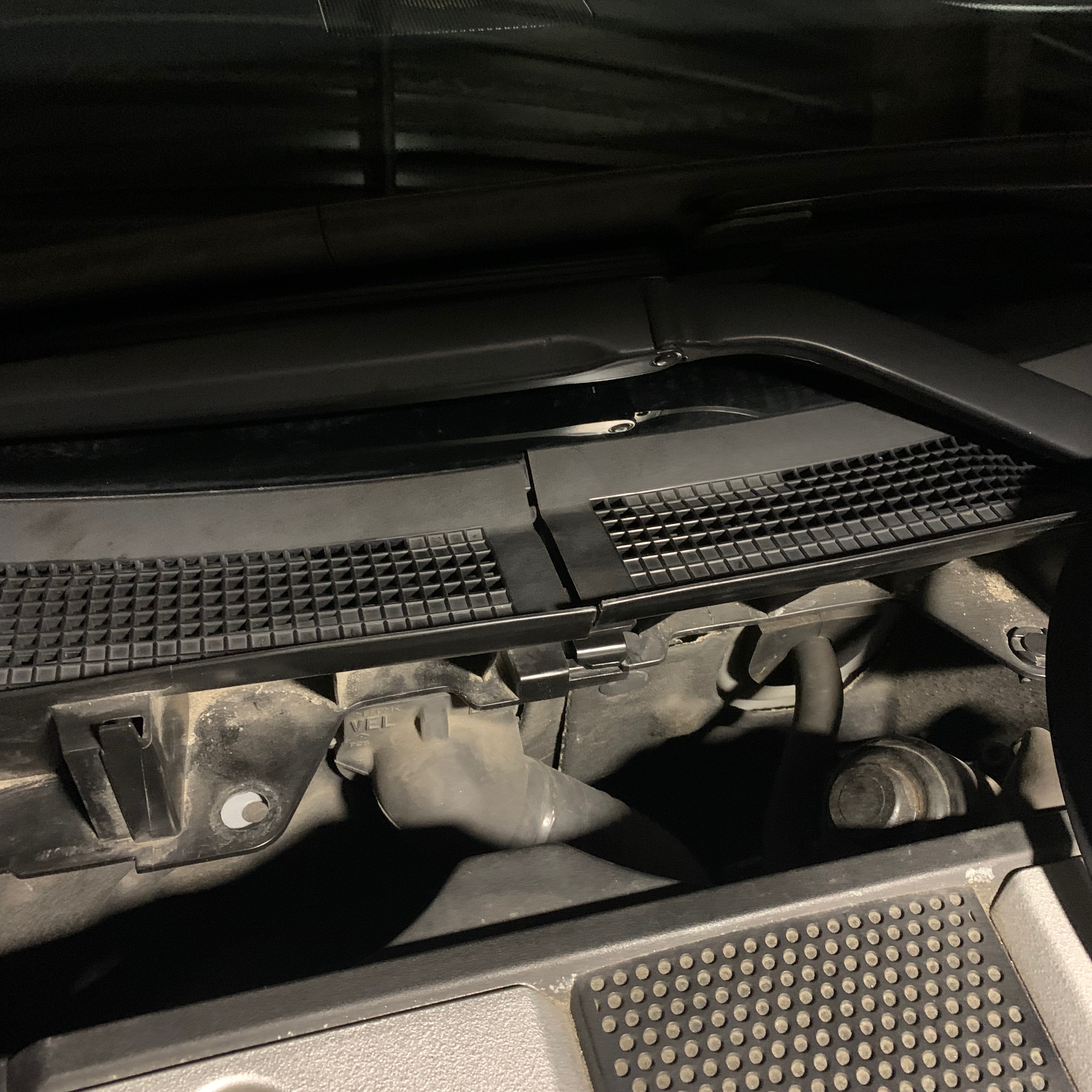

Ok, after some fiddling, I got everything lined up a lot better than it was before. The pawl still doesn't click in place thanks to the tabs the dealer bent and broke off.
Anyway, I'm thinking about running a piece of weatherproof tape across where the cowl meets the windshield. Any downside to this? It would be a temporary fix 'til I get the replacement RH cowl.
Thanks again for all the advice. I really appreciate it.

Tape shouldn't affect the 'well, you broke it not us' issue.
At worst - you can get used ones on ebay or from whatever pick-n-pull is nearest - the model G37 (or late G35) doesn't matter so there's usually a few in every yard. Plastic trim like that surprisingly isn't usually scavenged.
