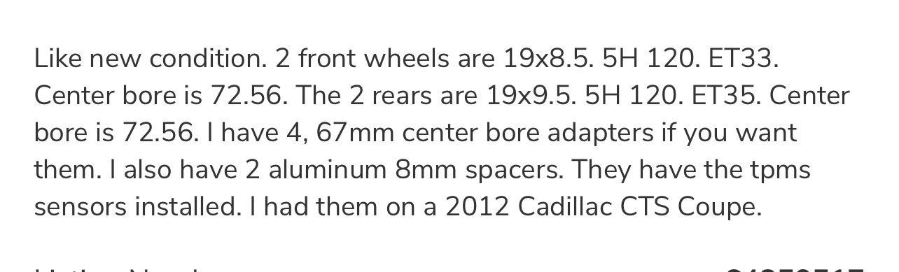

So I found these Rohana RC10 wheels for a very good price, but they are 5x120. Am I able to get 5x114.3 to 5x120 wheel adapters? Also it says something about center bore. Please let me know as I have no clue what “center bore” or “ET33” means.. thanks!

No. Bolt pattern is wrong. those are 5x120, you need 5x114.3.

Ahh okay. I seen there are adapters that change the 5x114.3 to 5x120, would those work?

In theory, yes. As long as you trust the build quality of course

Okay thanks, is the center bore important? Apparently most INFINITI’s are 66.1 and these wheels are 72.56? Would that be a problem?

You'll have to measure both bores prior to buying the spacer. Please know that these types of conversion spacers normally come at least +20mm offset and they need to be like that to accomodate the new pattern.
This means that they'll be pretty wide after the spacers.
I would say pass on these wheels, it'll take quite a bit to get them to fit right, vibrations will eventually happen.

Ohh okay. I’ll just stick to our bolt pattern haha, thanks for informing me about this!
