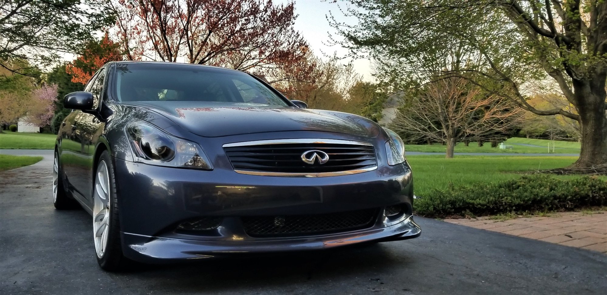

Yes, I did the swap. Direct fit unless you have the cruise sensor, then you need a few more bits.

Did you need to buy the grilles? z1motorsports tells me I will need the grilles. Also did you get a front lip for the bumper? If so which did you go with? Thanks for the reply!

There are no extra grilles, for that bumper the lower ones are molded into the bumper. The upper grille you re-use from your old bumper.
I got the OEM sport lip

Where did you get your OEM sport lip from? I’ve been looking everywhere and can’t find one. Except on Tunerzstore.com but I don’t know if it is a legit website

I bought it used.... they are pretty hard to find nowadays. You could try on the infinitiparts dealer website.
