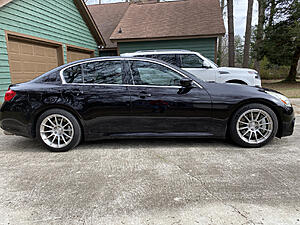

Old Jan 15, 2022 | 12:33 PM
ryanwhite74115's Avatar
ryanwhite74115
Joined: Feb 2015
Posts: 488
Likes: 40
From: Doom
Nope. Exactly the same height.
Old Jan 15, 2022 | 01:17 PM
Posts: 19,859
Likes: 5,148
OK, Ryan.
Fitment looks great in that pic.
looks great whats ur ground to fender height front and rear?
