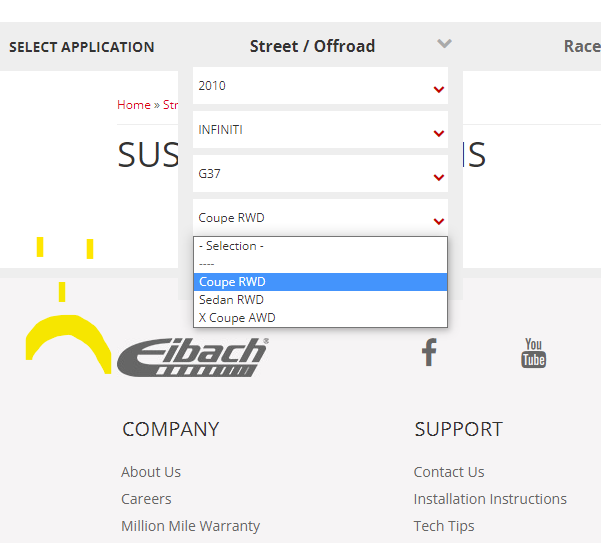

You are correct, my bad for not doing my homework. I do not see Eibach springs for AWD anywhere. Thought there were.

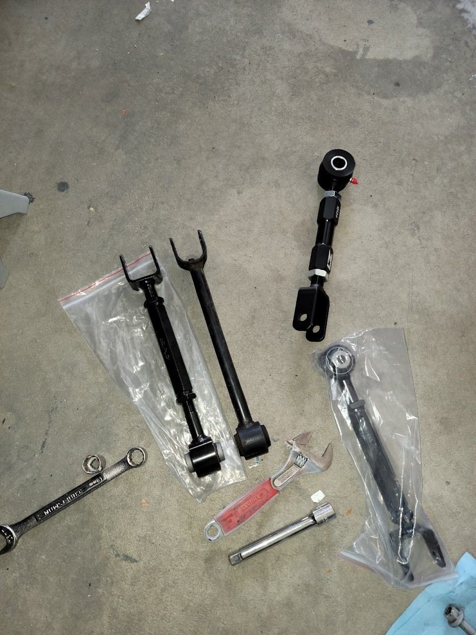

You're absolutely right man I felt the back end floating with the stock setup! I just got done tonight installing some SPC and Z1 rear control/traction/toe arms and their respective bolts. The previous owner had mismatched parts back there and no one could get the alignment right we'll see how it fairs after a nice alignment. While I was under there, I saw how pencil thin that rear sway bar is. I'm kind of appalled Infiniti did that, especially with a RWD-biased AWD system ?). Rear sway bar and Whiteline end links will certainly be next. Gotta replace the toasted rotors at some point soon too. Sigh.
