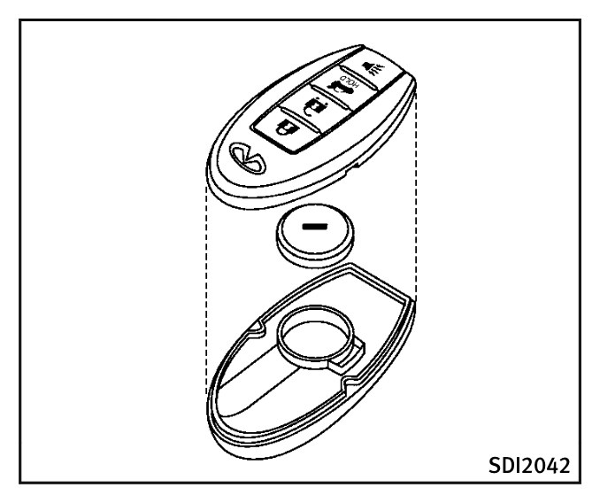

I drive a 2010 G37 & I recently replaced my Key Fob battery. Everything is working fine, However now I'm unable to open or close my vehicle manual with Key Fob in my possession (my pocket or hand). I reading that everyone is having Key Fob issues but i haven't herd this problem I'm having. I must be the only G37 owner who's having this problem because it's has never been talked about. Please help me out with this existing problem. By the way, my Key Fob was completely dead until I replace the battery. I could only open my door with the emergency Key that's provided within the Fob. Once I replaced the Battery, everything was back to normal except the mentioned issue. Looking for help. Maybe I need to reprogram my Smart Key? Who Knows? Please help.

So, when the battery in the fob was dead, were you starting the car by putting the fob in the "port" above the driver's left knee? And are you still doing that or can you start the car with the fob in your pocket?
Even if the fob has not had a battery in it for a long time the car should remember how to communicate with it. That is IF the new battery is good, the contacts have not been corroded or bent, and you're sure it's put in correctly (+ side faces the bottom, smaller disk towards the circuit board).

The battery is inserted correctly. The car started even with a dead battery. I'm only having this one problem. Most owner's probably wouldn't care as long as the vehicle Fob works correctly. I would just like to open & close my doors manual with key in my possession.
