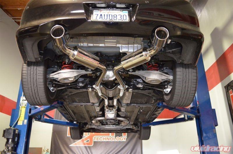

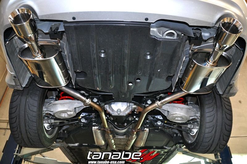

The kits that extend the exhaust are meant for the G37 coupes. Sedans have a completely different rear axleback setup. The clearances on the underside of the cars is completely different.
Coupe Exhaust
Sedan Exhaust
