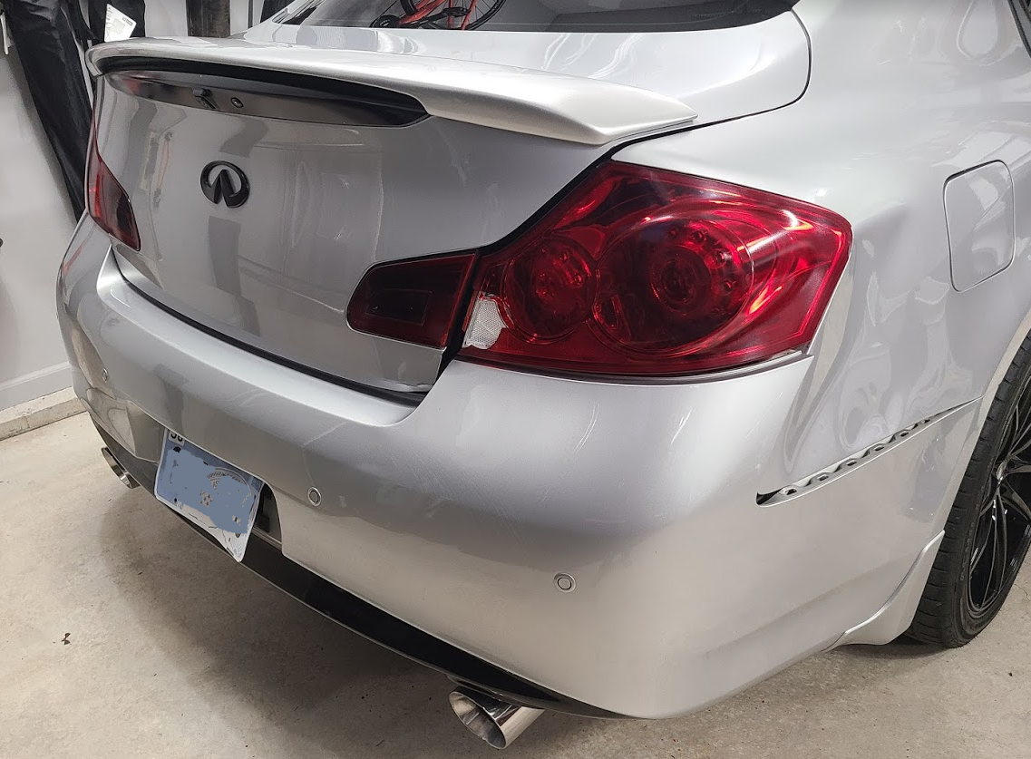

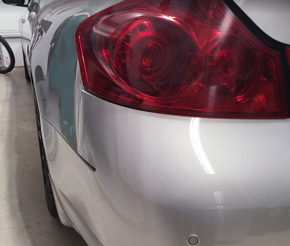

Anywho, I've attached some pictures. trunk floor is bulging upwards. Spare tire is not coming out. It is wedged in there pretty good. Doors seem to open a close okay. Just wondering what the outcome is going to be. Guessing that damage will need to be about $9K for it to be totaled (75% in state of Kansas). Taking the car later this morning to an authorized Infiniti repair shop with great reviews. I absolutely love this car but fear that it will never be the same no matter how good the repair is. It will always be stuck with diminished value as a result of the accident.
Initial questions/thoughts I have:
  • Can the quarters be saved or will they need to be replaced
  • Is there frame damage with the way the trunk floor is bulging up
  • Trunk lid as damage on the bottom corner. Wondering if they will replace it or try to fix it?
  • One of my custom exhaust tips is damaged. No idea how that gets fixed since it is not factory stuff.

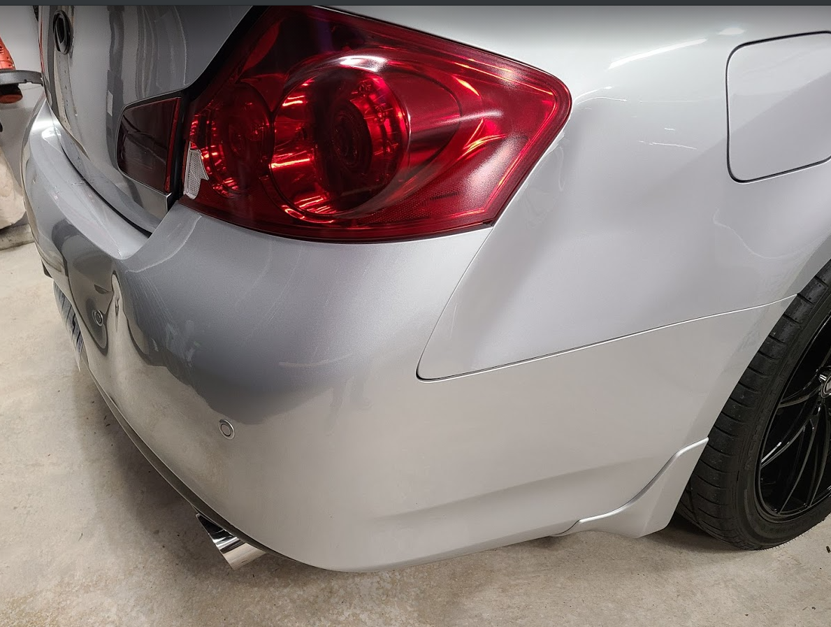

Quarter panel caved in a bit.
Trunk lid damaged on edge. Broken tail light and chipped reflector. Bumper is obvious toast.
Cracked tail light and caved quarter panel.

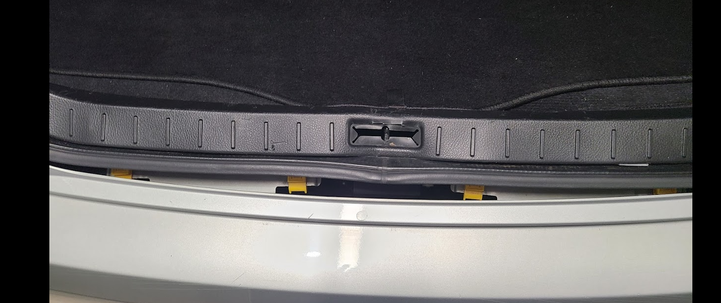

Trunk latch is pushed forward about a inch or two.

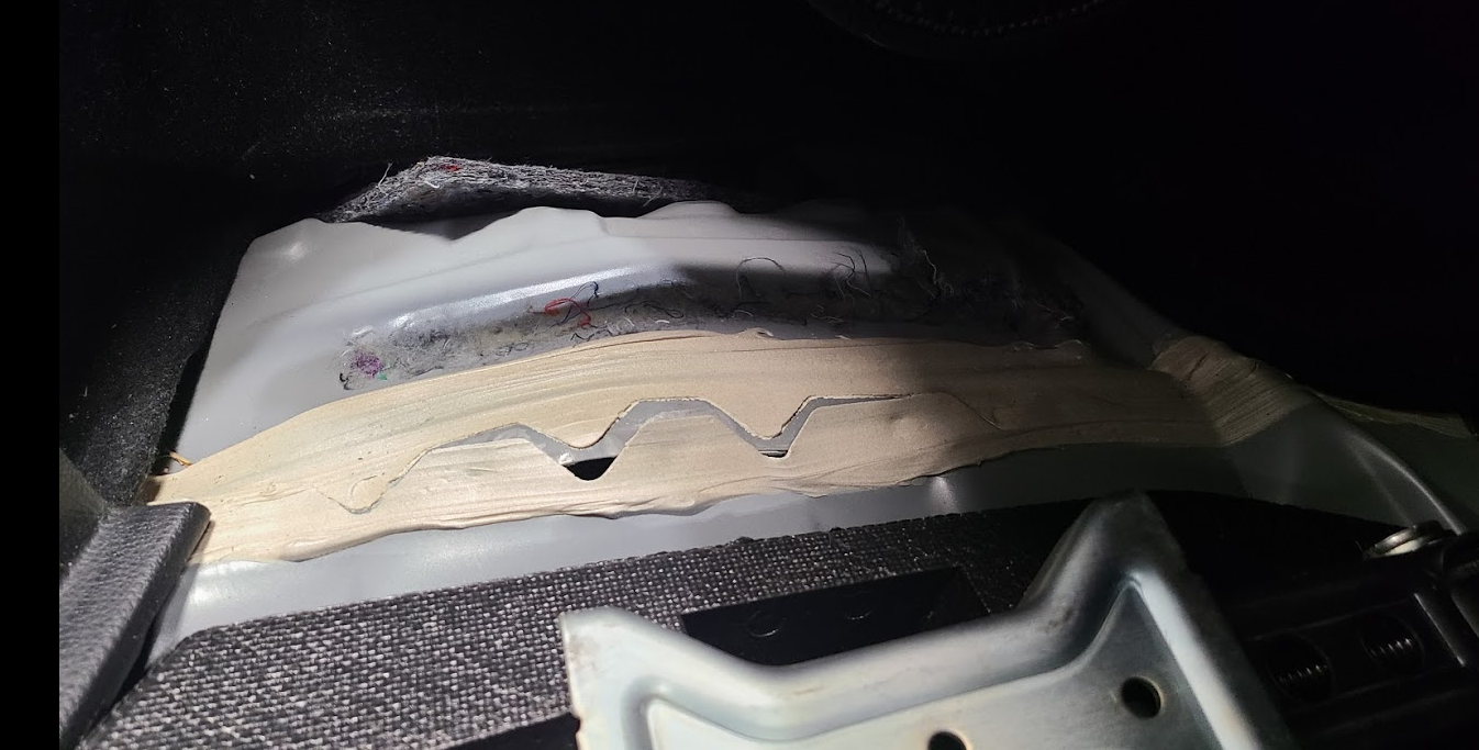

floor board of trunk is bulging upward.

The car is totaled for sure.
- The insurance estimate will be for the quarters to be replaced. However, if you have a nifty body guy you can get away with fixing them.
- The trunk floor will need to be replaced. Again, you can get away with pulling it on a frame machine.
- A new trunk lid will be needed.
- Estimate will be for a muffler OEM replacement which is more expensive than an aftermarket system

That is the perfect keeper car.... if they total it ......I don't see a crease on either rear quarter panel . The bumper opened like a mouth and all or near all the tabs look fully intact ........A top notch paint-less dent repair facility can get those rear quarters near perfect (Minus the chipping at the top of the right rear taillight ) same with the trunk floor . A salvage title means squat if you are willing to drive it into the ground all while you collect on the total and pay it off with the money.....you are left with a mechanically speaking great car (engine and tranny) and a car that looks almost the same ..for free ...

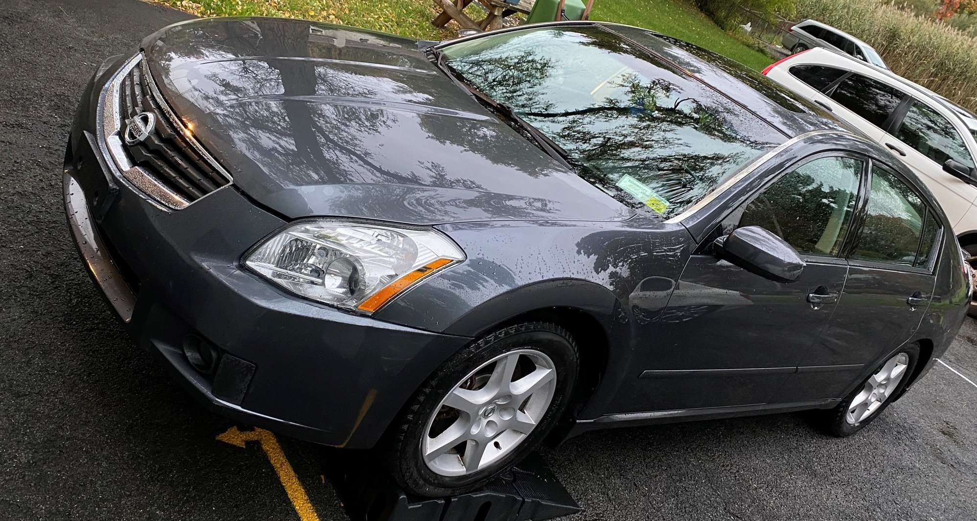

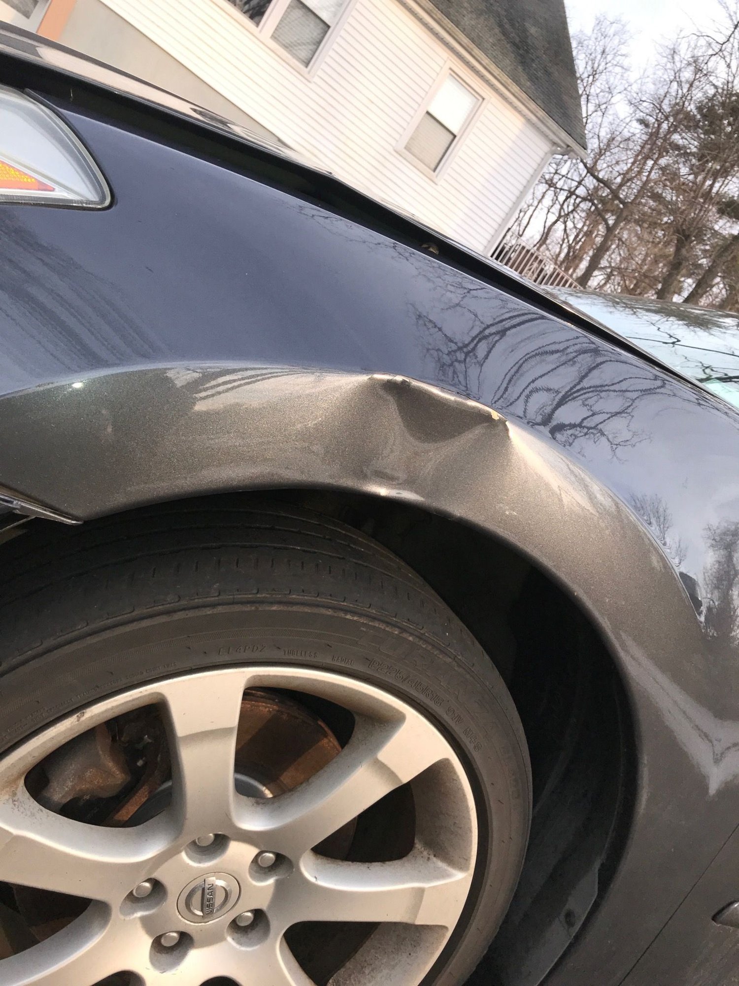

Bank the car payments you would have made each month on it along with the savings of dropping the insurance to liability and drive the car until it's dead , years from now or pass it onto your Daughter which ever comes first. I just did this same thing on my other car .....a 2007 Nissan Maxima I've owned since new with 77,000 miles ....I hit a deer in February , the insurance company totaled it out and gave me $7,100 minus $600 to keep the car . I've spent $390 in parts from local sellers of parts since then ....A Hood , Left front quarter panel , front bumper & grill . Lower control arm , outer tie rod & stabilizer link . All DIY and some detailing take off the winter wheels & it's hers...My youngest daughter gets her permit in 7 months and has a car .

Your accident is did not touch the structure of your vehicle. His car can't be PDRed, the rear fenders folded in. It needs to go on a frame machine and have the rear floor board pulled as well as the rear fenders. The correct way to fix it is to cut out the rear fenders and weld in new ones which is the reason why is estimate is over 12k.
