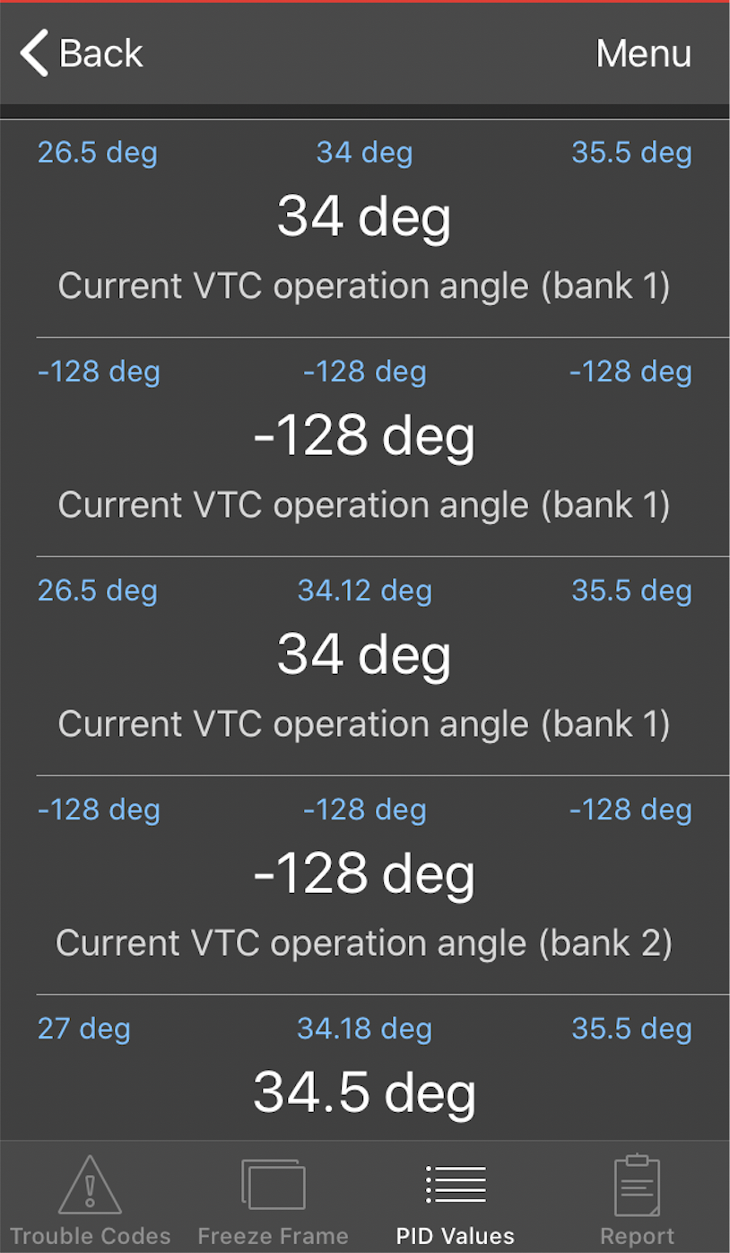

Originally Posted by Hugh Jorgens
So...oil pressure loss to the point where the cam phasers don't work properly doesn't set a CEL in these cars?
What a weird fu##ing car...
Actually it does: The codes are: P0011, P0021 and P0524
Originally Posted by BULL
My apologies (talk to text)
These phases are in charger of adjusting the cams in an advanced position or retarded one. OBD fusion has a plug in to check your cam angles.
To my understanding these angles should change with rpm from 0-127 degrees. I currently have my bank 2 stuck at 127 degrees and I suspect this is your issue as well.
You should look into OBD fusion to monitor these angles.
I wouldn't worry about bank 2 always showing 127°.
On my car, both OBDFusion and Torque Pro show the same "static" value and the car runs excellent with no CELs. Bank 1 changes as expected.
It seems like there is a glitch in the ECU and it doesn't update the value when requested by OBDFusion or Torque Pro.
In the next few days, I will dig out my AutoEnginuity scan tool and see what it shows.
Good to know. My car runs great for the most part until it triggers cat codes and that's where I can feel the sluggishness that some here experience. A clearing of the code restores everything back to normal.
I included this due to the know issue with the phaser slipping, then seeing my cam advance is on bank 2 and the P0430 which is for bank 2 I assumed the phaser was stuck being the culprit for this.
However if I can't sufficient info on this reading then it will stay like that.
AutoEnginuity (with the Nissan/Infiniti OEM expansion) shows a static value -128° for VTC operation angle on bank 1 and bank 2.
BUT also shows the actual values of around 34° for bank 1 and 2.
I suspect the static values might be from some left over code from the exhaust cam variable timing on the HR engine.
Based only on observation, it seems like sometimes the diagnostic coding doesn't remove features that are removed from engines.
