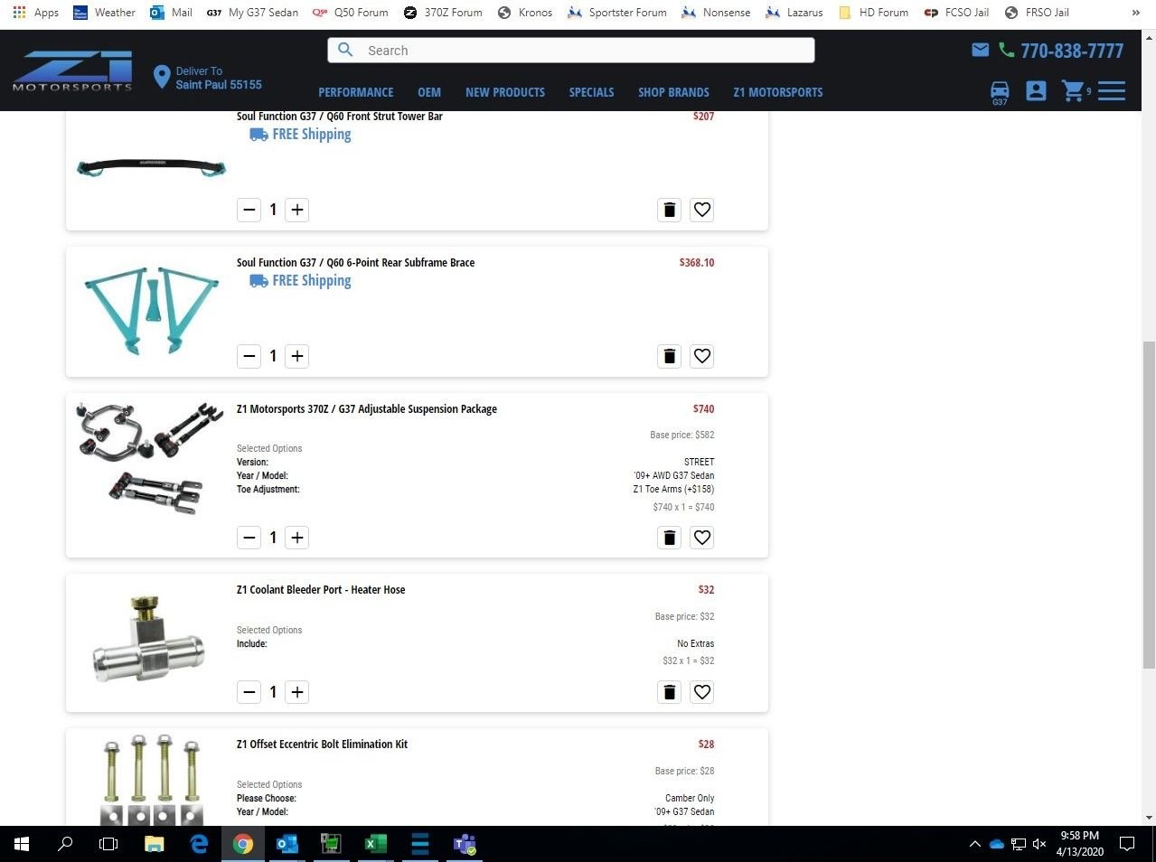

So after installing true coilovers, what of the above pictured list would be required/helpful additions to the true coilovers once I get them installed? I know rear camber arms will help, but are front upper control arms required for a mild drop?
