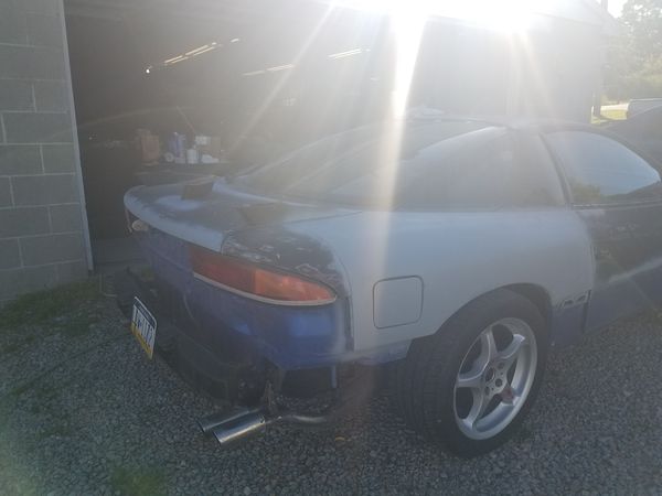

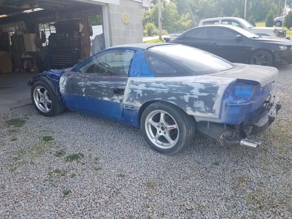

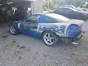

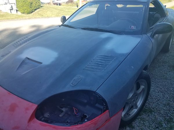

Due to a few different things as well as being in my own head on my bodywork I took a little break from the car. Got through some things and got a little kick of confidence so I got back into it today. Did a lot of block sanding and shaping to get things right on the transition of overfender to sheet metal then laid some high build primer down to help me see other imperfections. I only worked the drivers side today because it has been my trouble one, but put primer on the passenger side too as well as repair areas on the hood.
Going to lay some guide coat and do some more blocking tomorrow to hopefully get the last of the actual body work done before I just need to finish all the sanding.
Pics aren't the best. The sun was setting and it was perfectly in the wrong spot for a good photo for where I was parked

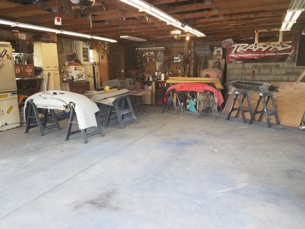

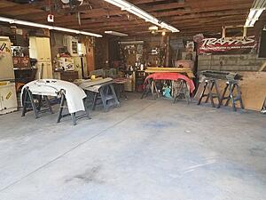

I guess everyone either gave up on their quarantine projects or went back to work. :lol:
Mine is in 1000 pieces
Plan is to lay primer today on most of hte body and certain pieces, then sand, and hopefully lay paint tomorrow, then reassemble on Thursday.

Nah not all of us lol.
Mitsubishi 3000 Gt? Nice work man, can't wait to see it finished! Those are very cool cars.
Yessir. I changed my plans slightly. Realized I was pushing myself on getting paint laid by tomorrow so I slowed my pace and just laid the build primer and started sanding it back off today. Got a lot of it sanded. I'm actually shocked at my body work looking good. Tomorrow I'll finsih all the high build primed stuff and then hit the rest of the stuff with 320 too that was only hit with 180 so far. Depending on time frame I may wet sand , but as it is the 320 has everything nice and smooth.
I can't get my paint til tomorrow anyway because the paint shop was short on a toner needed for my mix so I even if I didn't already decide to wait til Thursday to spray then that decision would have been made for me.
I'll post up pics when it is painted and back together.
