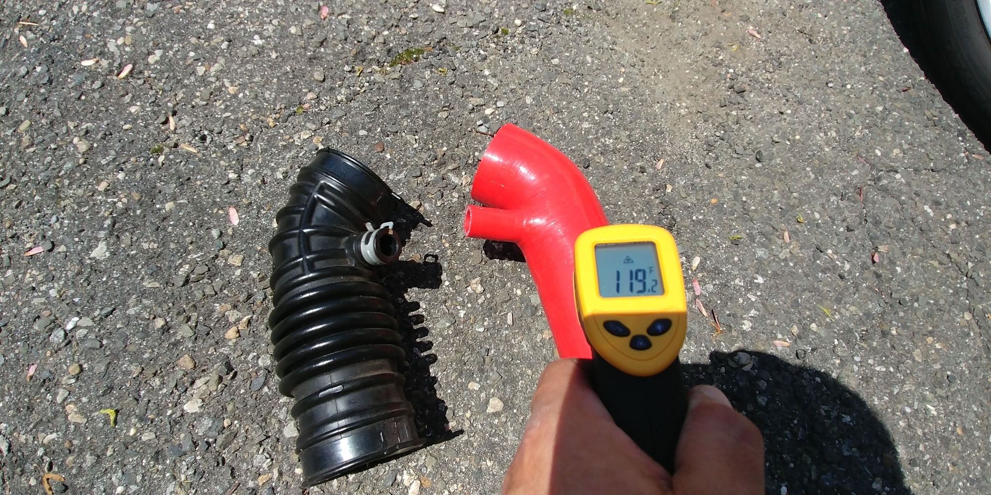

So I did this little experiment seeing the temperature difference with both tubes. This was just a simple test, did not factor in any other complicated variables. I installed one side with the mishimoto and left the other side oem. After driving 40 minutes I took temperatures of both tubes with an infared gun. The mishimoto silicone tube read 5-7 degrees lower than the oem. The results were already going to be obvious to some but I wanted to put it to the test and was curious. 136.6

I am a bit skeptical here. what difference would the temperature of those tubes make?
the air passing through these tubes is passing at a fast velocity. It should not effect passing air's temperature a whole lot, right?

I'm not sure this is proving anything, but then again... lower temps for a component of the air intake system seems more desirable than otherwise.
What if you shot the exact same spot on each side, but hit the MAF housings instead? Or the TB's?

Don't forget that there's both conduction and radiation transferring thermal energy to air passing through the tube. Also, the greater the temperature difference, the faster heat transfer occurs. Any reduction in delta T is a good thing.

Just so y'all know I did point the infared gun throughout the whole tube for both sides, top, middle and bottom. The mishimoto read lower in all areas than the oem.
And just for kicks I put out both tubes side by side in the sun for 30 min. Obviously black attracts sunlight more than red but it was quite a difference.

I actually did intake temp testing via the MAF sensor reading with the mishimoto tubes vs oem and they take wayyyy longer to heatsoak than OEM. With my OEM they gained about 15 degrees idling for 60 seconds once at operating temp and the mishimotos only gained about 6 degrees. The differences were even greater the longer I idled to an extent. They seemed to level off around 180 for both but again the mishimotos took forever to get there. For comparison, my r2c intakes heatsoaked quicker than OEM setup. I think post maf tubes with r2c drop ins is the best bang for the buck setup for our motors.
