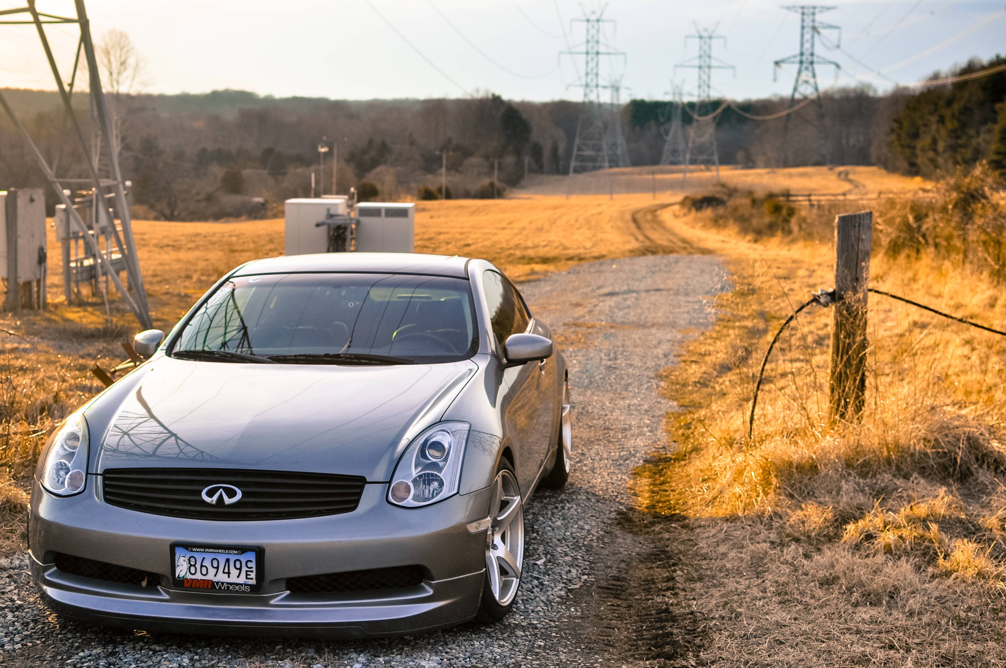

What kind of finish are you looking for? Dip is mostly matte but you can make it glossy too with some extra work. Here's my old G35 coupe with a plastidipped grille, nothing fancy, just straight rattle can. Cleaned it off with a microfiber and did 5 even coats of dip. Turned out great for a $5 job. Held up for 2 years with no maintenance or refinishing.
For the emblems, dip is probably easiest.

Looks great! No problems over the years with cleaning?
I would like to go matte but not the super dry matte look (if that makes sense). Almost a semi-gloss look so it blends with the cars clear coat a little better.

Nope, I've had dirt and bird poop on it and I just wipe it right off with soap and water and a microfiber cloth. For a smoother shine you can add some coats of glossifier.

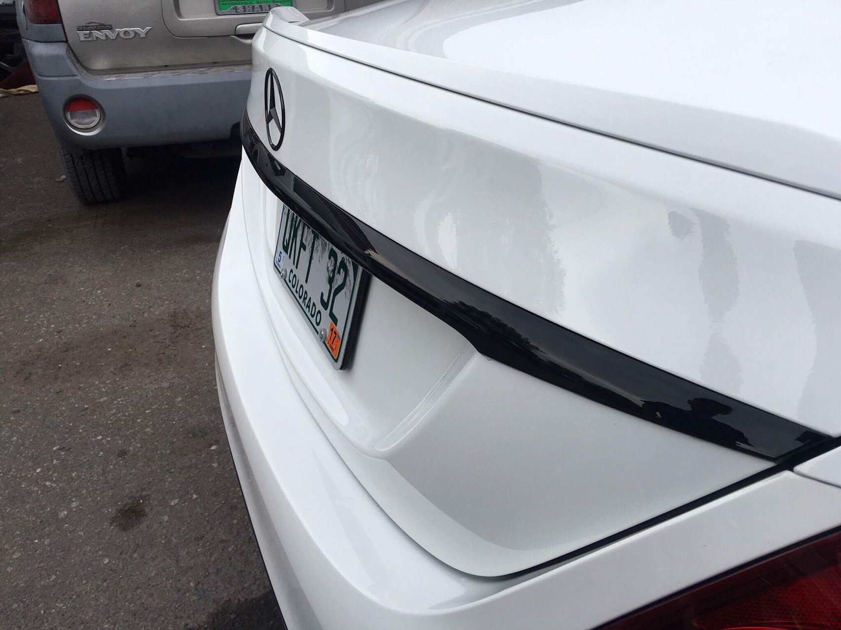

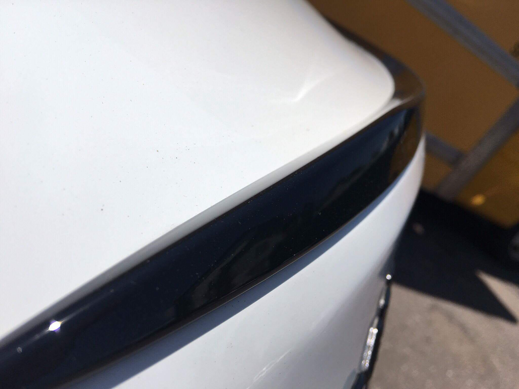

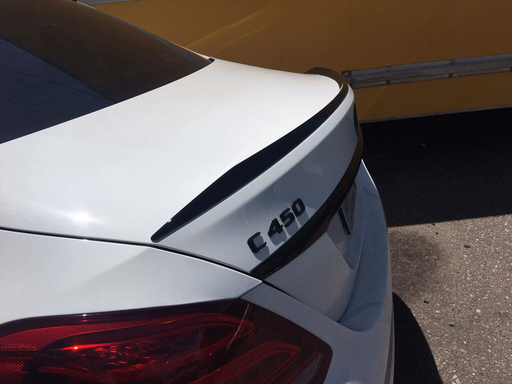

-I'm getting my grill (except emblem) and window trim done.
-gloss black
-5280 dip co. In Colorado.
-$85 per side on window trim and $145 for the grill= $315
Here's some pictures he sent me of his work on a Mercedes.
Plasti vs Dupli vs Wrap for grille and trim? Opinions!-photo647.jpgPlasti vs Dupli vs Wrap for grille and trim? Opinions!-photo809.jpgPlasti vs Dupli vs Wrap for grille and trim? Opinions!-photo712.jpg

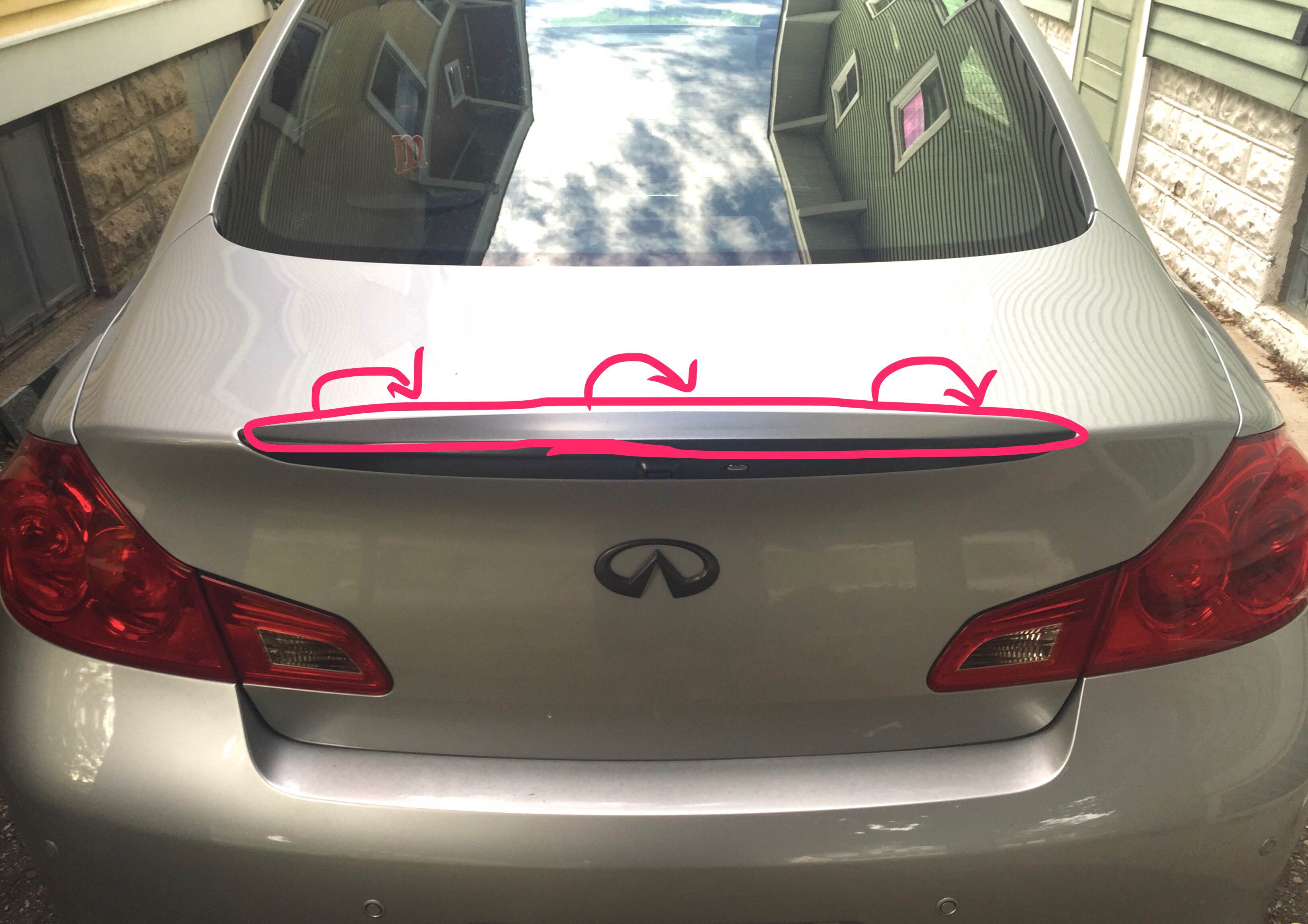

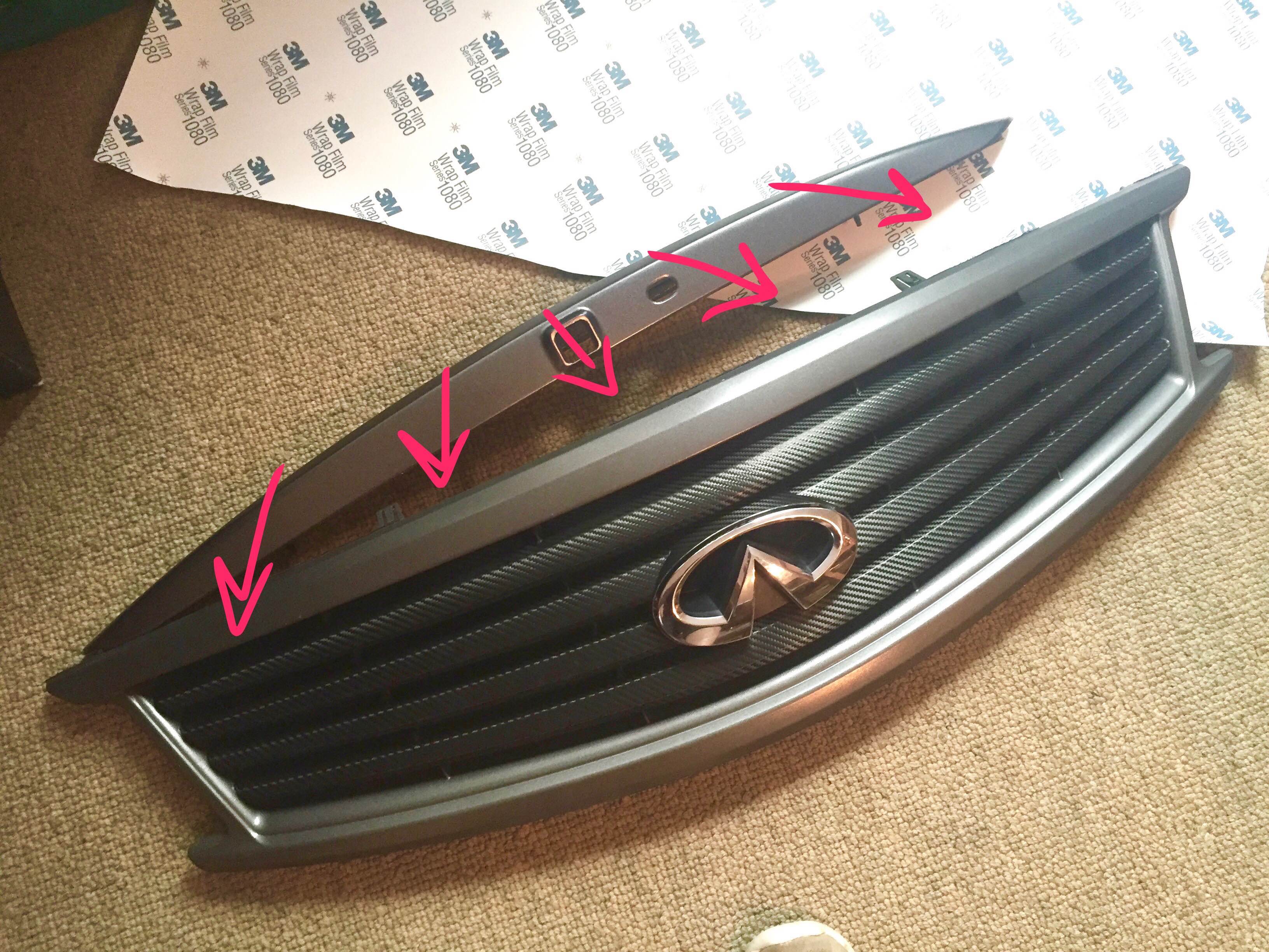

Well first things first if your not doing it already, take the chrome spoiler off the car. I did this a while ago, but if memory serves I cut a strip of Vinyl about and inch and a half wider than the piece on all sides. I Always start by laying down the flattest areas first and going from there.
So... started by smoothing the vinyl onto the top portion of the spoiler(area pointing up at sky when on the car), then trim and tucking the front edges under - toward the front of the car. *** make sure to clean the underside of the edges with alcohol as this is where the vinyl sticks after you tuck it under and acts as an anchor when you start to stretch the vinyl.
Next start stretching the vinyl from the center of the spoiler down and around the back and over the backup camera hole - you'll need some heat here to get the vinyl to conform. Once that area is laid down, begin pulling bottom edges down and slightly away from the camera hole. SOME heat is required especially around the camera hole, but use it sparingly, most of the stretching I did was with little to no heat especially as you get further towards the outside edges.
Then same deal, trim the edges and tuck them under. For the camera hole and trunk button opening, apply heavy heat to the holes, and push the vinyl inwards (I used a balled up microfiber), then trim out the inside when cool.
Lastly, go over the whole area with heat to activate the glue. If you have a few little bubbles here and there give them a few days in the sun, they will most likely go away on their own. If not, pop them with a pin and smooth them out with a heat gun.
Here's a few images to help explain what I'm going on about..
Attached Thumbnails Plasti vs Dupli vs Wrap for grille and trim? Opinions!-img_0890.jpg   Plasti vs Dupli vs Wrap for grille and trim? Opinions!-img_0872.jpg

Looks great! From what I know this stuff is pretty new so not a lot of places are offering it yet. I might just have to invest in a sprayer and do some experimenting...

It's available in matte, satin or high gloss, and can be sanded, buffed, polished and waxed like standard clear coat. Pretty awesome if you ask me.
