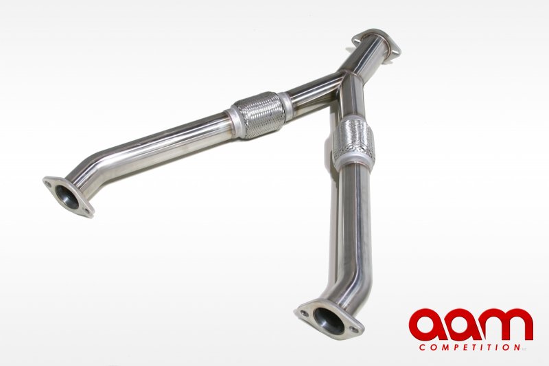

Dont be fooled we do, I have a "RWD" cataback on my X Coupe. The thing you need to rememer or look at is the design of the Y Pipe.
If it looks like a U it will fit First pic and is on my car( ARK Grip), if it looks like a V it will not second pic.
Attached Thumbnails Mods for improving G37x Performance?-arkxpipe.jpg   Mods for improving G37x Performance?-ypipe-no.jpg
