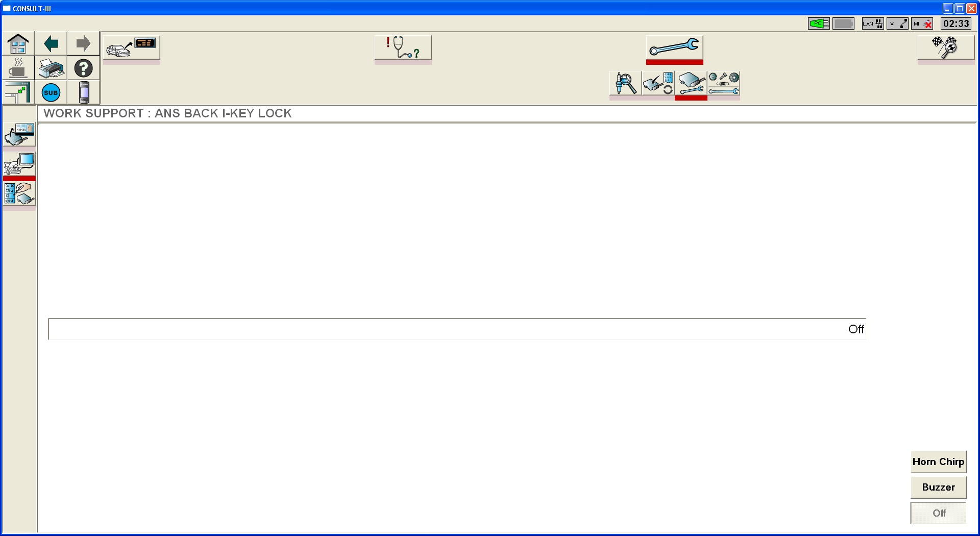

Using Consult 3 you can select the answer back on locking/unlocking the car.
You can select horn, electronic beep or turn off the answer back.
You can also configure the hazard lights answer back on locking/unlocking:
lock/unlock, lock only, unlock only or you can turn off the hazard lights answer back.
The option is under Repair->BCM->Intelligent key->Work Support menu.
I was playing with this options just 2 days ago on my G37 sedan.
I am using a cheap chinese clone consult 3 interface and Nissan consult 3 software installed on windows Xp virtual machine. For some odd reason, consult 3 work only on win xp.
If you know someone who have consult 3 you can ask to change the settings. Or just go to a dealer and ask them to make the settings for you. But i think they will charge you for that.
If you want, i can post a screenshot with the menu and options there.
Now this is why I love the internet. Ask some odd random question, and someone knows an answer. I have a buddy who is a mechanic about an hour away, I'll see if he has one. Thanks, and that screen shot may help too.

here is the screenshot
BTW!!!
Maxima, Altima, even Versa have the same option. I enabled the beep on my Tiida (European version of Versa)
Attached Thumbnails Electronic beep instead of honk when locking?-answer-back.jpg
