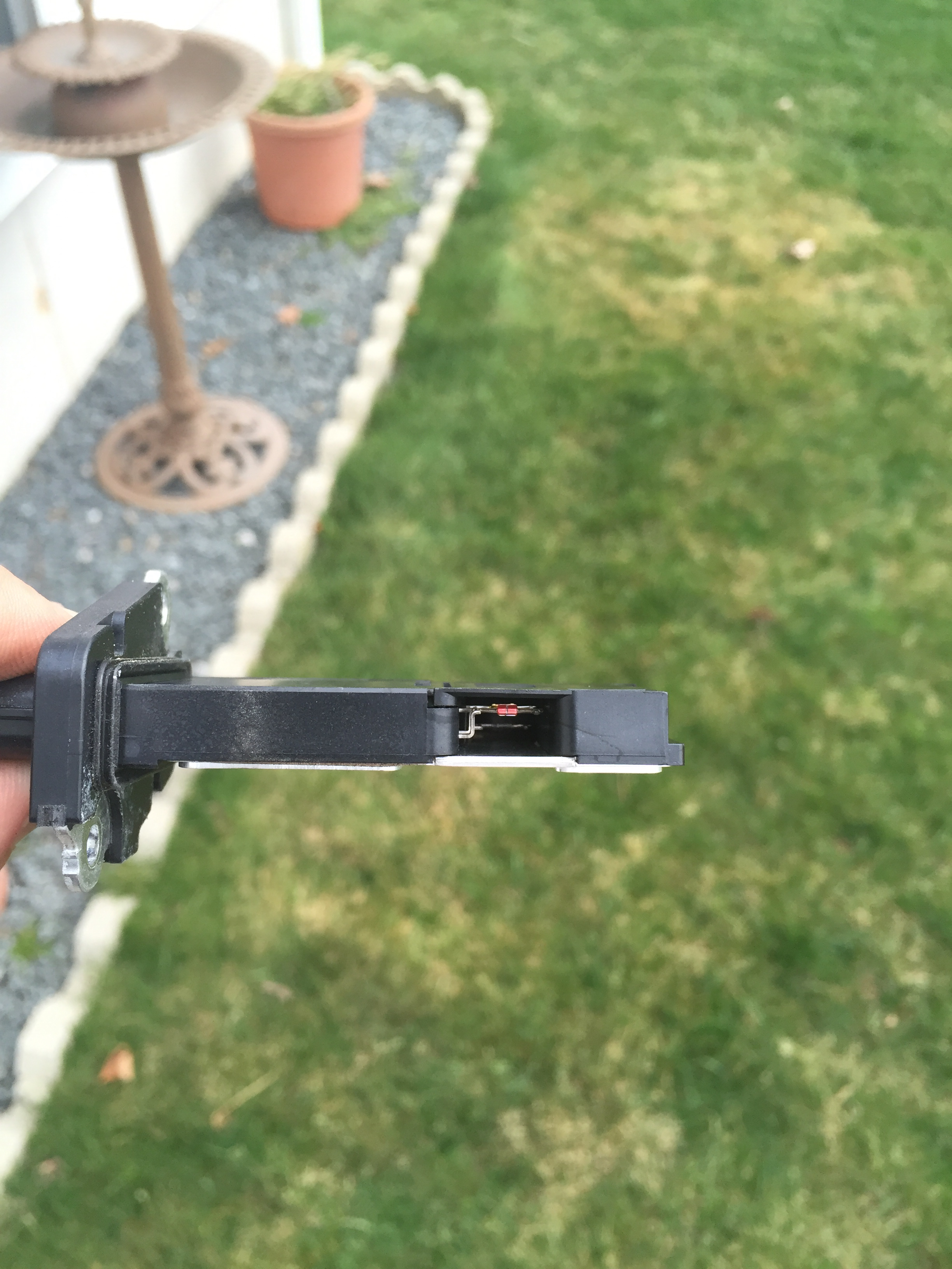

Just pulled it out, what am i exactly sparying tho?? Both sides? Or just the little opening on the bottom???

I dont think im going to just cleaned the sensors and re installed now going to let dry, discoinected the battery to do reset aswellMPG Has Decreased significantly-photo911.jpg

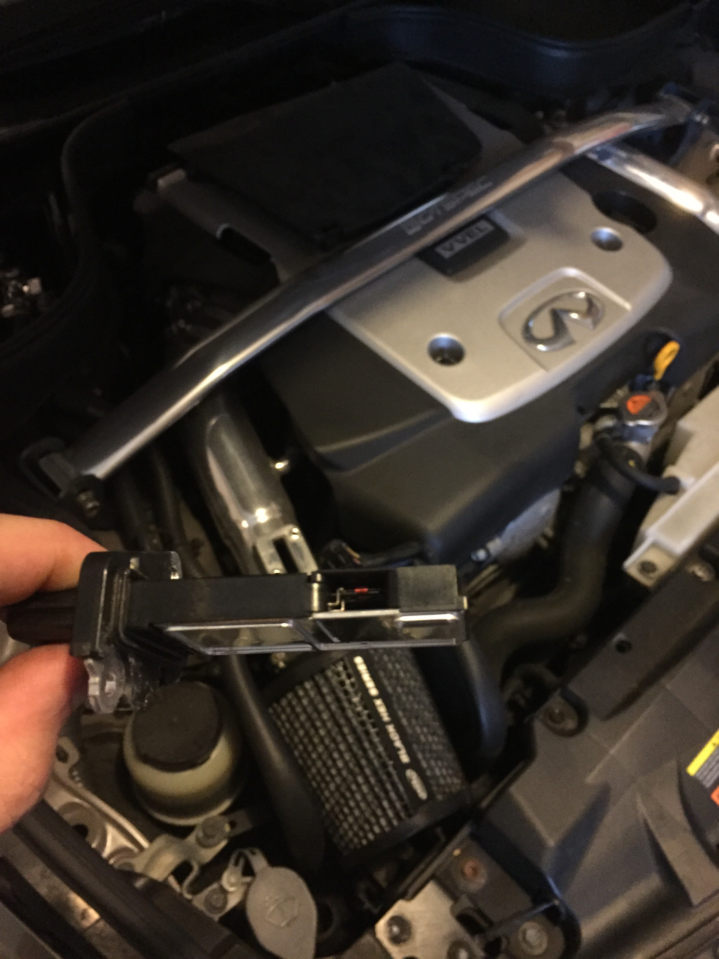

MPG Has Decreased significantly-photo824.jpg I'll update in a few, gona go for a quick drive on the highway. Question tho, after resetting ECU, am i supposed to drive the car hard? Or? Explanation please

Went on a little beat run, notice a little increase in throttle response. Set the cruise control on 80 in 7th gear(Manual Mode), on a little incline was recording 25 MPG sooo hopefully it will be atound 28 at 67
