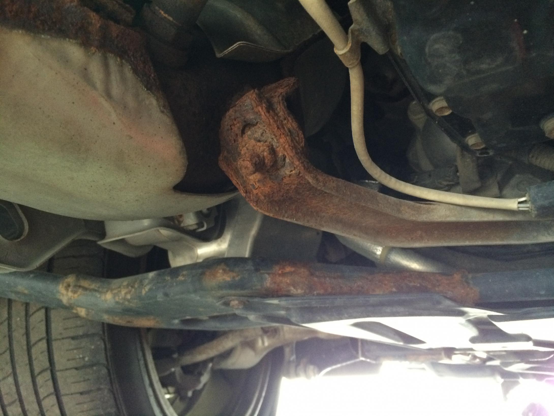

When I brought the car to my mechanic to have the power steering rack replaced, he told me I need my undercarriage done cuz there's this growing on I think the lower subframe if I'm not mistaken, correct me if I'm wrong. I will google to where I can find POR15 in canada, and it seems like its canadian.

unless the bottom of your car is stainless steel theres no such thing as factory or aftermarket rust proofing. road salt will eventually eat away at whatever you spray on the underbody to protect the chassis from rust. even aluminum can form corrosion wear from electrolysis due to dissimilar metals touching each other, such as a steel bolt or nut fastening an aluminum part such as the subframe or control arms. you guys in road salt hell are forever doomed with underbody corrosion.

What you can do is buy some manual pump deck spray, normally comes in 2 Gallons size or bigger. Then buy some gallons of concentrated Salt away liquid or equivalent salt remover normally sell by boat store etc... Spray the undercarriage before winter and don't rinse it.
During winter, after you go to the car wash with undercarriage cleaning capability, then spray some more salt away remover underneath.
Prevention is the key!
If rust is already formed, you can buy rust neutralizer or encapsulator from Eastwood company.
http://search.eastwood.com/search?w=rust%20encapsulator
Just use a steel brush to remove some of the rust that can be dislodge and spray some brake cleaner and wait until it is dry. Then apply the rust encapsulator . If the rust is on the suspension Lower Arm, use a liquid type rubberized rust encapsulator. You need paint brush to apply this. I highly recommend buying a cheap disposable painters drop cloth, since this really sticks to your garage floor.
If rust is a bit harder to reach, buy the rust encapsulator in a spray can. (Non rubberrized). I recommend buying both just for flexibility...
Be careful not to apply this on the bolts. It will be harder to remove the bolts if you need to remove them.
Make sure you buy the black color rust encapsulator and not white or silver! LOL!
Hope this helps...
