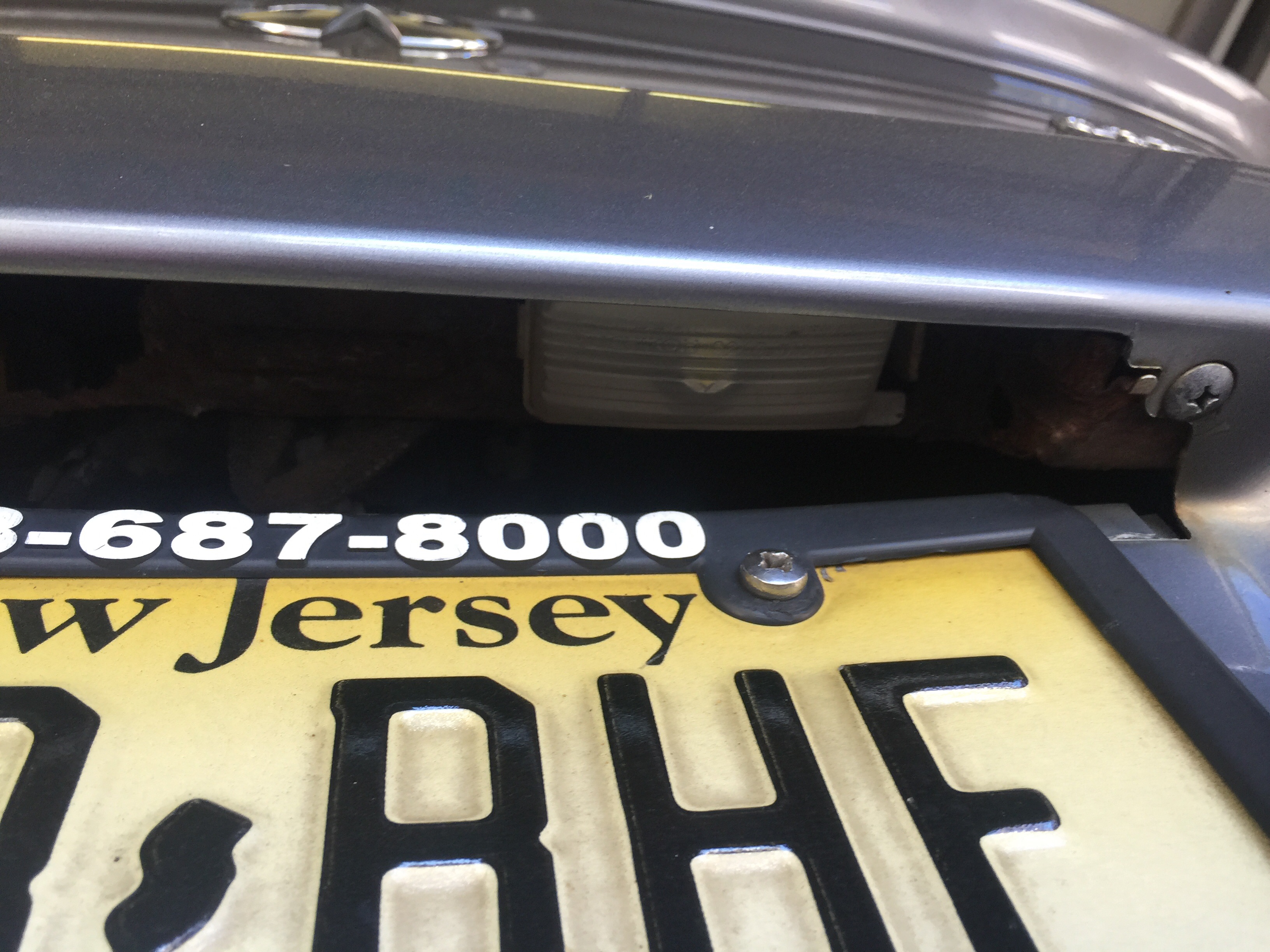

Can someone please help me find this part number. It holds the rear license plate lights in place. It rusted out and fell out. It has 2 screws holding it to the bumper as you can see one in the picture. I had to tuck away the other light because it has nothing to keep it in place

Here is the side that is missing.

I don't have the part number in front of me right now but you probably want to find an alternate resolution for this.
The bracket for my G35 which would probably be the same for the G37 is almost $50. and it's only a piece of metal in the shape of a U..
It bought a cheap LED light from ebay for $9.00 and replaced the original light.
cheaper and looks better too.

I have led lights also. The problem is the bracket got rusted and fell apart. I need the bracket. I can't believe that's 50 dollars. Wow

I just cut a small piece of treated wood and put it in there and screwed the LED's to the piece of wood.
If you still want the bracket, I think it is:
96220-JK05A & 96220-JK00A
Directly from Nissan/Infiniti they are $70+
2012 Infiniti G25 Sedan OEM Parts - Infiniti USA eStore
Amazon a little cheaper
Amazon.com: Infiniti Genuine License Plate Lamp Bracket 96220-JK05A G35/37/25 SEDAN: Automotive Amazon.com: Infiniti Genuine License Plate Lamp Bracket 96220-JK05A G35/37/25 SEDAN: Automotive

Thanks a lot bro! For some reason I could never pull that up on all the part sites.
