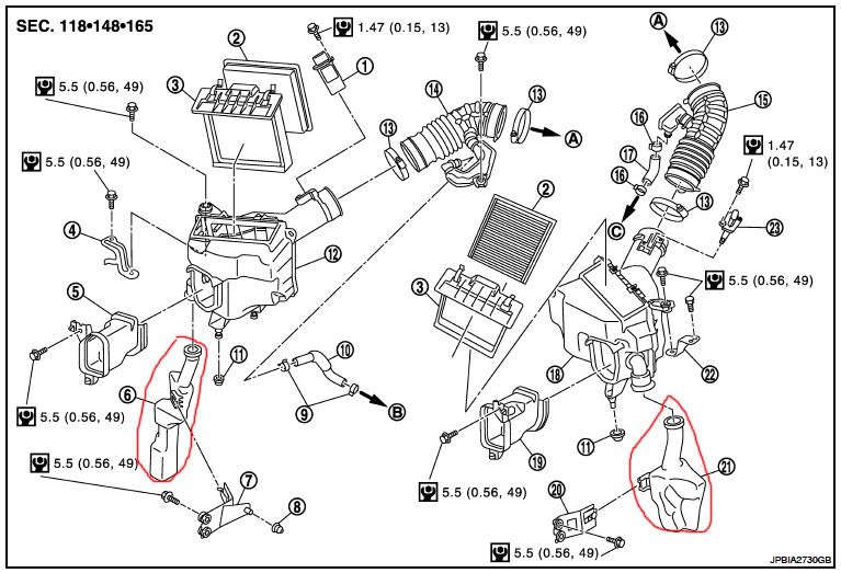

I also have another question ive been meaning to ask for a while back when I put in the air intake. I wasnt sure if I was supposed to remove this piece or of its significance. What does it do and how do I take it out? Its on both sides of the car way down there.

Any idea what that piece is for in the second set of pictures?

Haven't a clue. Maybe something that attached to the old airbox?

That piece you were asking about is a resonator for the stock air box, each side has one, not needed but I would keep them in a box in case you want to go back to OEM later on.

could they be resonators that connects to the stock airbox like the 370z..
Attached Thumbnails Noob Question: Did I put my engine cover back on right?-diagram1.jpg
Ahh that's what it looks like. I left it there originally cuz I didn't know if it served another purpose that's important. It looks like it's just a clip that holding it in place too so shouldn't be too bad to get rid of it!

OEM air intakes in most modern cars are designed with a Helmholtz Resonator in the mix, to smooth out the resonance effect of air flow into the valves. Removing this is part of the reason why aftermarket air intakes are so loud.
https://en.wikipedia.org/wiki/Helmholtz_resonance
