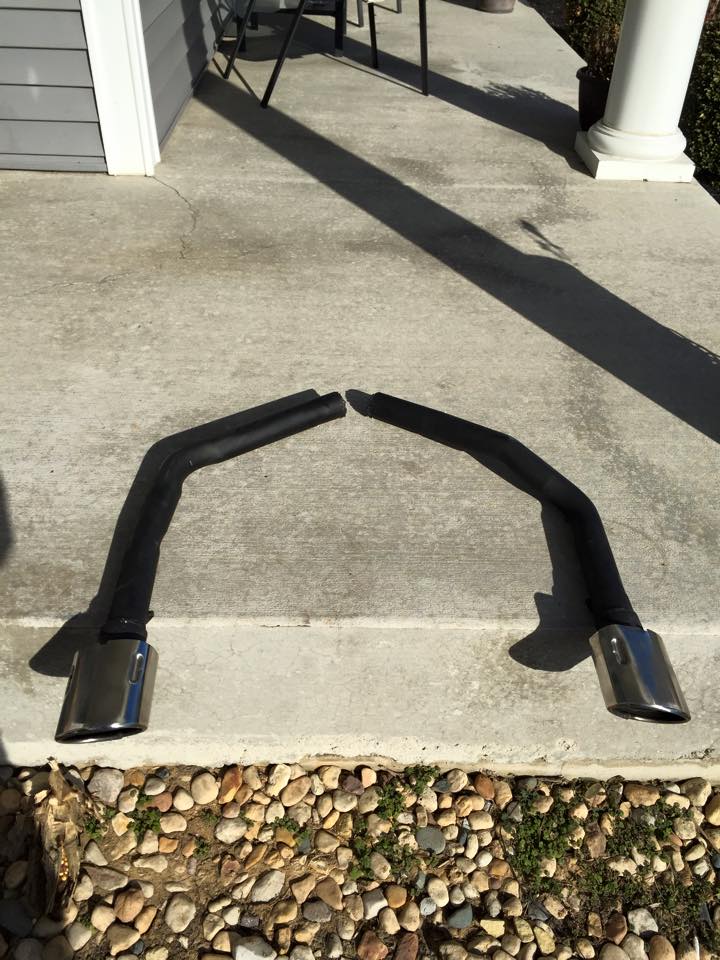

I'll sell you these for $200 if you are interested, that way you can keep your stock mufflers if you ever want to go back...
Thanks for the offer but I went to get a quote after work today and for $200 I'm going to get the 2 flanges piping and 2 stainless steel tips. Hopefully it turns out nice for the price I'm paying.
