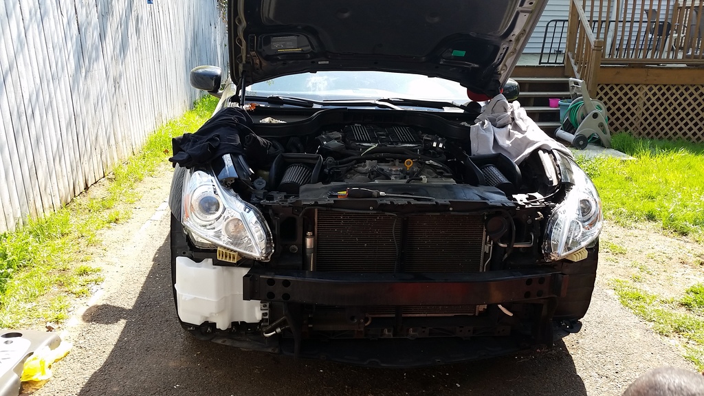

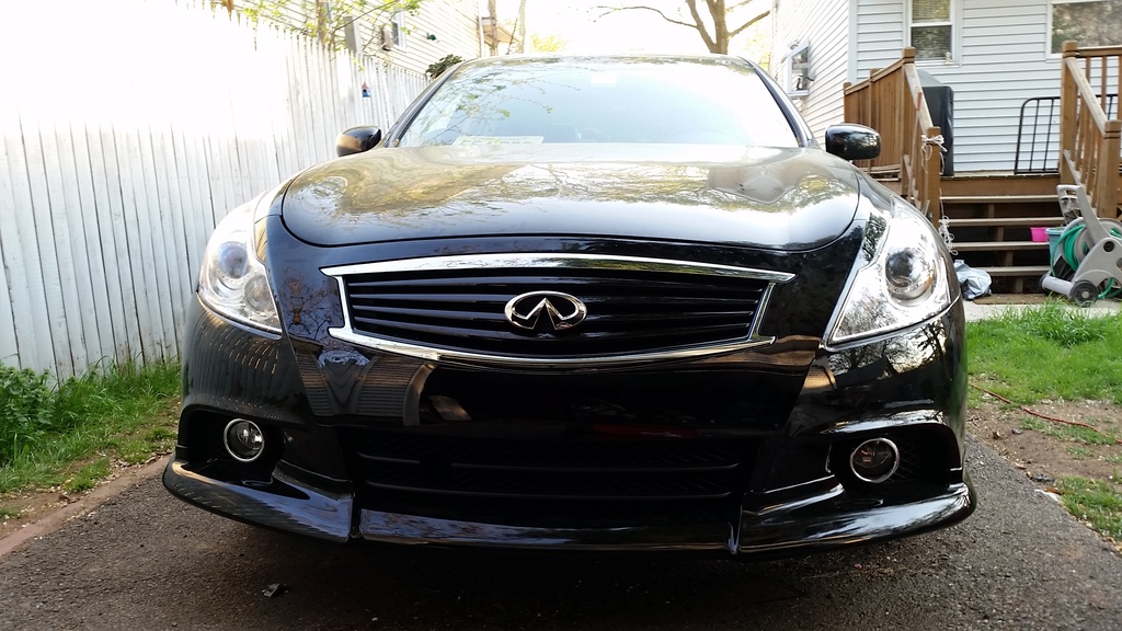

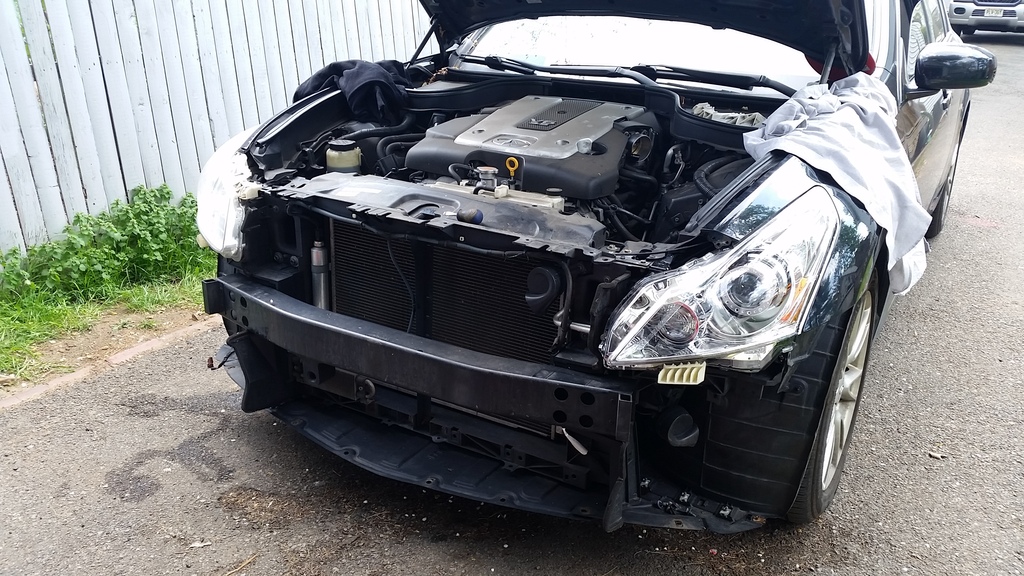

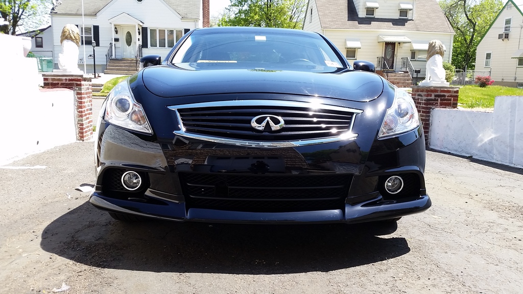

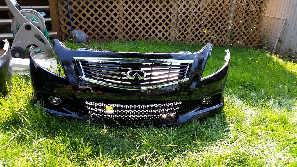

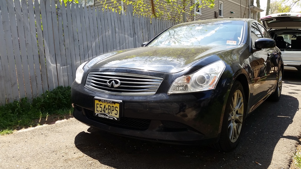

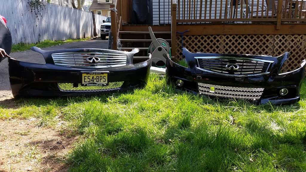

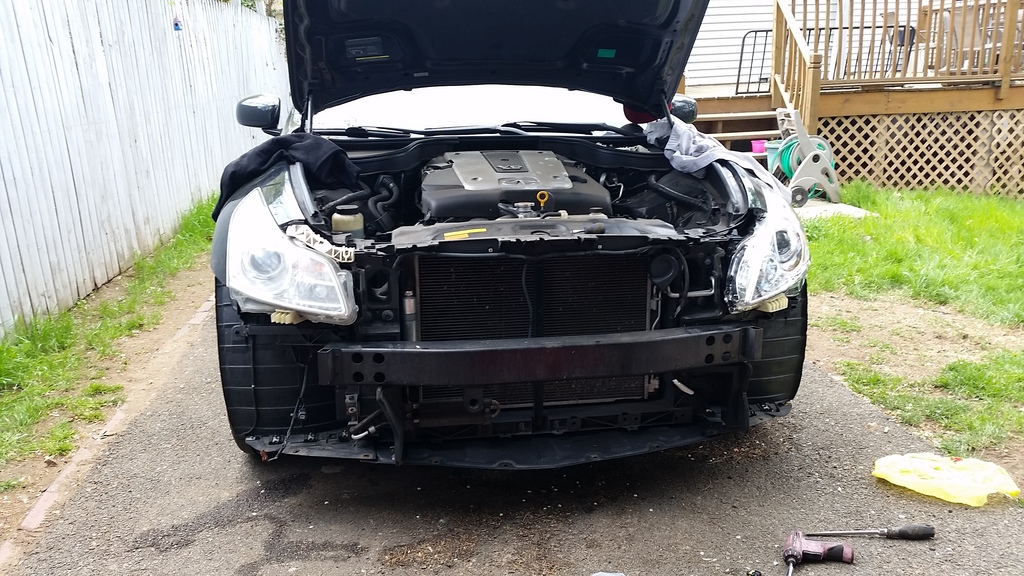

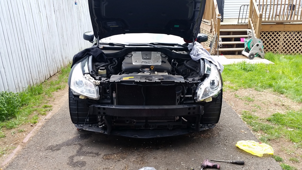

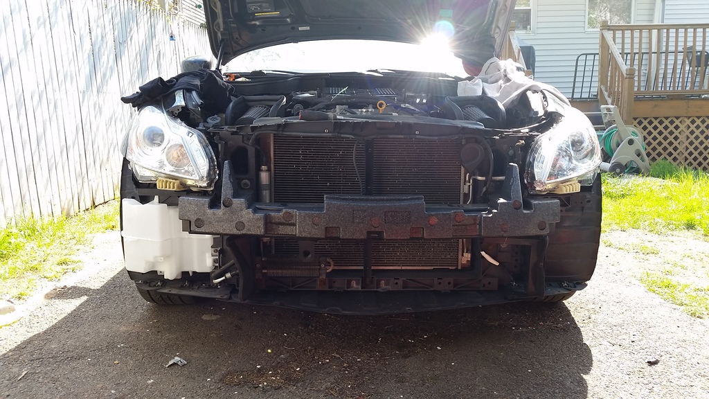

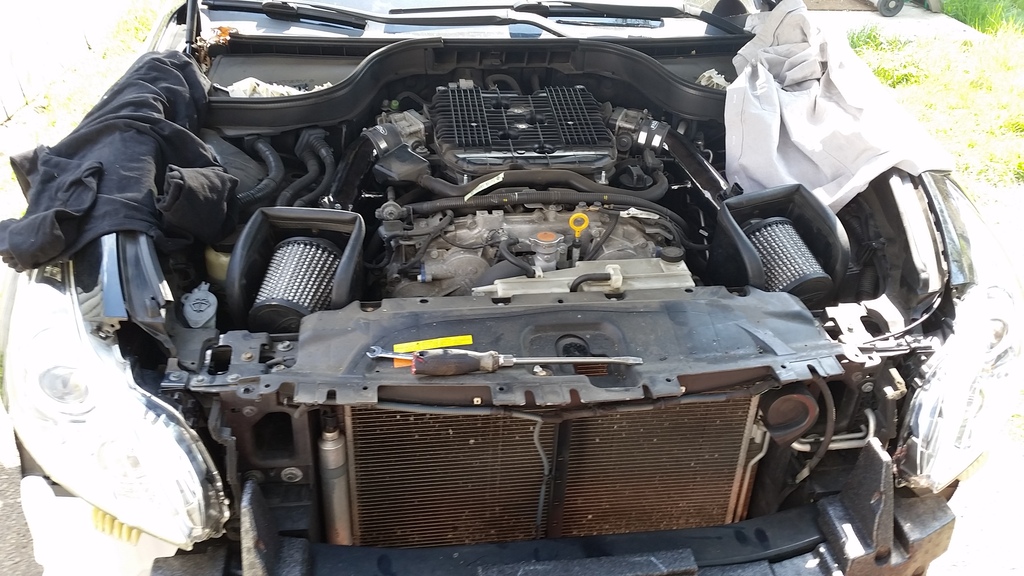

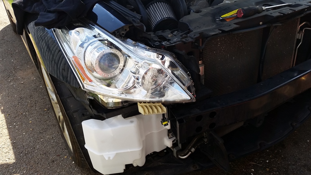

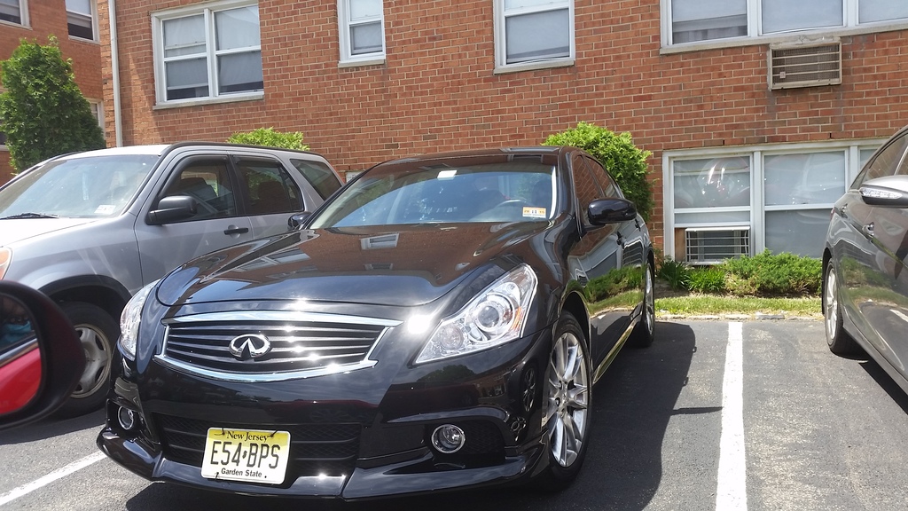

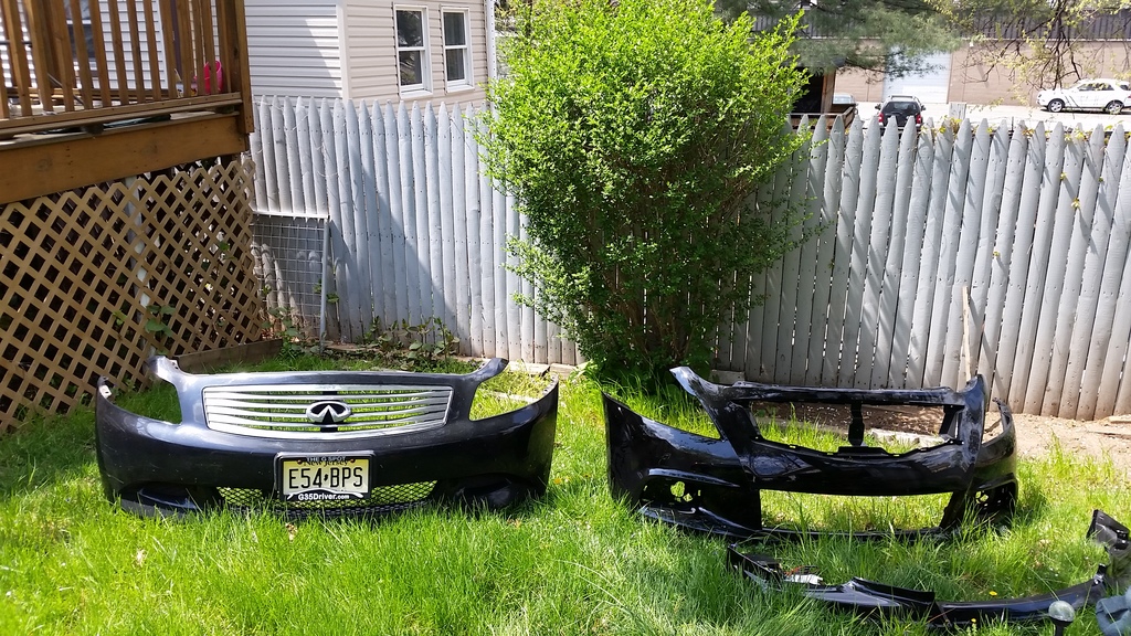

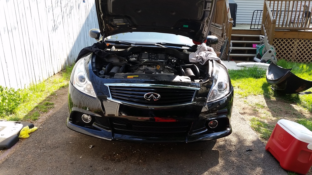

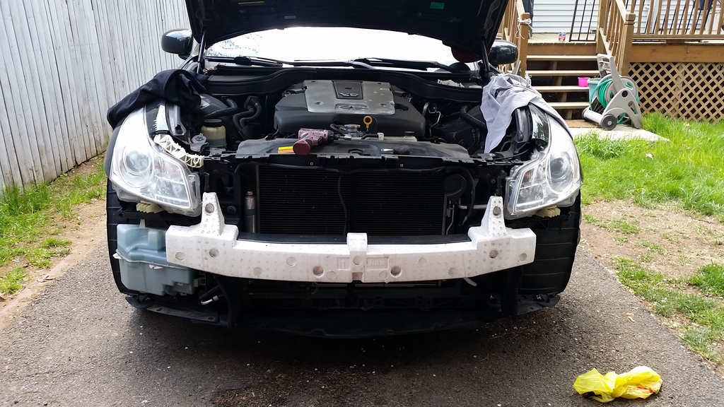

Just completed my front end conversion. 2008 g35xs to 2010 sport front. Took some time and finally got it done. A lot easier than i thought. I purchased everything piece by piece using myg37, g35driver , craigslist, ebay and dealer.

Old May 14, 2015 | 04:00 PM
jman09's Avatar
jman09
Joined: Feb 2015
Posts: 146
Likes: 16
From: chi-town
looks great! well done.

thanks appreciate it. started at 12pm finished at 4pm

i got the headlights, midnight grill, fogs with bezels for 900 shipped from this forum
fog light grills from Douglus Infiniti 90 bucks
everything else was from ebay...various infiniti dealers advertising on ebay with pretty aggressive prices. my total from ebay with free shipping was 840. i got the bumper, bumper reinforcement, oem style lip (only thing not from the dealer)
hid fogs, windshield washer reservoir, lower center grill, conversion fog light harness, and infiniti emblem. everything was a straight bolt on. OEM paint for the bumper and lip was 200
total 2,030

Looks really sweet, makes the car look so much meaner. Great job! I have a 2009 G37x sedan, and I wish I could do that. My paint and body is in fair shape so I would rather do that when I can fix all the dings and paint the whole car. Funny is I just received my oem lip for my bumper today. I test fit it and realized I 100% need to get my bumper cleaned up and repainted now. I saw how the bumper is so chipped and the paint is so faded when I put on the freshly painted lip. I will say that lip makes the front bumper look much better. I actually made my own grill, and cut out those 2 ugly black pieces on the bottom of my journey bumper. I can not wait to show pictures when it is done.

Here's a parts list.
Front Energy Absorber part number 62090-1NF1A
Fog light Bazel Left part number 62257-1MS2A
Fog light Bazel Right part number 62256-1MS2A
Windshield washer tank part number 28910-1NF0A
Front Sport Bumper part number 62022-1NH0H
Bumper grille Right part number 62256-1NH0A
Bumper grille Left part number 62257-1NH0A
Front Sport Lip part number K6010-1NH1A
Front Grille Emblem part number 62890-1NF1A
Front Lower Center Grille part number 62254-1NH1A
Center Grille Hook Cover part number 62256-1NH1A

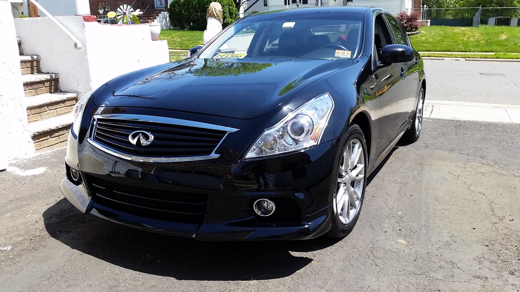

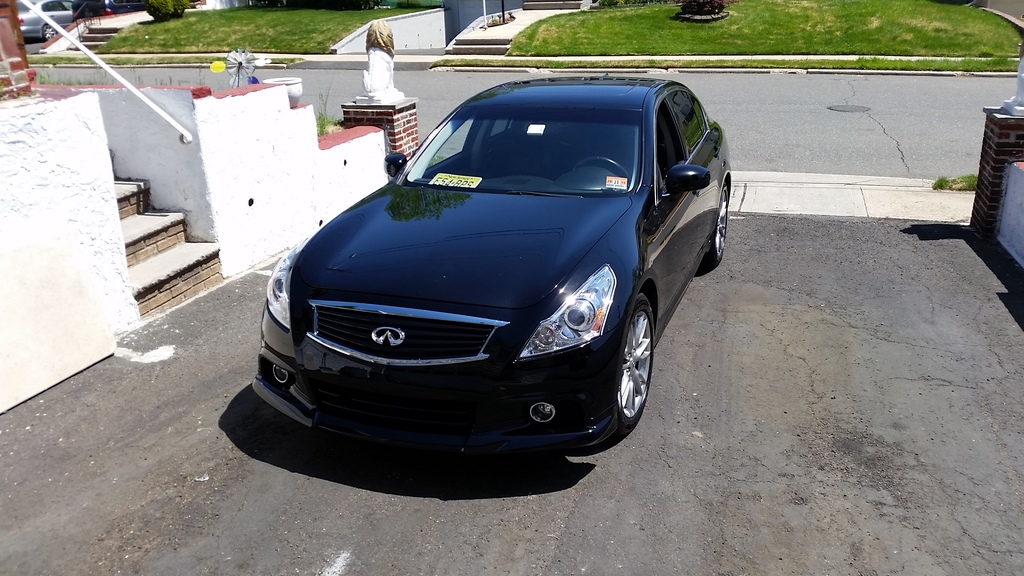

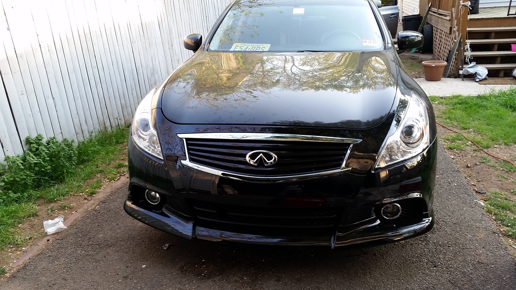

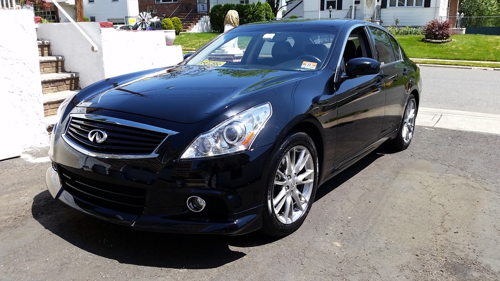

new pics

Old May 30, 2015 | 01:54 AM
2GoRNot2G's Avatar
2GoRNot2G
Joined: Dec 2008
Posts: 2,383
Likes: 416

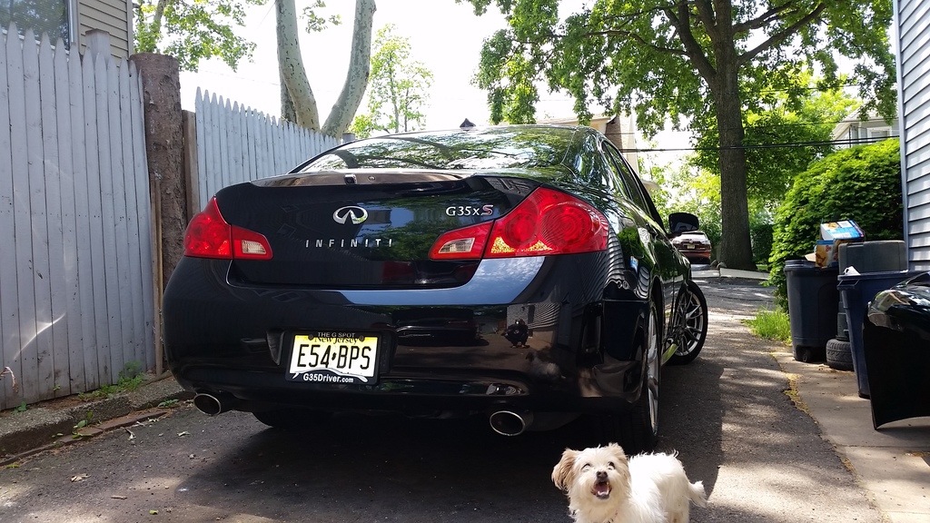

Look great. Even your dog seems to like it!
And no holes for the front license plate... just another plus.
I'm actually in the process of doing this same conversion and am curious if the front Infiniti emblem from your original grill fit the new G37 grill or not? Sounded like you needed a new emblem.

yea the dog photo bombed that shot! the old emblem will fit with no issues. i just went with a new one to keep everything new. any question with the swap feel free to ask.

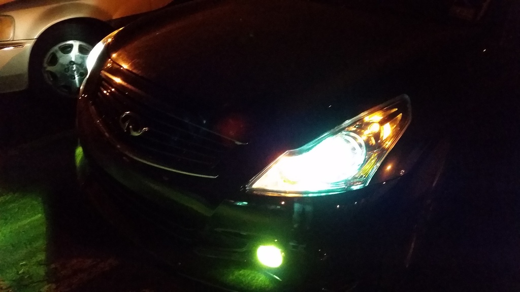

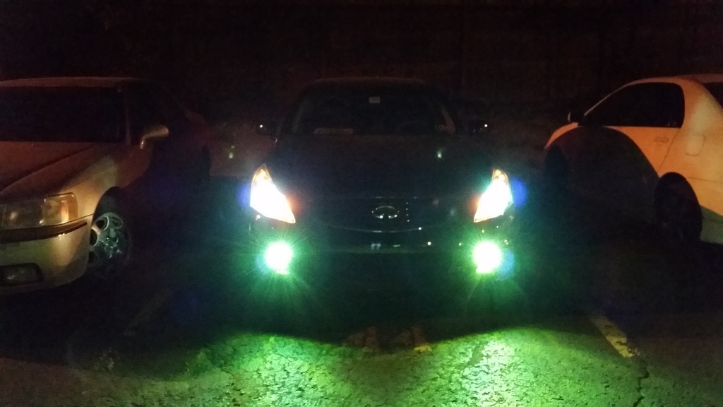

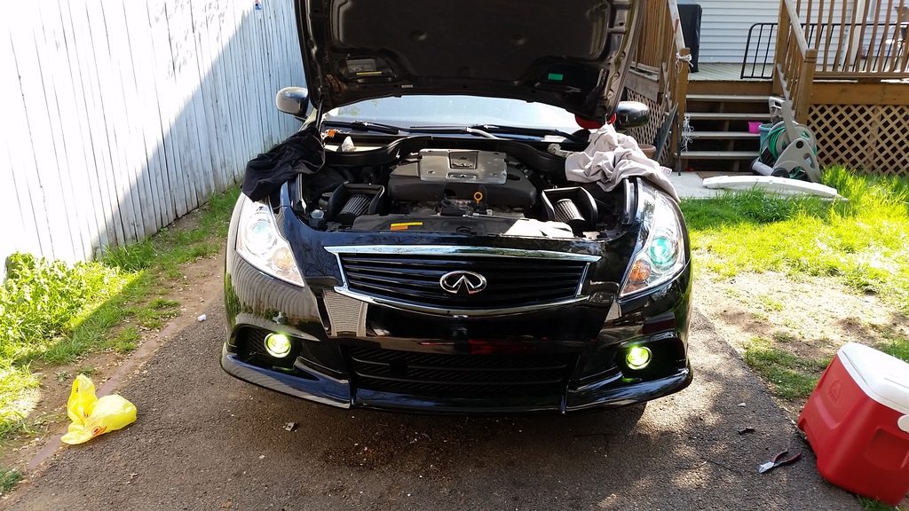

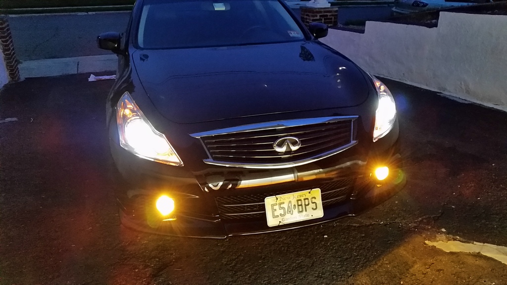

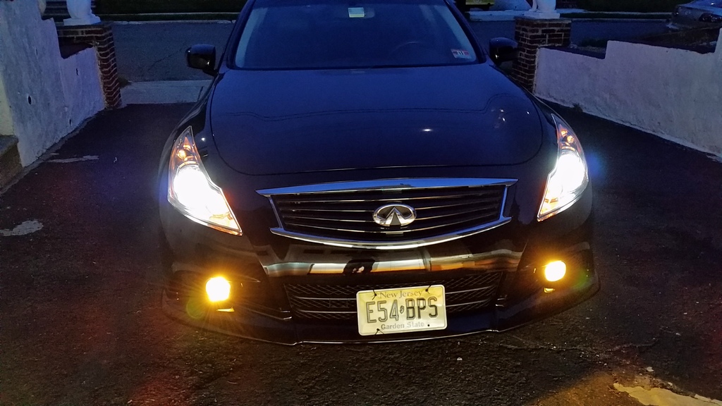

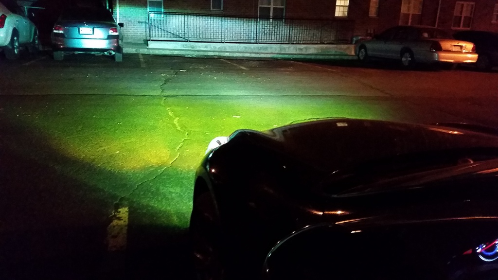

i was having some trouble with my hid replacement bulbs so i got rid of them. (ebay 6000k headlight bulbs and xentec hid 3000k fogs) horrible experience
i purchased morimoto 5500k headlight bulbs and nokya 2500k yellow bulbs. Perfect no issues and much better light out put.
NOW

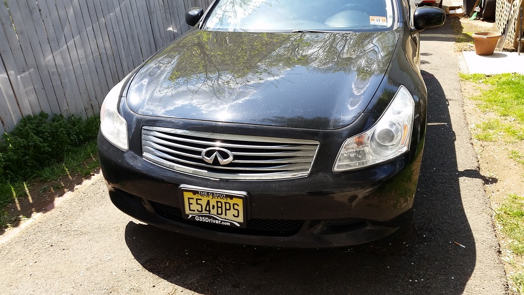

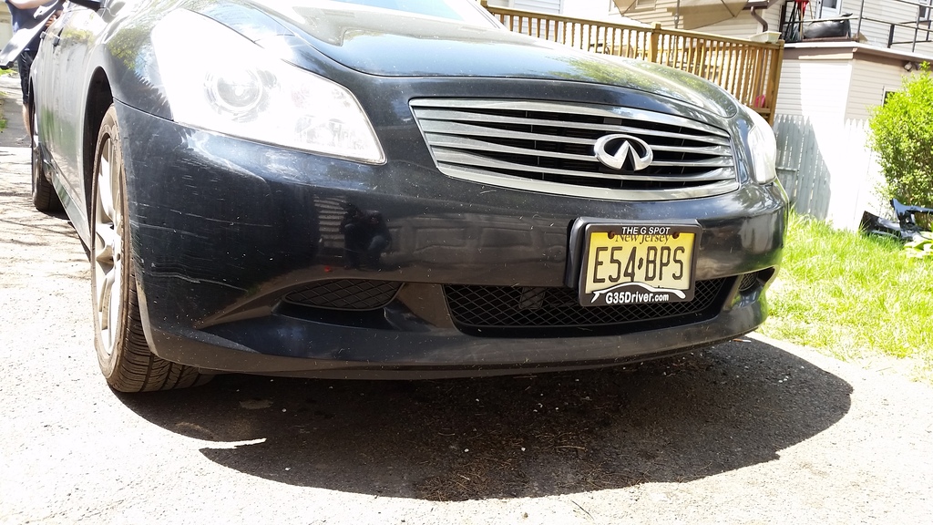

BEFORE

Oh, and thanks for mentioning you experience with the HID replacement bulbs. I've been looking at getting some Morimoto 5500 bulbs to use with my front end sway and now I think you've sold me on them. Can you tell us all where you got them?
