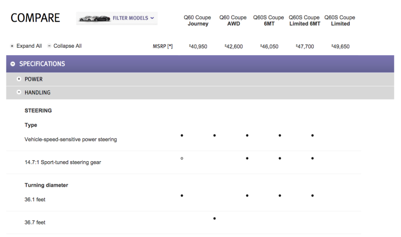

The xS coupe does not have the faster ratio steering. This was exclusively offered on RWD models. They mention it in the bullet points highlighting the car, but if you look at the technical specifications, it clearly shows the AWD was not outfitted with this feature in any trim.

I understand that and that is what I tried to discuss in my post. The Infiniti marketing section where you build the car states that it is an included feature, but the technical specification section written by (I'm assuming engineers) says it's not included, not even as an option (such as the sport package option) as this would be depicted by an open circle like it is for the RWD coupe.

I'm guessing it's going to be costly,difficult and most be told "might as well buy a RWD S" to add that sport tuned steering ratio on the X model?
