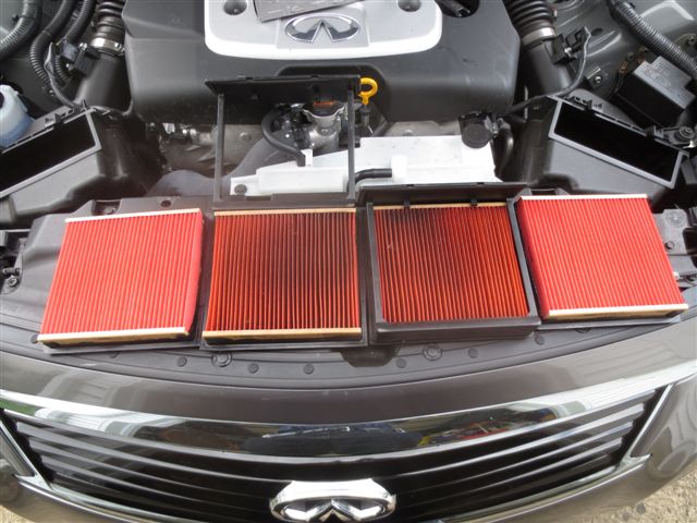

Originally Posted by JT2014
Air filter should be every 30K.....
Perhaps you live very high atop a mountain where the air is very clean?
Here in NJ where the air is not so clean my air filters get changed every 10k miles and get pretty dirty.
Cheaper to change air filters than to chance screwing up your MAF along with filthy throttle bodies
Telcoman
