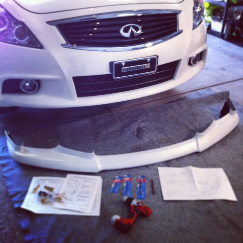

Hey all! Just wanted to know if anyone out there has done their own installation of the front chin spoiler on the sport sedan. I own a 2010.
Just got mine delivered from infiniti but there was no hardware in there. No screws or push pins or anything. I did notice the tape was already attached to the inside of the lip but that's all i got.
I'm wondering if the screws and bolts needed are the ones on the car already, or should i be calling infiniti to get the necessary hardware??

Yeah if I remember correctly it come with hardware....but it's an easy install...did it my self...I recommend not to install/make hole for the side brackets just incase you ever want to remove it...that way you don't ruin your stock bumper!
I used the bottom clips and the factory 3M on there and it's been on fine no problems!!!

I did my 08 sport install and it came with hardware. I opened the packaging at the dealer to verify it was all there. It came with clips and screws. I had to drill some holes under the bumper for the clips.

Like stated above, just use the 3M tape and the bottom clips. No drilling necessary. Took me probably 10 minutes to install.

There was no hardware if i remember...
The screws are already in the bumper, remove them and the bottom of the lip lines up with the same holes, replace screws.
The lip should just have some 3M tape on it.
It also suggests a rivet through the front? i skipped on that, didn't want a hole in my bumper incase i took it off

Has anyone installed this sexy lip lately? does anyone know for a fact if the 4 bottom clip holes need to be drilled or the holes are already there.
I have my lip and looking to do a dry fit but i haven't had time to wash my front bumper.
I'm planning to have the lip clear bra'd along with my front bumper so if possible i need to drill holes before the clear goes on.

Yes, you need to drill the holes for the 4 clips. I thought about clear bra-ing my freshly painted bumper and lip. For the price to have it done I could just have them both repainted...
