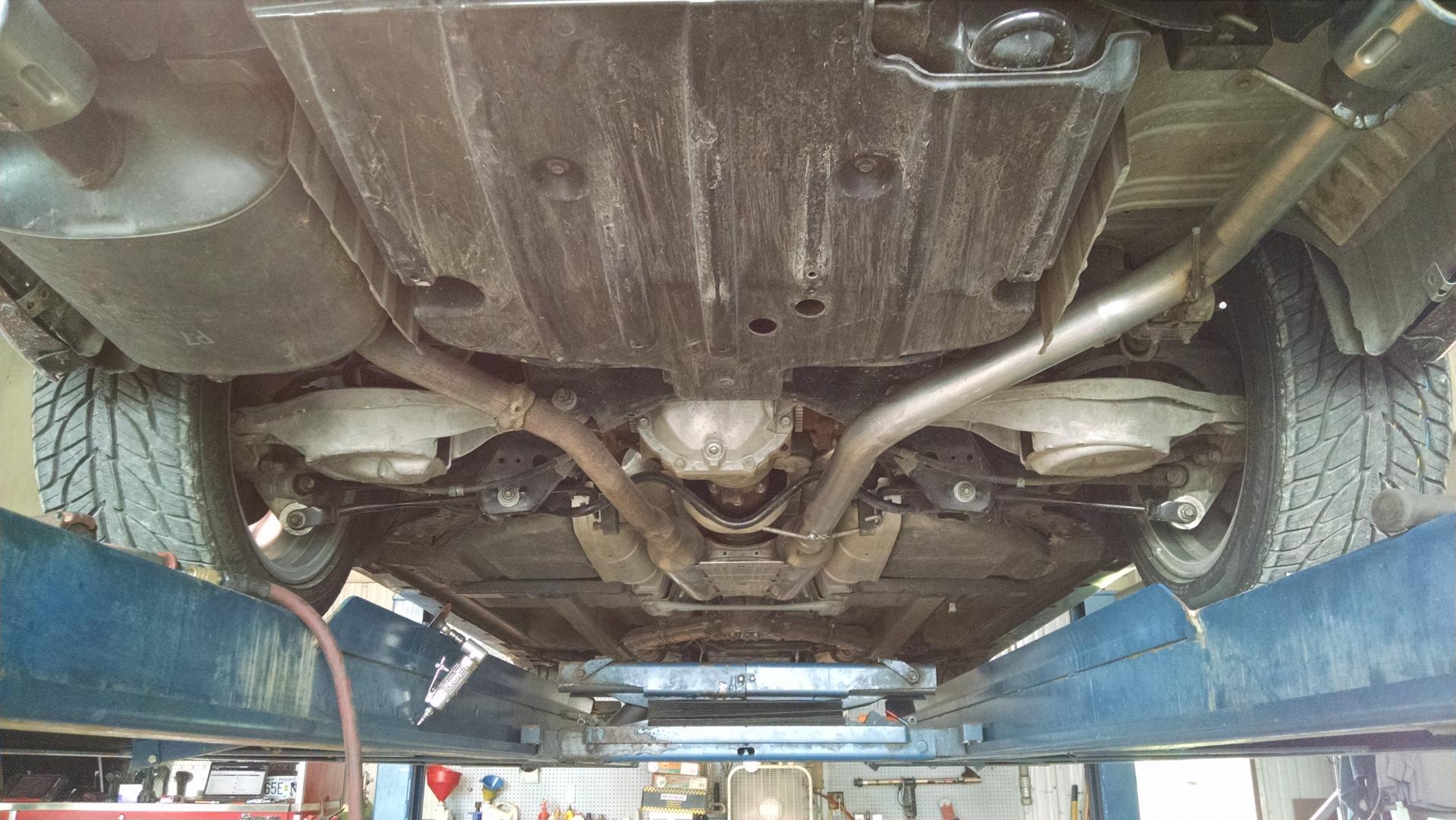

Well after screwston's thorough videos of his muffler delete I decided to jump the gun and do it is well, but slightly modified. I had the stock 1.75" piping cut off all the way to the resonator and replaced with 2.25" straight pipes with the factory tips welded back. I am very impressed with this setup as it has an aggressive tone at wot or when down shifting, but once up to cruising speed you only get a slight drone. I put a single 3" catback (resonator delete) with a magnaflow on my wife's '12 ecoboost f150 and I actually think it is slightly louder than my car at cruising speed.
I know the muffler delete/straight pipe setup isn't everyone's cup of tea, but I like it. Especially for $150 compared to $400 for a decent axleback.

Here is a picture for comparison..
Attached Thumbnails my version of a muffler delete-img_20140804_162731500.jpg

I thought I would give a quick update after my first week with this setup. I haven't got around to finding a gopro to borrow for a video, but I have noticed a bump in my gas mileage. My normal commute to work is around 25 miles each way with roughly 20 being on the interstate. I am somewhat of a leadfoot and usually set my cruise around 79 (70 speed limit) and had been getting around 21.5 mpg average give or take a half mile or so. Well Friday night I took the family to the movies, ninja turtles 3d , and on the way home with the cruise set around 79 I noticed my mpg bump up to around 23.5 on the same interstate, but different direction. So this morning, with an almost full tank, I was running a little early so I decided to set my cruise around 75. When I pulled into work my gauge was showing 26.1!
I know it's still early, but I'd be happy with a 2-3 mpg bump on average.
